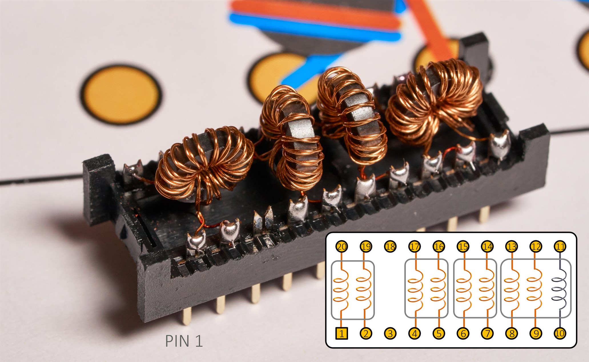

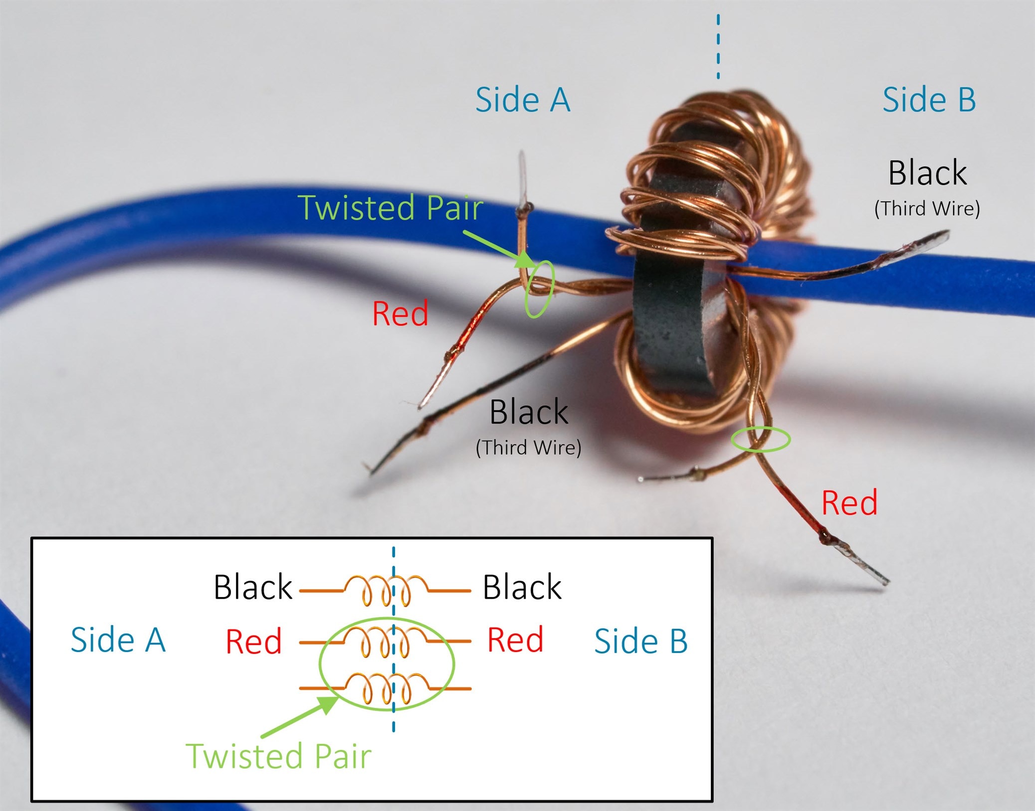

A balun was created by twisting two pieces of enameled copper wire and threading it through a toroid core multiple times. I created four such baluns, but for the fourth one, after I had twisted the wire pair, I then wrapped a third wire around it. It's beyond the scope of this blog post to discuss why such windings are required (because that's a rabbit hole), but if there's interest I'll write it up. Anyway, here is a photo of the fourth balun (these ferrite cores are small, so the blue solid-core wire in the photo is being used to prop it up; this support method also came in handy when I was heating the wire ends to remove the enamel). I used a multimeter set to continuity test mode to figure out which wire was which and then colored the end of the winding using a permanent marker pen.
Next, I took an IDC DIP header used for ribbon cables and pulled off the plastic cover. I soldered the transformers onto it as shown here:
You can actually buy forked (and non-forked) DIP modules intended for soldering components, but they are more expensive, getting hard-to-find from distributors these days, and I didn't have any. The IDC DIP header worked fine. Anyway, my Balun Prototyping Module was complete!

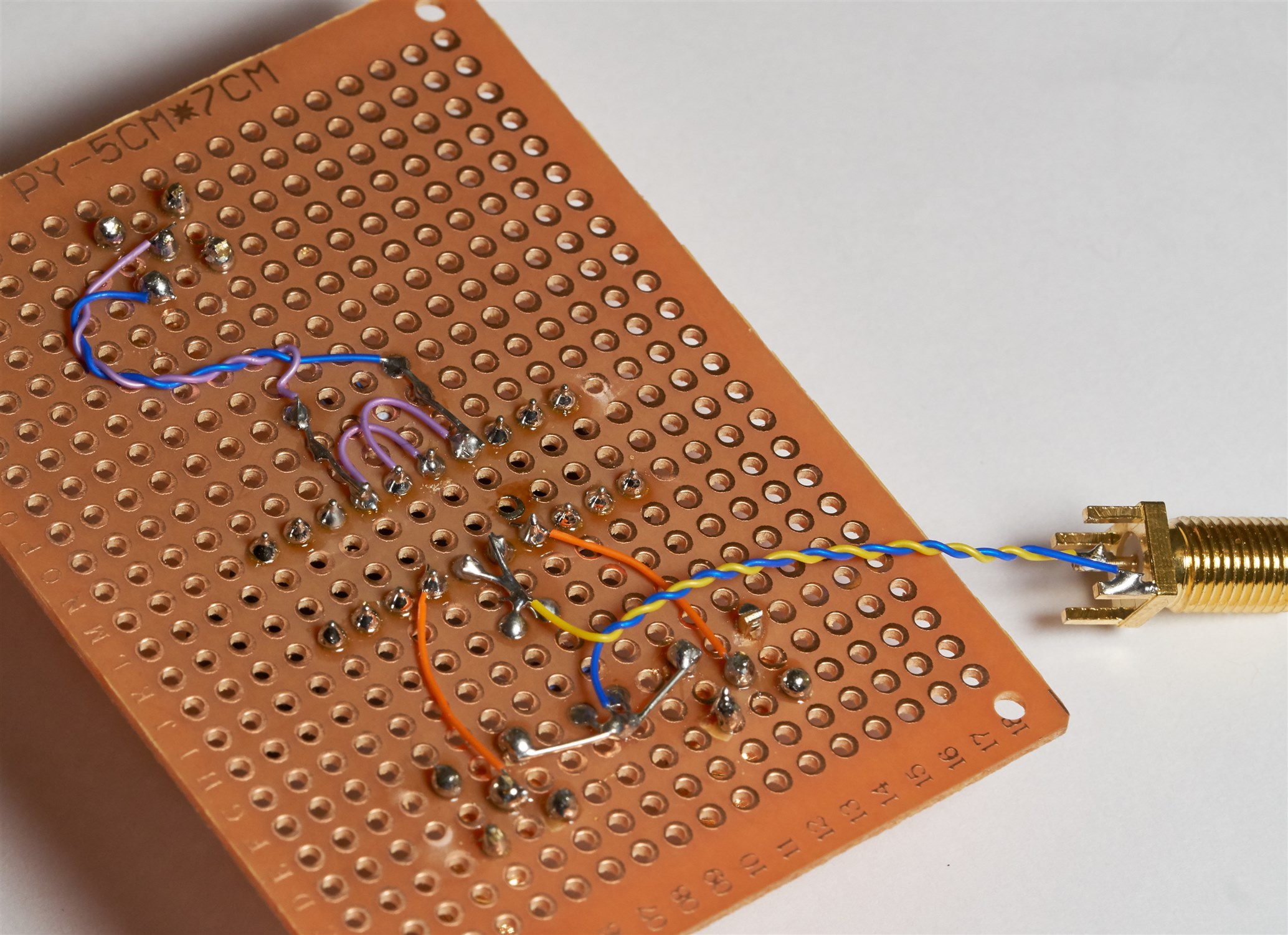

For this circuit, I just used the two center baluns in the module. Of course, the module can be unplugged if I want to try to swap out the baluns with a new design.
Here is the underside; one SMA connector is hanging off the board because I ran out of space on the small protoboard, I wanted to space the connectors out.

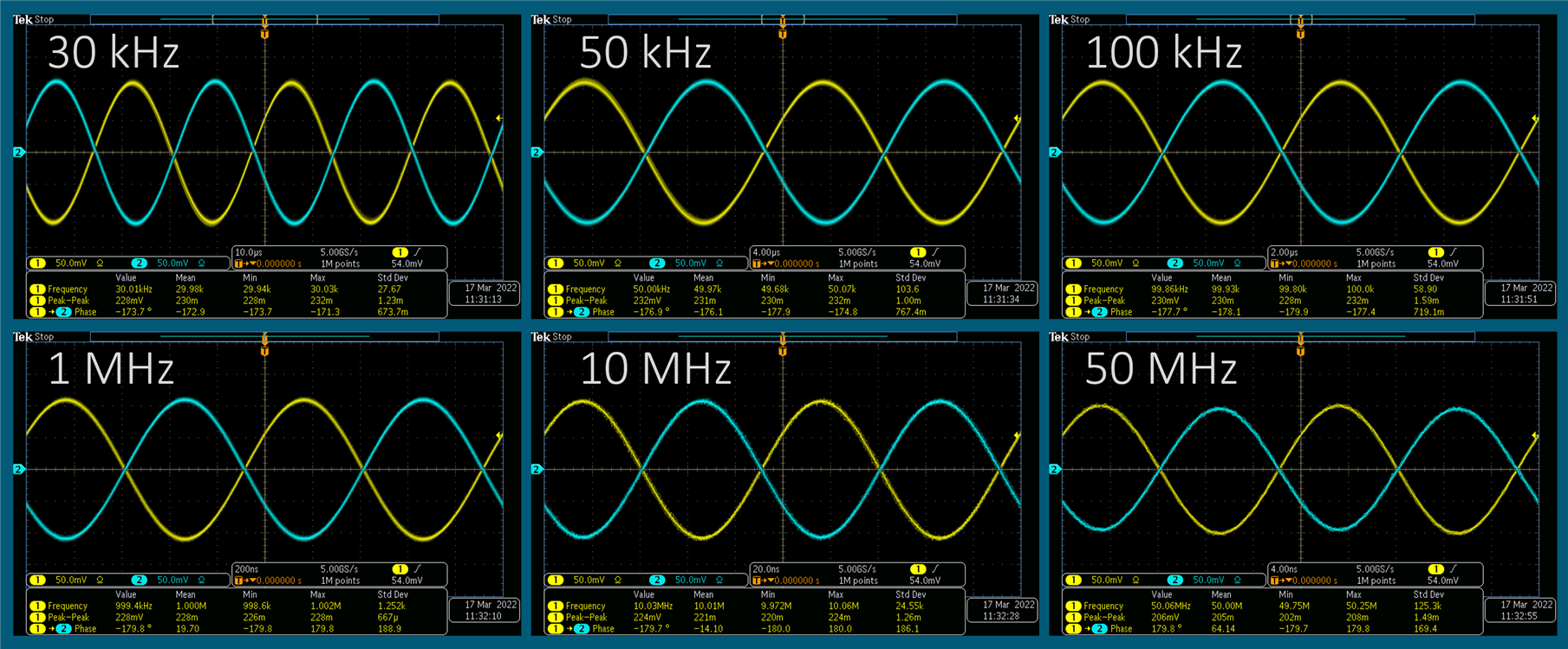

Here is the result; as can be seen, my implementation only works well from 1 MHz upward. I only tested to 50 MHz because that was the limit of the signal generator I was using (I could move to a different signal generator but this was just a first test).

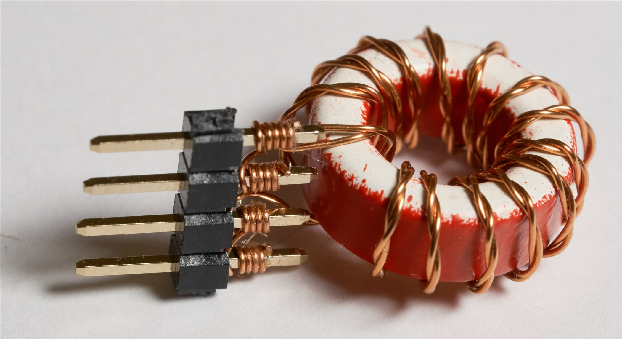

If you wish to replicate this, the enameled wire was of 0.15 mm diameter, and two lengths of 30 cm were wound with about 10-12 twists per inch (i.e. one twist per 2-2.5mm), it's not critical, but try not to exceed that, and try to keep the wires touching throughout the twists, i.e. no gaps. The ferrite cores were Fair-Rite 5943000101  and I wound 18 turns, cut off the remainder, leaving 6 mm of wire, and then used a soldering iron and a blob of solder to burn off 2-3 mm of enamel off the ends. For the fourth ferrite, as mentioned, a third winding was added. That third wire was of the same length, wound around the twisted pair, but not with as much care, it just needs to ideally follow the same path. I didn't have 50-ohm through-hole resistors, so I used two 100 ohm resistors in parallel.

    shabaz over 4 years ago
    This fixed it : )
    This is 35 turns of the red and green wire from that pack of 4 bobbins, wound on a different core. It is Fair-Rite 5977000201
    Using two of these in the same circuit as before, now I get these results; basically, it is now usable down to 50 kHz or so (with a few degrees phase error as can be seen in the mean phase automated measurement in the 'scope screenshot below; by about 100 kHz the error is down to a degree), but still functions well to 50 MHz and likely higher (I didn't test higher).
