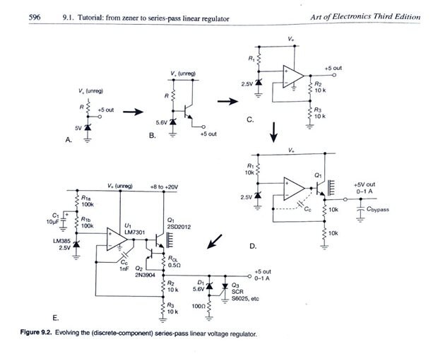

Designing a Discrete Component Linear Regulator
Chapter 9 of The Art of Electronics Third Edition by Horowitz and Hill is about Voltage Regulation and Power Conversion.  Horowitz and Hill is not light reading, at least for me.  But the tutorial on designing a linear regulator is a great example of the clear and concise way they convey information.  Everything is summed up in the figure below:
Credit:  Art of Electronics (Third Edition) by Horowitz and Hill
The short tutorial that accompanies this figure describes how to go from simple Zener regulation to amplified voltage with feedback loop stability, overcurrent protection, and overvoltage crowbar protection in a few short pages.
This voltage regulator design is not unique to Horowitz and Hill of course and can be found in other places.  And it should be recognized that as Horowitz and Hill say it is "seldom necessary to assemble these components from scratch - they are available as complete integrated circuits."  But going through the design is instructive and in this post a minimal breadboard version will be developed and investigated.

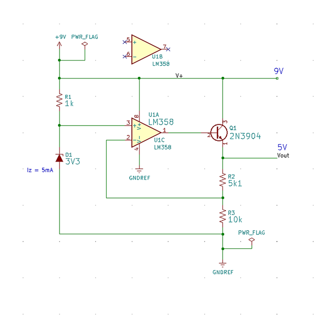

The following schematic derived from Horowitz and Hill was developed with further annotations from the calculations which follow:
credit: me
Calculations: Zener Voltage Reference
The design deviates from Horowitz and Hill in that a Zener diode will be used as a voltage reference by the op-amp to control the output of the transistor instead of a LM385 2.5V adjustable voltage reference as shown in their Figure 9.2E.  This will introduce problems later on but this is how we learn.  The Zener Diode, D1 is a 3V3 +/-5% 500mW ON Semiconductor BZX79C3V3BZX79C3V3.
credit: ON Semiconductor BZX79C2V4BZX79C2V4 - BZX79C56 Datasheet
The Zener voltage must be less than the output voltage or the design will not work.  At 3V3 with a desired 5V output and 9V supply this one should be OK.  If the 5% variance between min and max is not acceptable then it can be adjusted by changing out resistors in the voltage divider R2, R3 or by using a trimmer.  The value of Iz is important because it is the current necessary to make sure the diode is operating past the knee into the region where Zener voltage is fairly stable.  This will be done with resistor R1.
The nominal input voltage is 9V and the desired current is around 5 mA.  For our purposes negligible current flows to the non-inverting input of the op-amp so resistor R1 is sized with Ohm's Law as follows:
R1 = (V+ - Vz) / Iz = (9 - 3.3) / 0.005 = 1,140; use 1k
The maximum current through the Zener is 500 mW / 3.1 V = 150 mA so no worries there.  Likewise the 1/8 W resistor is adequately sized.  Among the bothersome things is the power wasted in the Zener, the range of Zener voltages, and as shall be shown the Zener impedance, Zz.

Finally we are to the interesting part.  The op-amp is configured so as to drive the pass transistor inside the negative feedback loop.  Op-amp golden rule number 1) when configured for negative feedback is:  The op-amp does whatever it can through the output to make the input difference between V+ and V- zero.
The design proceeds as follows:
  • The op-amp is supplied by a source, in this case 9V, which gives adequate headroom around the rails of the op-amp and is also sufficient for the transistor.
  • The non-inverting pin V+ on the op-amp is set at 3V3 by the Zener diode voltage reference.
  • By op-amp golden rule number 1) the op-amp will supply an output Vout to the transistor so that the inverting pin V- will also be 3V3
  • The voltage divider consisting of R2 and R3 is set up such that the output, Vout will be 5V when the voltage divider delivers 3V3 to the inverting pin V-.
The voltage divider doesn't have to be all that stiff because op-amp golden rule number 2) states that the current flow into the inputs of an op-amp is near zero.  For the voltage divider:
     V- = Vout * R3 / (R2 + R3)
     R2 = (Vout * R3 / V-) - R3
     arbitrarily select 10k for R3
     R2 = (5.0 * 1E04 / 3.3) - 1E04
     R2 = 5,152 ohms;  use 5k1

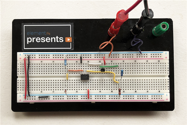

The circuit was built on a breadboard from the schematic.
credit: me
For the demonstration a Tenma 72-268572-2685 DC Power Supply was used to power the breadboard.  Voltage measurements were taken with a Tenma 72-102072-1020.
The video that follows is longer than I usually post at 17 minutes and is in the form of an educational presentation.  It is the type of thing I like to watch when having trouble falling asleep for a nap.  To skip the theory go to about 7:45 and to skip the experimental setup go to 10:45 for the demonstration and results.  If anyone actually watches this please comment below.
credit: mostly me

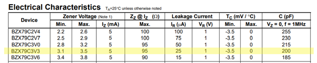

In the video a change of 380 mV in the Zener voltage is observed if the input voltage, V+ is increased from 9V to 19V.  This also results in an increase from 4.87V to 5.44V in the voltage output Vout of the power supply.  To explain this we return to the Zener diode datasheet.
The datasheet shows the maximum value of the Zener impedance, Zz to be 95 ohms but does not state the frequency at which it was measured.  Using Ohm's Law we calculate the Zener currents and then the maximum Zener voltage change to be:
     I9V = (9 - 3.3) / 1000 = 0.0057 A
     I19V = (19 - 3.3) / 1000 = 0.0157 A
     delta V = (0.0157 - 0.0057) * 95 = 0.95 V
The observed voltage change of 380 mV is less than the calculated maximum of 950 mV.  From a first approximation this seems reasonable for the part but may be unacceptable for a design if it must handle wide swings in input voltages.  In that case a different voltage reference such as the LM385 used by Horowitz and Hill would be appropriate or perhaps a 6mA current source.

    Thanks to all for those helpful clarifications and hints.  My once beautifully laid out breadboard is now a mess of twisted wires and probes.  I've added a button to change the load which sometimes shows me what bounce looks like but without a decent electronic load I am improvising.
    A 47 uF electrolytic and 1 uF ceramic capacitor were added to the input.  I get the following where the time scale is 50 us / major time division.  Yellow is breadboard output and green is input.
    It most definitely improved the input behavior.  I wondered what a capacitor on the breadboard output would do so below it is shown with a 1 uF added on the output.  Major time divisions are 10 us.
    Check it out - oscillations...  Here it is at 50 us / major time division.
    The oscillation lasts for less than 100 ms and it can be seen on the input as well here.  What happens if a Miller feedback capacitor is added around the inverting gain stage as shown in the Horowitz and Hill figure at the top of this post?  I used 1 nF.
    Oscillation gone!  I could have saved myself a lot of time if I just built the finished Horowitz and Hill design to begin with but I wouldn't have learned as much image
    The breadboard is misbehaving at times.  It really should be done on protoboard.
