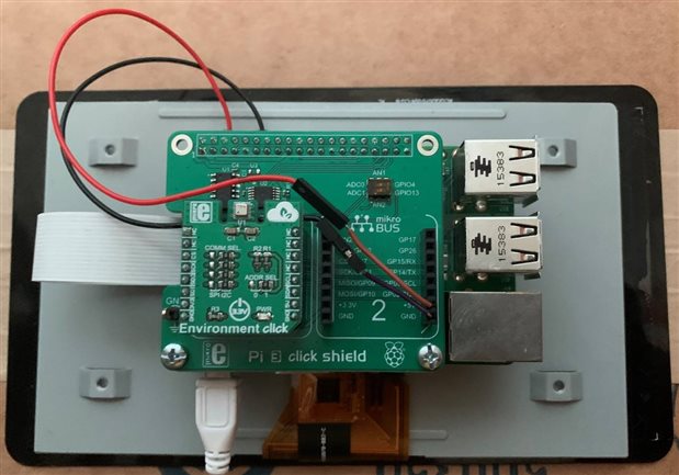

This post is for Project14 September 2020 theme Control Systems. My project is a simple on/off control system. It is a supplemental home air quality controller to my ecobee thermostat system. The ecobee thermostat has control to my air conditioner, furnace and ventilation fans. It does a good to control my home temperature. However, home air quality is also very important to our health. Especially in this COVID-19 era, we work and live at home all the time. Adding air quality monitoring and control to my ecobee system becomes important.

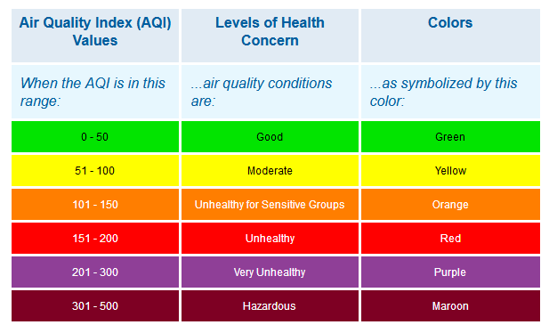

To define the air quality, we use the following classification table. When the AQI value is greater than 100, we will turn on the fan to bring fresh air to the house. To save energy, when the AQI value is lower than 50, we will turn off the fan.
Image resource: https://www.airnow.gov/sites/default/files/2018-04/aqi_brochure_02_14_0.pdf

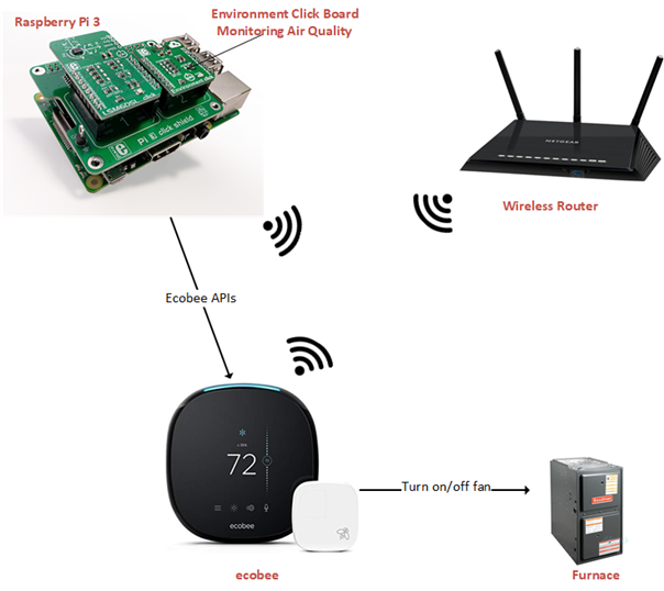

The system consists of the following components: Raspberry Pi 3, ecobee thermostat, network equipment (such as wireless router) and furnace. The following diagram illustrates the interactions among all components.
System Diagram
BOM
1. Raspberry Pi 3 Model B and T5454DV Power Supply
2. Raspberry Pi 7" Touchscreen Display (optional)
3. Pi 3 Click Shield
4. Environment click board
5. Keyboard & Mouse
6. 8GB micro SD card
7. ecobee Thermostat
The wires in the above assembly photo are power supply to the LCD touch screen.
How It Works
As depicted in the above system diagram, an environment click board (i.e., Bosch BME680 sensor on board) is plugged into the Raspberry Pi 3 through a Pi 3 click shield board. The sensor is sampling VOC (Volatile Organic compounds gases) raw values which is processed by Bosch Sensortec Environmental Cluster (BSEC) software module and eventually transformed into air quality index numbers. When the index number is greater or lower than high/low thresholds, the Pi3 will communicate to the ecobee system (https://api.ecobee.com) using ecobee API through the my home network system. If the indoor air quality is deteriorated, the RPi3 can command ecobee to turn on the ventilation system so fresh air can be brought into house to improve air quality.
To summarize, the system involves the following activities:
1. Sensor acquires raw data (temperature, pressure, humidity and gas VOC);
2. BSEC software (in C) processes data and outputs AQI number;
3. Application software (in Python) communicates with ecobee through APIs;
4. ecobee turns on/off fan as needed.
