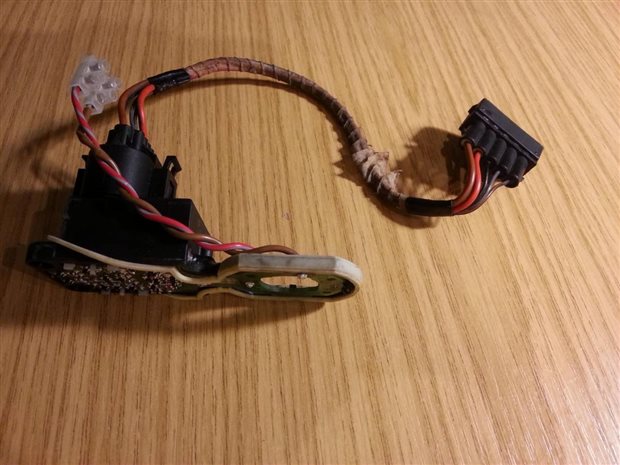

Some time ago, I replaced the electric window mechanism in the driver's door of my car.  The new part was of a different design to the old, and had no controller - just a 2-wire motor. Universal electric window controllers that do anything beyond simple switching, such as stall detection etc., don't seem to exist so in the end I stripped the controller out of the old mechanism (pictured below) and connected it to the new one.
This sort of worked, although because the new motor was different the controller was not happy.  The window would only move in 2" increments before stopping, presumably because the controller believed it was stalling. Additionally, pressing and holding the switch with the window open or closed to teach the controller where the window limits were would result in a window that wouldn't open at all. However, being short of time I decided that this would be "good enough for now" and made a note to make a replacement controller in the future.

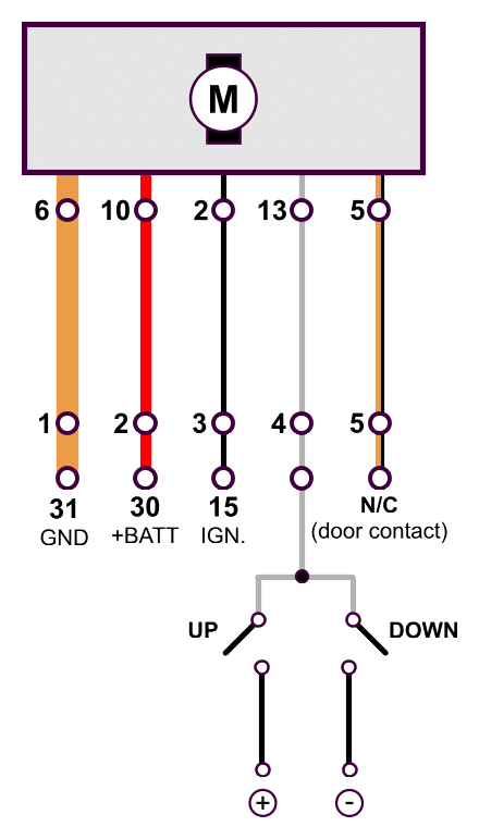

The window controller connects to my car's wiring harness through a five-pin connector inside the door. Thanks to the people over at the Briskoda.net forums, I have a handy diagram of the pinout for this connector in my car:
GND and +BATT supply +12V power to the controller, and are always connected.  IGN is switched to +12V when the car's ignition is on, and is 0V otherwise. Finally, the connection to the window switch is pulled to +12V when the switch is moved to  raise, 0V when the switch is moved to lower, and left unconnected otherwise.

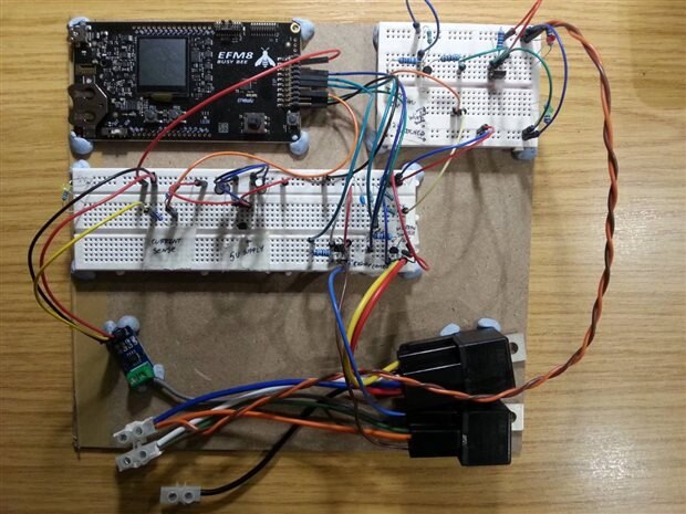

For flexibility, and to compensate for my limited skill in electronics, the brains of the operation will be a microcontroller. Having previously read about the EFM8 series of 8-bit microcontrollers from Silicon Labs in a Hackaday article, I decided that this project would be a good opportunity to try them out. For the prototyping presented here I used an EFM8BB2 "Busy Bee" development board that I had previously bought but not yet got around to using.

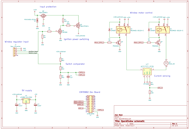

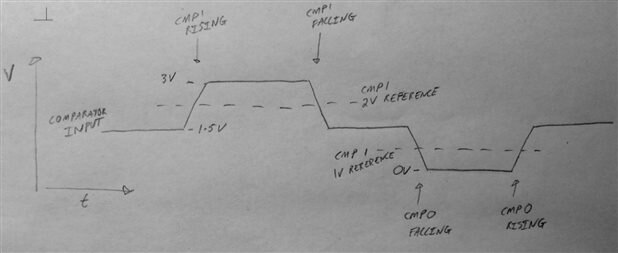

The window switch is a three-state input (12V, floating, 0V), so I needed to drop the voltage down logic levels and work out how to detect the floating state. I decided that the easiest way would be to use a couple of comparators (built into the EFM8) along with a voltage divider.  When the switch is floating, the voltage divider network pulls the comparator input to ~1.5V.  On switching to 0V the comparator input is pulled to 0V and on switching to 12V it is pulled up to 3V.  By using two comparators with rising and falling edge detection, one with a reference voltage of 1V and the other 2V, the EFM8 can successfully detect all of the switch states and transitions between them. I've included a rough diagram below to help visualise how this works.
To monitor the motor current, I selected a Hall-effect current sensor (Allegro ACS712). Using a sense resistor with amplifier for the task would have been difficult, as the motor current pretty large when stalled (>13A) and so any sense resistor would potentially have dissipated quite a lot of power. From what I read, I also got the impression that one had to be quite careful with component layout when connecting a measurement amplifier to the sense resistor so I decided to steer clear of this entirely.
I ended up purchasing the current sensing chip on its own breakout PCB, as this was significantly cheaper than picking up the chip by itself - not to mention more convenient as it's a surface mount chip. Most Hall-effect current-sense chips, including the one I chose, seem to run on a 5V supply and provide a 0-5V output proportional to the detected current.  I then converted this down to logic level ready for input to the EFM8's ADC using another voltage divider.  According to the datasheet, the minimum resistive load of the current sensor output was 4.7KOhm, and initially I assumed that this would refer to the total resistance of the voltage divider. When running the ADC, I found that this was not the case and had to switch the divider resistors out for larger values to avoid pulling down the current sense output.
For the ignition switching, I used a MOSFET high-side switch to control the 12V supply for the electronics from the ignition input.  Unfortunately, I found the 2N7000 FETs very easy to damage even when wearing an ESD wristband - luckily I had plenty spare. From the switched 12V supply I ran a small LDO regulator to supply 5V for the current sensor. When I make the final version, this 5V supply will also power the EFM8. Currently the dev board normally runs off of USB power, although it can be connected to the 5V supply instead if debug output isn't required.
Prior to the ignition switching circuit, I included in the design a TVS diode and N FET for transient spike and reverse polarity protection just in case, as the car electrical system can be a harsh environment. Finally, for the motor control I used a couple of SPDT automotive relays, switched by the EFM8 through a couple of small NPN transistors with flyback diodes across the coils. The complete circuit diagram for the prototype is shown below.
Here is the complete prototype assembled on the desk:

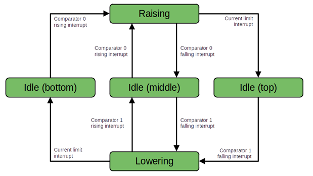

After getting all of the peripherals tested and working individually, I needed to tie everything together and make the control logic. As is often the case for embedded systems, I decided to use a simple state machine for this as diagrammed below.
Here I hit my second major pitfall. I initially wrote a fancy state-machine for my system, involving judicious use of structs and function pointers.  When I came to try it out, I found that the absence of a certain print statement (even if completely empty) would cause the chip to constantly reset.  After much debugging and head-scratching, I read online that function pointers on the 8051 are apparently something to be handled sparingly and with care.  Eventually, having still been unable to fix it I decided to lose the day's work and write a simpler implementation, rather than risk the flakiness of the more complex one. The simple state machine does not have a queue for events, relying on events being quite infrequent in this system.

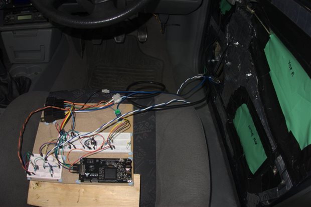

The final stage in the project was to test the prototype in the car, to work out some empirical current limits for the window motor. As is often the case with automotive electronics, the connector for the window controller on the wiring harness is a strange waterproof connector that is hard to get hold of. For the final product I should be able to pick one up from China, but the lead times are very long.  Thus, for the purposes of testing the prototype for this competition, I jury-rigged an interface out of some sections of old packing staples. Below is a photo of the final prototype balanced on a seat in the car, ready for testing.
Results:
After setting some appropriate current limits, the prototype controller worked quite well!  One change I made after initial testing was to make the state machine more tolerant of unexpected events, as I had initially set it to enter a permanent error state if any occurred. Such events could occur during power-on, or if we are very unlucky and two events happened to occur in very close succession due to my simple control logic. The system now reports the error, then returns to idle instead of locking up.

    apreed over 5 years ago in reply to mp2100
    Thanks!  When the switch is in neutral the input to the controller isn't connected to anything.  The resistor network for the comparator includes a pull-up though, so the input to the comparator is held at around 1.5V when this is the case.

    mp2100 over 5 years ago
    nIce project.  Having paid full price plus labor for a mechanic to replace a window controller, it’s good learn what you have worked out.  One question, did you measure typical ‘floating’ voltages when the window was not moving?  If it’s floating, it seems the voltage could find its way to 0 volts by acccident, and that would open the window.
