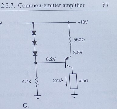

This is one of the circuits from The Art of Electronics. In the 3rd edition, it's circuit 2.23 C.
If you are interested in another one of their practical examples: The Blinker in a Side-View Mirror - What's Inside?.
The Circuit
This is a Current Source. A circuit that sources current into a load.
In essence, it's a common-emitter design: the emitter is common to both input and output.
image source: photo of my paper copy of The Art of Electronics, 3rd edition

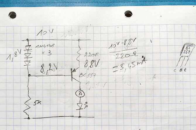

Set the Constant Emitter Voltage pt. 1
Our "current-set" resistor is in the emitter circuit.
So if we want to have a constant current through this resistor (and hence through the emitter), we need to have the emitter voltage at a known fixed point (Ohm's law).
The way to do that here, is by setting the base voltage.
In a PNP transistor that's conducting (and it should conduct - we want to run a current through it), the base voltage is 0.6 V below the emitter voltage. The voltage over the diode that is the basis-emitter junction.
If we bring the base to a known voltage, we know that the emiter will be 0.6 V higher. Also a known voltage.
Bias the Base

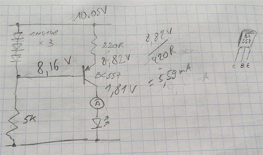

In this case, we use a voltage reference made out of 3 diodes. Normal 1n4148 ones.
Within a broad current range, the forward voltage drop over 1 diode is 0.6 V. 3 diodes will push the base 1.8 V lower than the supply.
Our supply is 10 V. The base will be at 10 V - 1.8 V = 8.2 V.
The 5K resistor will take care that there's a decent current flowing through the diodes. In our case, that current will be 8.2 V / 5 K = 1.64 mA.
Set the Constant Emitter Voltage pt. 2
We know that the base is at 8.2 V. And that the emitter will be one diode drop above that.
Then, the emitter voltage must be 8.8 V.
Calculate the Emitter Current
The 220 Ohm emitter resistor is between the supply and the emitter.
Supply is at 10 V. Emitter is at 8.8 V. So there's a voltage drop of 1.2 V over the resistor.
Ohm's low then dictates that there is 1.2 V / 220Ohm = 5.45 mA running through the resistor.
The resistor is in series with the emitter, so the emitter current is 5.45 mA too.
Calculate the Collector Current
The easiest calculation ever. In a common-emitter circuit, the collector current is equal to the emitter current.
The emitter current is 5.45 mA. That means that the collector current is 5.45 mA.

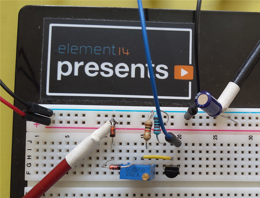

Reality

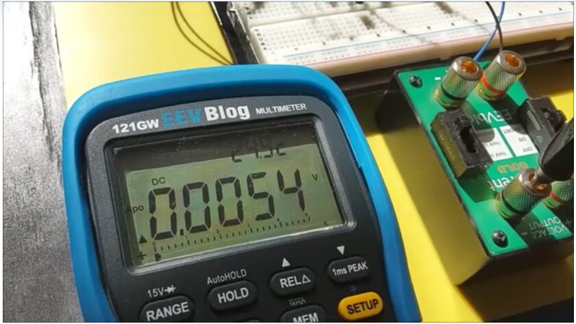

I built this circuit and did the measurements. The results meet the expectations.
All voltages drawn on the circuit are relative to ground.
In theory, the circuit should source 5.45 mA. In reality I measured 5.4 - 5.5 mA.
