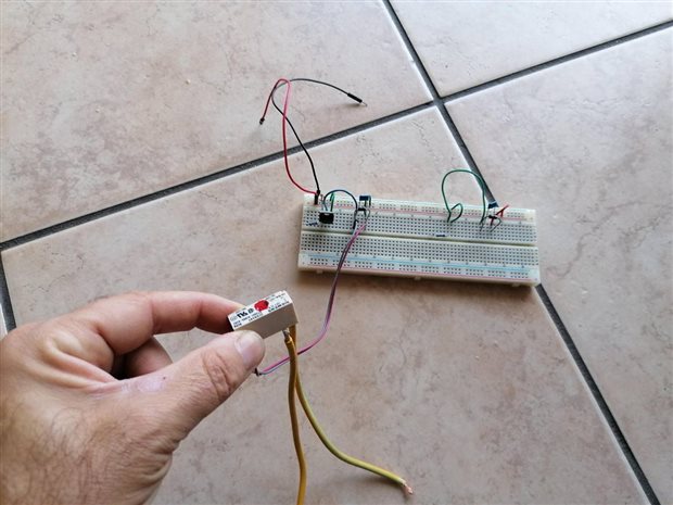

The circuit diagram is very simple. We will only have to connect the resistive divider with the NTC sensor and the relay to the Arduino Mega and supply current to the control board via the USB cable.

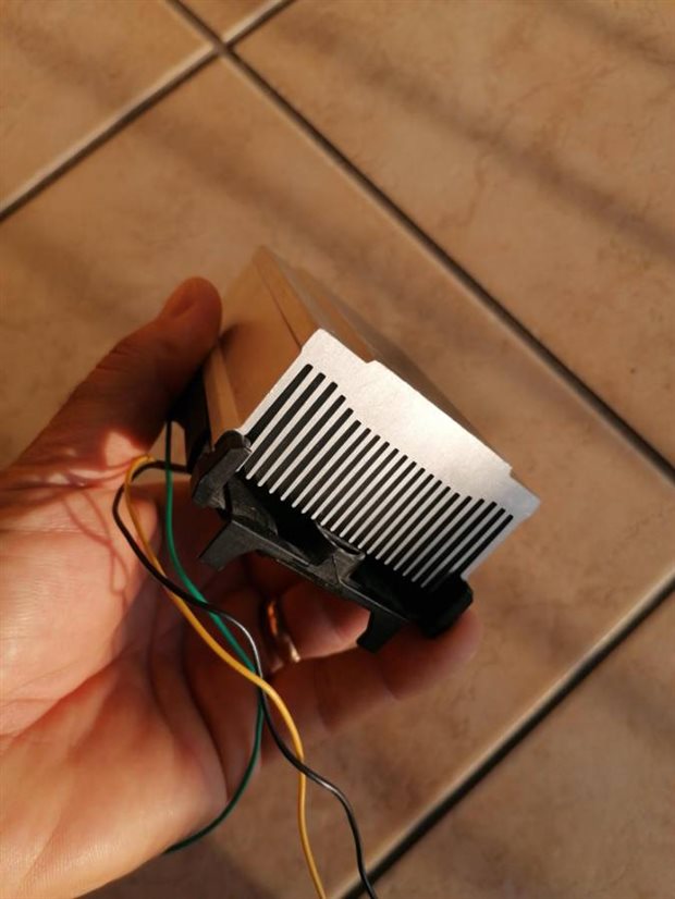

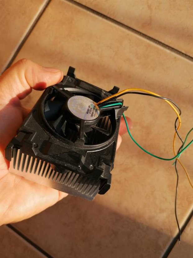

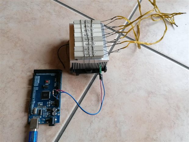

As a test, I will use the CPU cooler from an old PC and use a series of current-carrying power resistors to heat this cooler. It has a large mass of aluminum and it will therefore be necessary to apply voltage to the resistances for several minutes to raise the temperature.
In this case, we will not use any driver and our control will simply consist of powering the resistors until the temperature reaches the desired value and then stop the current flow. When the heatsink temperature drops below the desired value, the resistive load will be powered again, heating the heatsink again. When fully operational, we expect the temperature on the heatsink to remain around the chosen temperature value.

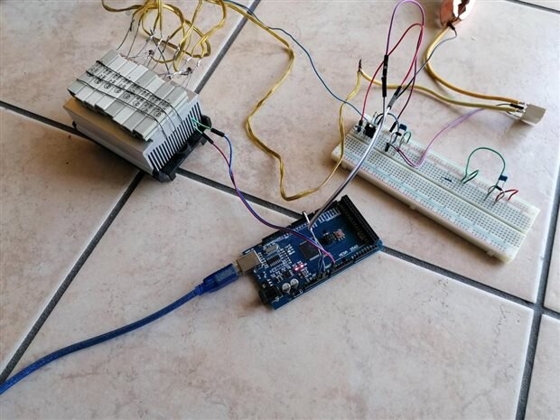

Construction
The construction of the heating and measurement unit was done in a rather rough way as I had to use (or rather recycle, as our friend Enrico Miglino taught us in his 3 webinars Vintage Upcycling with Raspberry Pi and Arduino: Part 1: Pi Rotary ) material that I had at home. The work was a lot of fun and, often, I felt almost as brilliant as Wile E. Coyote.
{gallery} The construction
From the photos, you can see the solutions that I tried to re-scale the prototype. Obviously, the yogurt maker will be the last step to take, for now, I would like to obtain a system that, powered at 12V, will provide me with temperature as constant as possible.

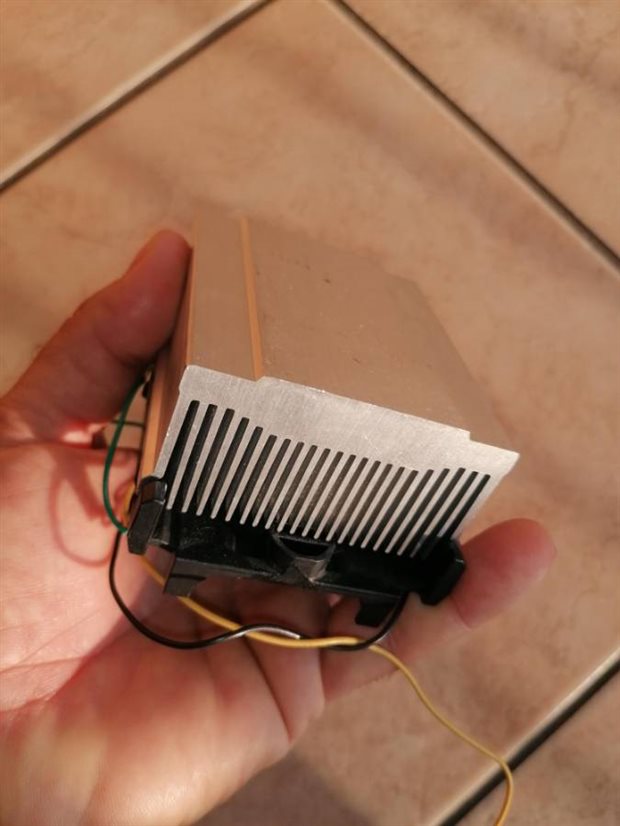

As support I used a heatsink from an old PC of mine, it still mounts its fan but, for this first test I will not use it, I will keep it in consideration for a second time when I might want to minimize the overshoot of the temperature compared to the desired value.

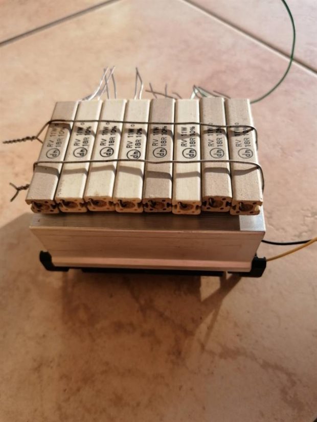

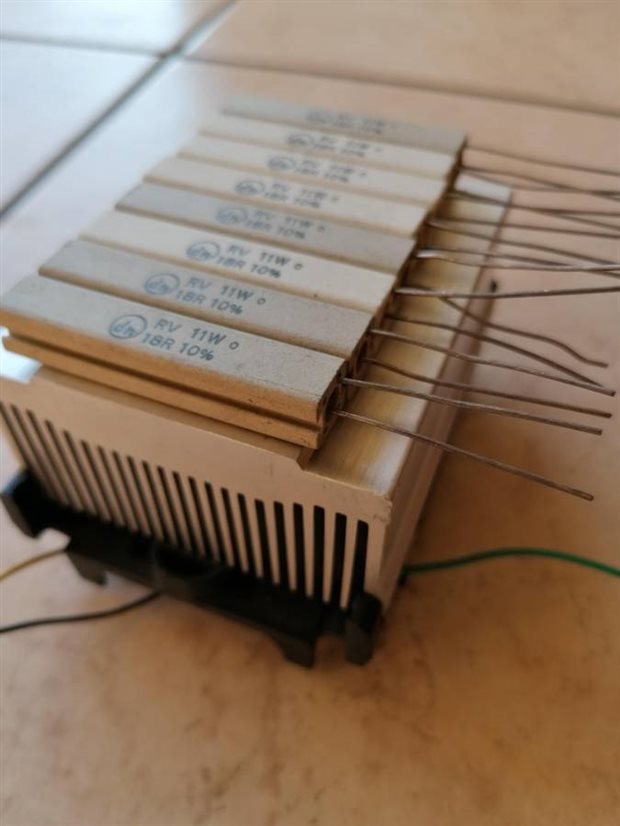

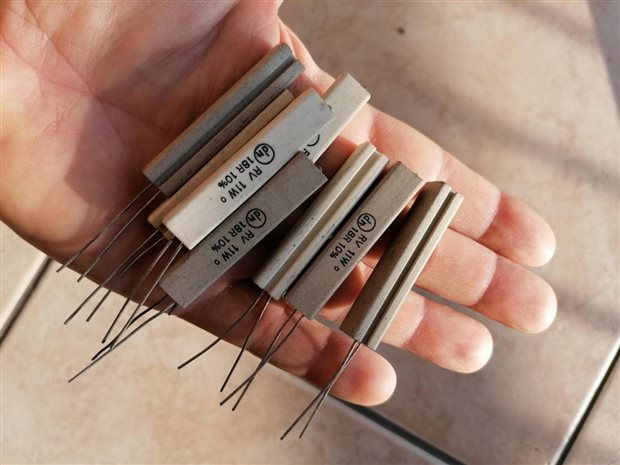

I fixed 8 resistors having a value of 18 Ohm and 11W on the heatsink and I fed them to 12V to obtain a heating element with a large surface and with a fixed heating profile. The resistors are tightened to the heatsink by 3 tight iron wires and the heat conduction is optimized using a silicone thermal grease.

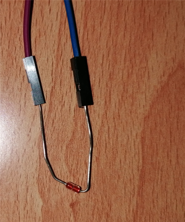

The sensor (NTC) is very small and has been inserted by pressure between two blades of the heatsink after having insulated the leads with heat-shrink tubing.
As soon as the heating elements are connected to the 12V power supply, the heat generated by the Joule effect will heat the heatsink in a few minutes, bringing it to the desired temperature.

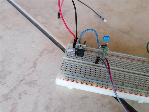

The voltage at the resistances is controlled by a relay which will let the current flow until the desired temperature is reached.
The relay will be driven by a MOSFET with a classic driver circuit.

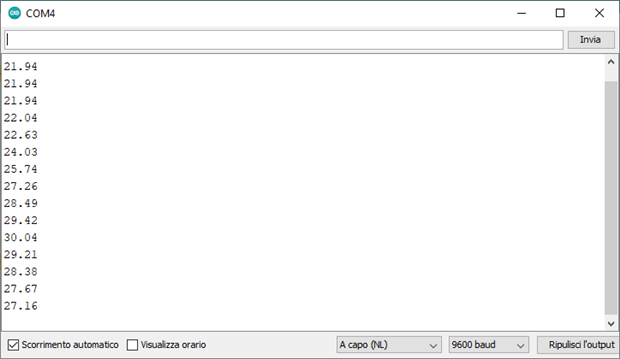

The temperature value will be sent from Arduino Mega to the serial port and, thanks to the use of the Putty software, it will be saved in a text file and subsequently displayed and graphed with a spreadsheet.

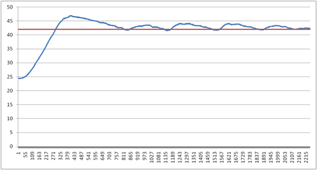

2215 readings were made, equal to about 36 consecutive minutes. In the ordinate axis, we will find the temperature in degrees Centigrade.
You can see how the control works quite well even with this very simple control scheme.

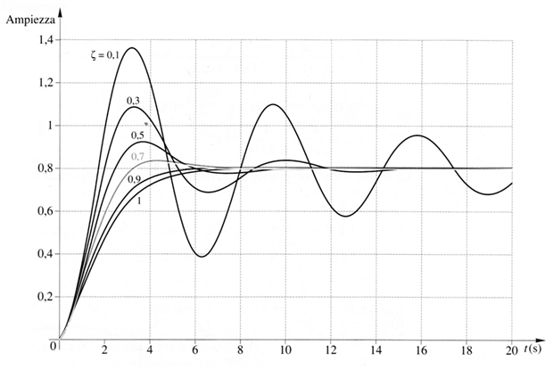

In the beginning, the temperature rises exceed the desired threshold and continue with a considerable overshoot, after which oscillations of less and less amplitude begin around the desired temperature.

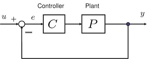

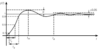

Obviously, in this case, we are realizing the control of an intrinsically slow physical quantity such as temperature. The same control scheme would have much worse behavior in the case of physical phenomena with faster dynamics. We, therefore, have an answer similar to that of a second-order system like the one in the figure.
It would have been didactically useful to see now an example of proportional control in order to reduce or completely eliminate the overshoot, you could use the classic system of feedback as in the figure and use the Arduino to calculate, at each iteration, the error (the difference between the output of the system, i.e. the measured temperature, and the desired one) and based on the error, perform a correction of the heat generated by the heating element ...

    Nice analysis. Sometimes you have to be careful with the overshoot and take a slower temperature ramp up. DAB
    DAB over 6 years ago in reply to redcharly +1
    I would go with a PWM drive signal so you can reduce the duty cycle at various levels of temperature. A simple Arduino circuit and software would allow you to program in the right amount of power to meet…
    A simple Arduino circuit and software would allow you to program in the right amount of power to meet your temperature needs without turning into a hard on off control.

    Yes DAB, the overshoot is a little too much but considering it was only an ON-OFF control, that's okay too.
    As soon as I have a couple of free afternoons I will try to perform a true feedback control, evaluating both the error and its derivative to obtain a response with no or little overshoot and reduced settling time.
