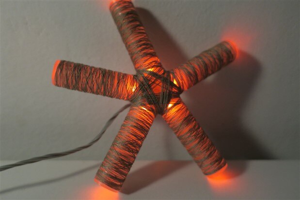

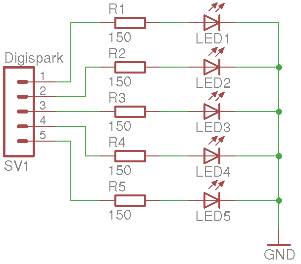

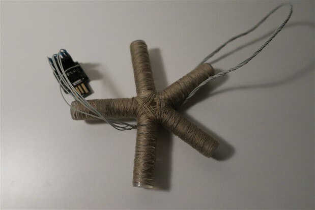

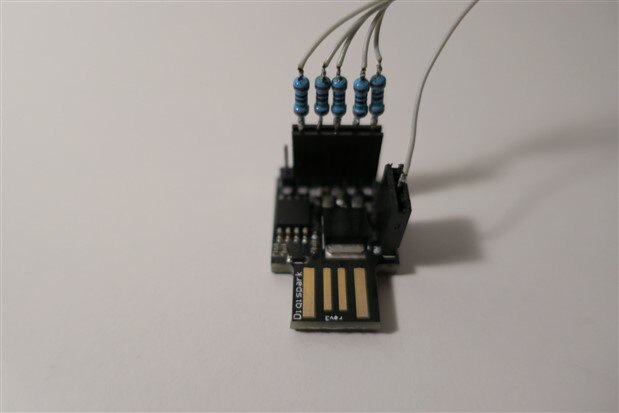

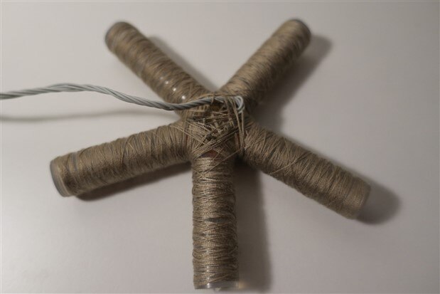

Hi,
I would like to show simple Christmas decoration. Cotton LED star was made from 5 orange LEDs, few pieces of hotmelt and cotton thread. Each LED diode is controlled by Digispark module with ATTINY85 module. Program was written in C language.image
Schematic:
Photos:
Video:
Source code in attachment.
