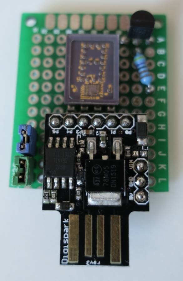

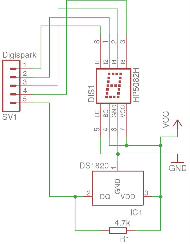

I would like to show you a simple thermometer with single seven segment LED display HP 5082-7356, DS18B20 sensor and Digispark module. DS18B20 sensor is able to measure temperatures in range form -55 to 125 °C. Digispark module communicates with DS18B20 sensor by 1-Wire interface and reads temperature every 10 seconds. Value of temperature (stored as integer) is displayed on HP display.
Schematic:

    mcb1 over 9 years ago +3
    Nice post. jw0752 see if you can expand it to 2 digits not enough pins on a Digispark. BUT if you use I2C you can drive an LCD. This one sensed the temperature, displayed it and sent a code via 433Mhz…

  • kk99
    kk99 over 9 years ago in reply to mcb1 +1
    Yes, I know that bootlader takes some time at startup. I think that for drive more displays e.g. 4 digits with dot points, we could use I/O expander with I2C bus e.g. PCF8574.

    mcb1 over 9 years ago in reply to balearicdynamics
    My mistake ...
    In theory you could use the 6th line.
    But all these options sort of negates kk99 idea of a simple limited component temperature display.
    BTW did you know there is a bootloader that removes the 5 sec delay on power on.
    balearicdynamics over 9 years ago in reply to mcb1
    Not sufficient too for a shift register ?
