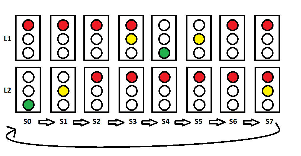

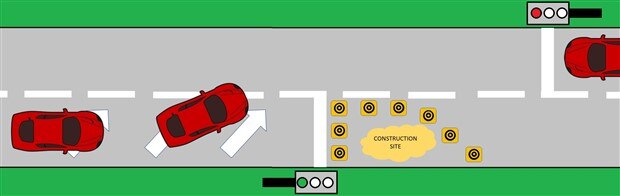

Imagine a traffic situation like this:
and what the traffic lights signal:
This behavior could be performed by a finite-state machine.
Finite-state machines (FSM)
Basically, a state machine is a mathematical model, in which a machine is in exactly one of the defined states. A change of state from one to another is called a transition. I don't want to get too deep into the details, but there is a nice reading on Wikipedia on Finite-state machines.
It is worth mentioning two FSM models: a Moore machine and a Mealy machine.
A Moore machine is a FSM which output state is only determined by the current state. This is our case in this simple project, because we have defined light patterns and the transition between them do not depend on any input. Each state has three attributes: know the LED pattern for the state; have a defined time delay to wait in the state and finally, know to which state to transition.
A Mealy machine is a bit complex model, involving input. Output values are determined by the current state and the current inputs. This could be one of the future improvements of this project, add traffic sensors, buttons for zebra crossings etc.

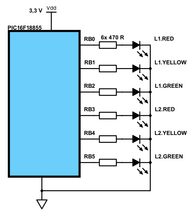

Here is a link to the schematics of the evaluation board: http://ww1.microchip.com/downloads/en/DeviceDoc/MPLAB%20Xpress.pdf . The board itself features an integrated programmer (acting as a mass storage device) and a serial interface (USB CDC driver). One user push button, 4 red SMD LEDs, a push button and a potentiometer can also come handy in small projects. In addition to that, there is a populated mikroBUS socket, that can be used with ca. 300 boards, or with your own.
Note: Any other board of your choice can be used, too. The implementation (following below) is purely in SW and without any HW specific dependency.
The only external hardware connected to the evaluation board are the LEDs with resistors. I chose PORTB, pins RB5:RB0. L1 stands for light in one direction and L2 for the light in the other direction. LEDs are connected to the microcontroller with their anodes (through the resistors) and with cathodes to the negative power supply terminal. The resistors limit current to ca. 3 mA through each LED, which seems to be sufficient.

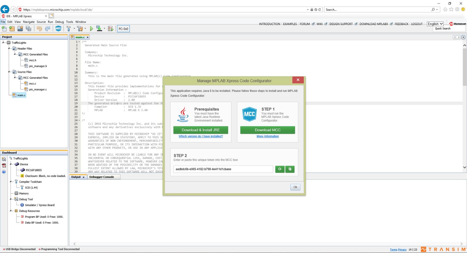

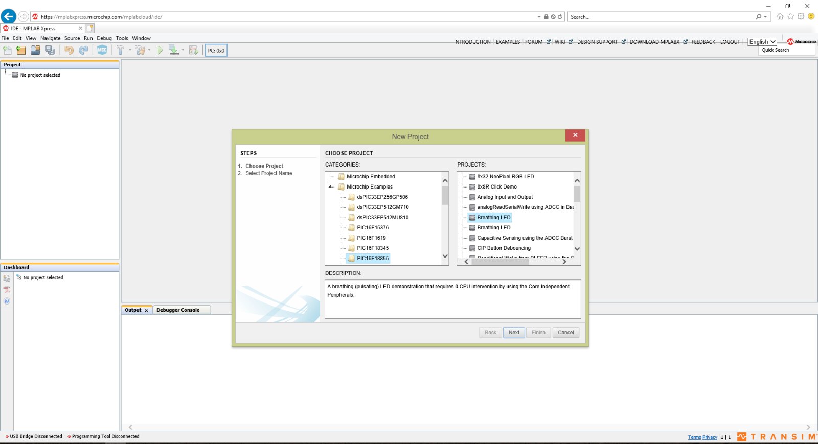

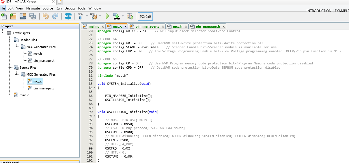

I wanted to give a try to Microchip's MPLAB Xpress Cloud-based IDE. It can be used without a registration (Microchip login), but I highly recommend it, because all the project files are then saved in remote location. Microchip engineers provided quite a few examples for various PICs (mostly for the ones on Xpress boards and Curiosity boards). It seems to be a good starting point for anyone not so familiar with these microcontrollers. (If you know the IDE, feel free to skip this part.)

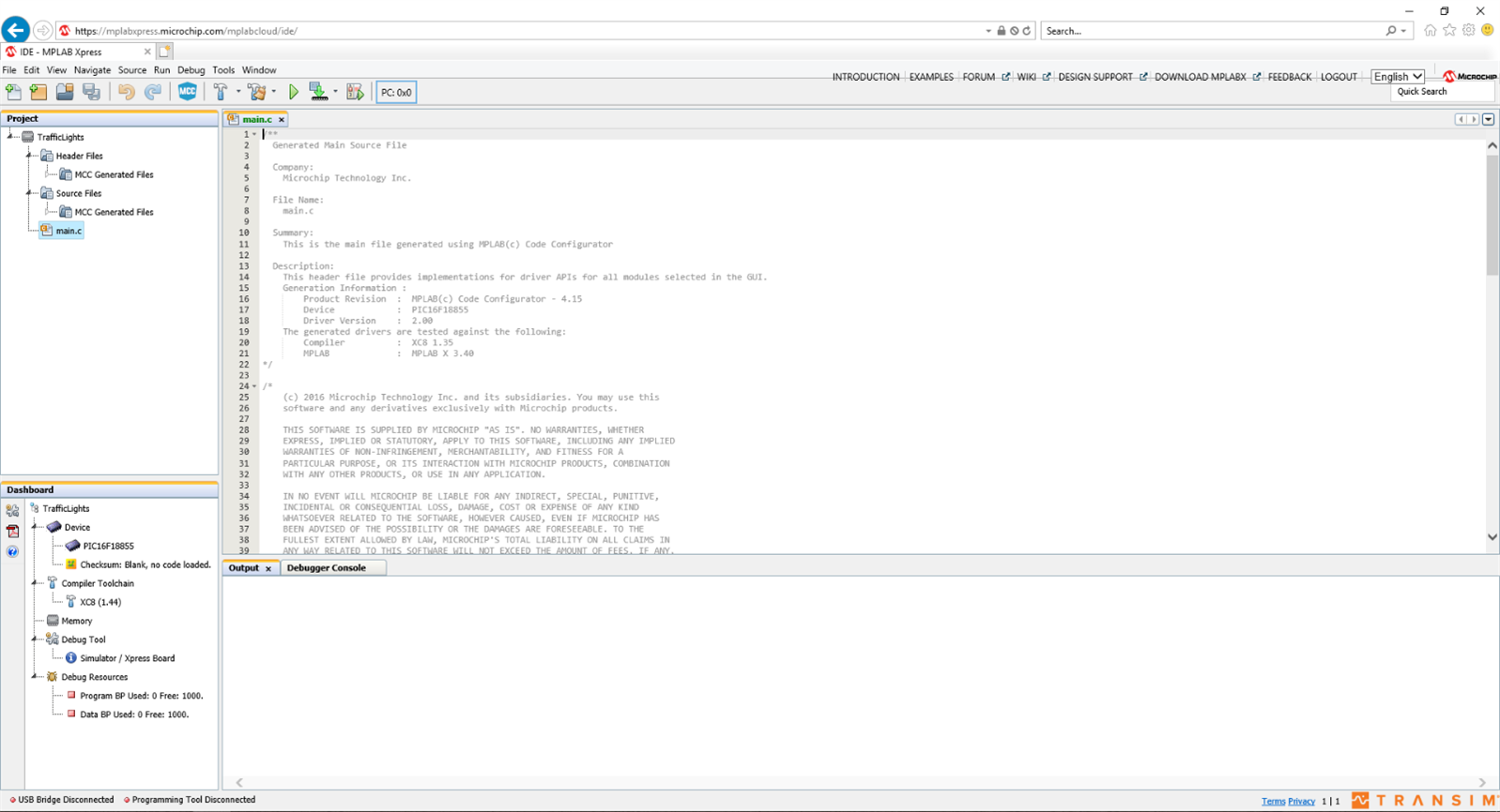

The environment (after creating a new project or opening an existing one) looks like a lightweight IDE. Compared to Arduino IDE, it shows more device information and provides more functionality. Compared to full-features IDEs, it lacks many features and the basic use cases are obvious: create a project (preferably from an example), configure the peripherals using the Microchip MPLAB Xpress Code Configurator - MCC (again, a lightweight version, plus it requires Java Runtime Environment), build the program and download the hex file. Nothing less, nothing more. It offers direct programming and debugging for Curiosity boards, but not the Xpress board used in this example.
In order to use the MCC, JRE is requiered and a browser that is able to run Java plugins - which is in these days only Internet Explorer and Safari. MCC runs as a Java application on your computer and the browser with the IDE communicates with the application.
Similar procedure is used with the Curiosity boards and USB Bridge functionality (which I haven't tried as I don't have any Curiosity board).

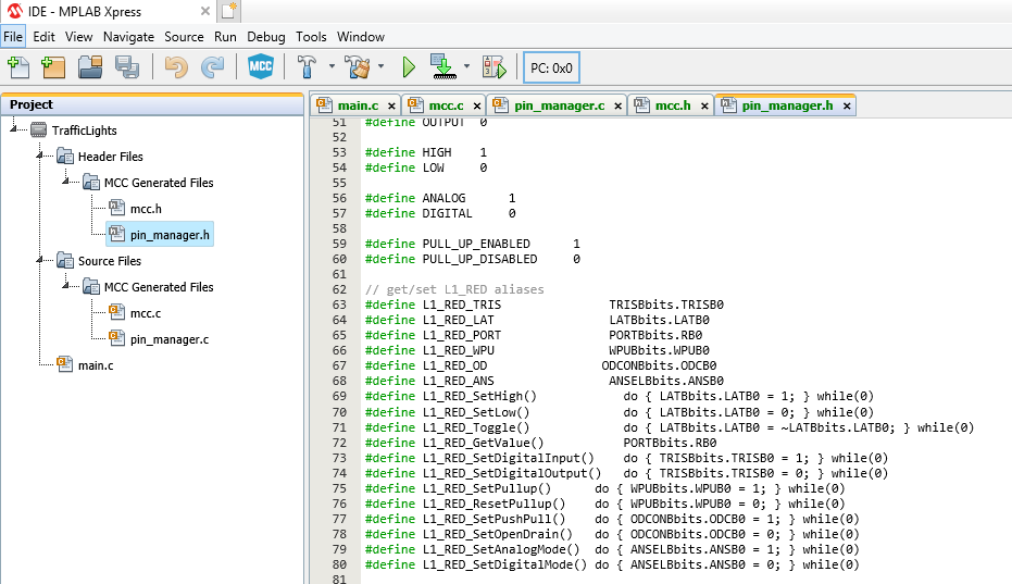

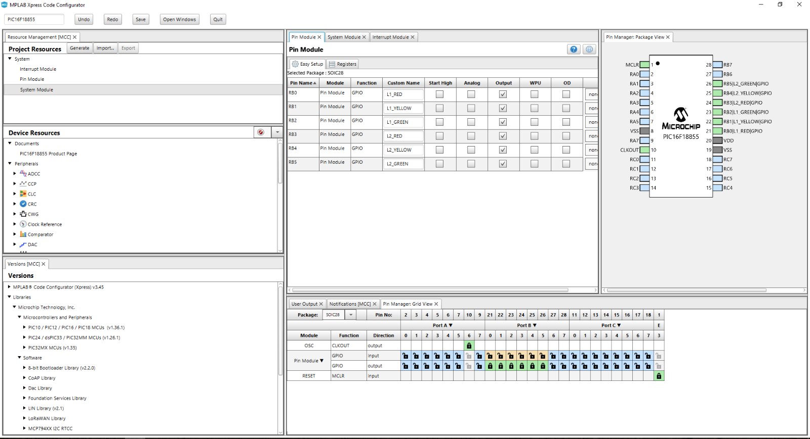

And here is the MCC up and running. It allows you to configure the configuration bits of the device (system settings), input/output pins, peripherals etc.
Below is a configuration of output pins for two traffic lights.
I assigned RB5:RB0 pins as outputs and changed the configuration a bit. Default high speed internal oscillator is running at 4 MHz (which gives us 1 000 000 instructions per second = 1 MIPS), which is much faster than we need. I changed this to low frequency internal oscillator running at 31 kHz (7 750 KIPS). Feel free to make the speed even lower, the 31 kHz can be divided by 1 up to 512, meaning ca. 15 instructions per second. I have to admit I haven't measured the power consumption yet. At 15 instructions second it should be significantly lower than at 1 MIPS image There are more ways to lower the power consumption to make this device last longer on a battery - we will get to that later.
The output is generated using the Generate button as a set of header and c source files directly into the running cloud IDE. pin_manager files hold the configuration of pins (analog / digital inputs / outputs, ...) and mcc files hold the configuration of the device and its peripherals. Lots of useful functions are defined:

1) States are numbered, so it's easy to reference to them.
2) LED patterns assigned to the states are defined.
3) Lengths of time delays are defined.
4) A struct is defined, to hold all the necessary state information. As described above, each state has three attributes: LED pattern of the state; a time delay to wait in the state and a reference to the next state.
