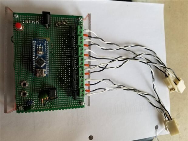

input your phone or ipod into the control board with a 1/4 stereo plug. A 1/4 inch output  jack is provided to plug into your stereo system.
your analog audio is converted to illuminated bands of bright colors
MSGEq7 graphic equalizer IC
https://www.sparkfun.com/datasheets/Components/General/MSGEQ7.pdf

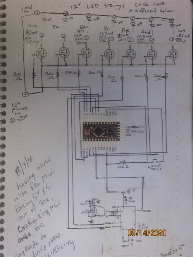

The power input is a 12V 10A power supply , the pigtails have unique plug pinouts for each light bar.
The LEDs bars stay outside 100% of the time, but the power supply and Arduino / MSGEQ7 drive board needs to come inside for the winter and bad weather.
The red pushbutton starts a test mode flashing sequence/light show.
The MSGEQ7 chips is clocked and its analog output read by an Arduno Nano. The nano outout turns on for each band that exceeds a preset analog threshold.
  -> added pot to analog input 1 for threshold adjust on LED trigger
  -> add a PB to D6 to run a test routine that strobes the lights
  control interface to MSGEQ7 IC
  strobe control for equalizer bands, read in multiplexed voltage per band, drive outputs LEDs
  Arduino D4 wires to MSGEQ7 pin 4 strobe
  Arduino D5 wires to MSGEQ7 pin 7 reset
  all ins have pull ups
  Arduino D7 = 63Hz LED , LOW = ON
  Arduino D8 = 160Hz LED
  Arduino D9 = 400Hz LED
  Arduino D10 = 1kHz LED
  Arduino D11 = 2.5 kHz LED
  Arduino D12 = 6kHz LED
  Arduino D13 = 16kHz LED
  Arduino A0 wires to MSGEQ7 pin 3 Vout
