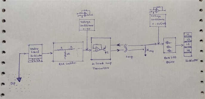

The Plan

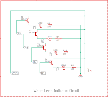

The system is divided into 5 blocks with the water level indicator being the first one for getting digital reading based on the level as sensed by the transistor. If Vcc is let to the water(5V), with common emitter(CE) configuration, dipping the transistor base terminal to the same would pick up a minute amount of current and we have β times amplification so as to drive the LED. Multiple water levels are monitored using this method.

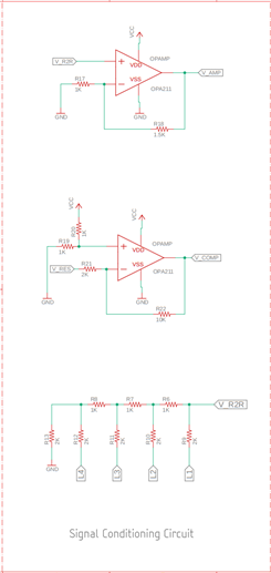

Next comes the R2R ladder based digital to analog converter(DAC) which takes in the water level data from 4 transistors and converts to equivalent analog voltage in 0-5V range. Hence, this analog voltage also fluently determines the same water level value. This is done to condition the 4-20mA transmitter circuit and to provide equivalent current to the loop using the Op-Amp which drives the base of current transmitting BJT.

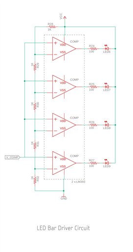

On another side of the loop, a resistor is placed whose value is predicted based on the range of voltage required to measure for the receiver. It's nothing but the voltage across the resistor is measured and that is a function of the level of the water as encoded in the current. The consequence of Ohm's law is that the voltage across a resistor is equal to current times resistance helps here. This acquired voltage is fed to the bar LED driver which is an LM393 comparator based circuit to show the appropriate level of water, visually digitally using LEDs. Overall it's a Digital - Analog - Digital conversion (LoL......DAD).

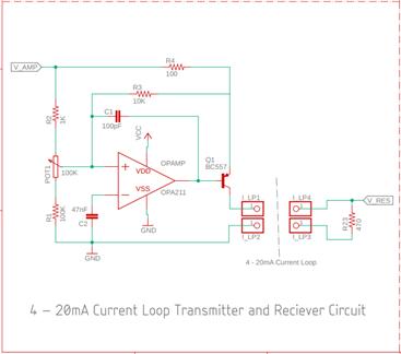

Schematics
Time for schematics,.......structuring and giving life to the plan. I used Eagle PCB software to design these.
Testing and Working
Now, doing some preliminary testing to validate the design. I used UA741 Op-Amp initially(moved to OPA211 rail to rail opamp later) to check test the current loop. Found that it was giving a lot of distortion and output voltage has saturated early(not with the scope though). What I am designing is not a standard 4-20mA current loop as it's not driven by 24V and strictly adhered to 4-20mA signals, but closer or a mimic of it with some limitations.
Being done with comparator setup for driving bar LEDs, I tested it by tuning 0 to 5V using a variable buck convertor. That looked fine and the only thing was to have exact 0 to 5V for this comparator setup to switch and drive LEDs.

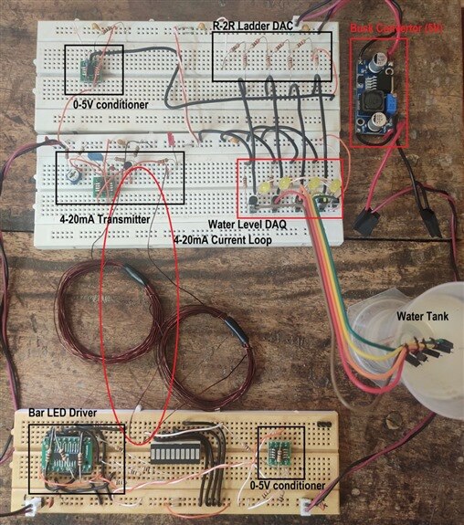

After testing and tweaking a few resistive feedback and offset parameters, I integrated all the sections. Below is the image of full setup highlighted block by block.
Yes, there is a LED in the middle which isn't functional and I was nearly able to get the full-scale range of the actual water level which is in 4-bits(4 LEDs). This is how it works, with LEDs behind showing water level directly from the transistor signal and the bar LED showing the same corresponding water level through a long way of 4-20mA current loop.
