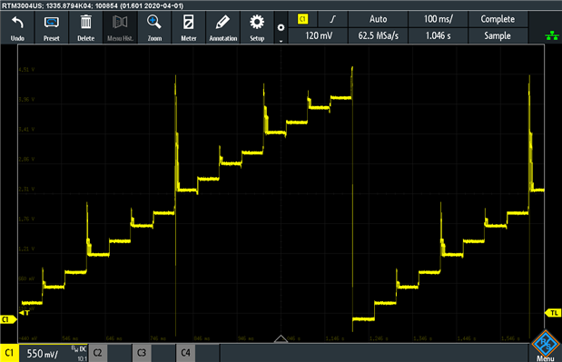

Linear DAC Codes from 0x0 to 0xF. (Notice the relay noise!)image

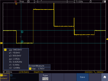

Let's use two voltages as an example 1.0 and 4.0. Starting with 1.0.
1.00 volt Binary Search Example
DAC Binary Search for 1.00 voltsimage
  1. S/H Amplifier samples the input voltage at 1.0 volts.
  2. DAC is set to b1000 (0x8), representing 2.50 volts.
  3. Comparator result is a LOW because the Input volts is less than the DAC voltage
  4. Put a 0 in the DAC code's binary and set the next bit.
  5. DAC code becomes 0b0100 (0x4), representing 1.25 volts
  6. Comparator result is a LOW because the Input voltage is less than the DAC voltage
  7. Put a 0 in the DAC code's binary and set the next bit.
  8. DAC Code becomes 0b0010 (0x2), representing 0.63 volts
  9. Comparator result is a HIGH because the Input voltage is higher than the DAC voltage
  10. Put a 1 in the DAC code's binary (which in this case, stays set.) and set the next bit
  11. DAC Code becomes 0b0011(0x3), representing 0.95 volts
  12. Comparator result is a HIGH because the Input voltage is higher than the DAC voltage
  13. Put a 1 in the DAC code's binary

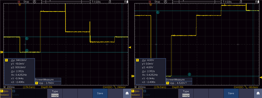

Take note that steps 2-13 are essentially a loop. The key is moving from left to right (or MSB to LSB ). If a bit results in a voltage that is too high, then there is no reason to test any more codes with that bit set to 1. That behavior is the binary search and means we never have to test more than 4 codes

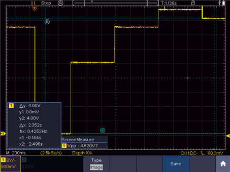

4.00v Binary Search Example
Here is a scope screenshot of the DAC searching for an input voltage of 4.00 volts. You can see how it starts at 2.5 volts, just like before, but now hunts "up." The second to last code is too far, so it backs down a single bit to get closer to the input voltage.
I should note, to make it easy to trigger the scope and see the start of the search, the register always sets the DAC output to 0 volts as a first step. This step is not part of the binary search. It makes the visualization easier. In a real-world application, there probably isn't a good reason to waste a cycle doing that.
DAC Binary Search for 4.00 voltsimage

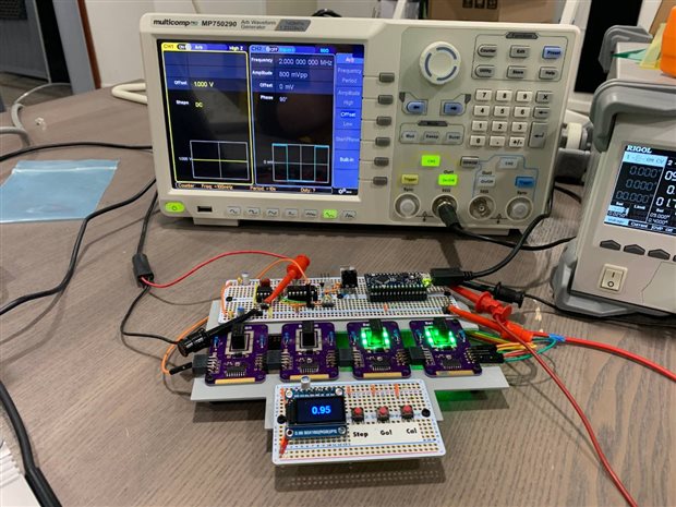

vADC Search Code
Here is the code from the current vADC prototype. I do not expect this to change much. It works as expected.

The primary benefit of using the binary search is speed. It can fully digitize the input signal in far fewer iterations than if we searched from 0x0 to 0xF. The second benefit is that it is relatively easy to implement in hardware. That benefit might not be fully realized in this project since we are using an Arduino Nano 33 Every. But in writing the code, I tried to demonstrate the effective steps that are occurring and hint at how it could be implemented with basic logic circuits. Perhaps one day, I can tackle that particular challenge.
For now, I need to grab my camera and record a short video. image
