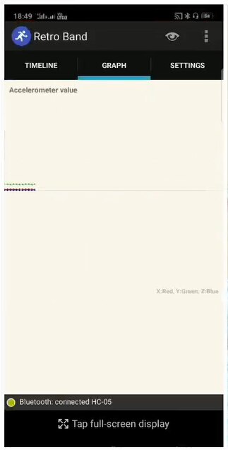

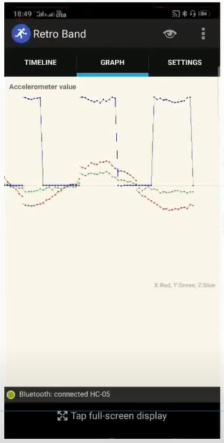

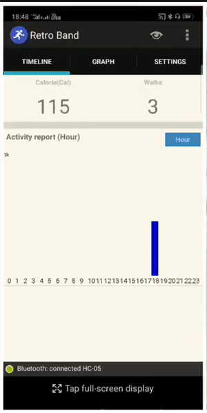

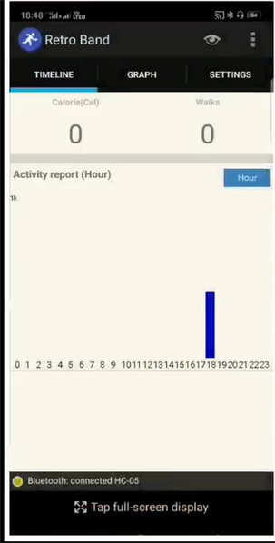

Step 4: Installing and Running the App
If you install the app, run it and pair the mobile device with Activity Tracker to see the app successfully receives the data. The app has 3 tab menus.
Timeline : It gathers cumulative burned calorie data every hour. You can check how many calories you have burned hourly / daily / monthly.

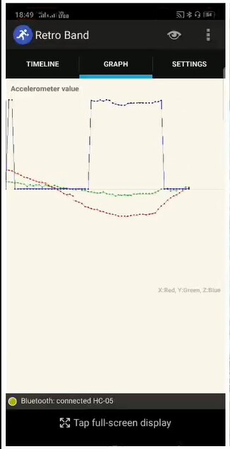

Graph : It shows the graph that is drawn by the data sent from the accelerometer. You can see how 3-axis values alter.
Settings : You can configure the app setting here, and input your weight here.
If you successfully test the app, connect  battery and finish the work.

                                                       Step 5:Result
Timeline: If Arduino powers on and the pairing process with Retro Band app is done, the board check the accelerometer data 20 times in every 1 second. And it transfer the data to the mobile device once a second. The accelerometer measures x axis / y axis / z axis values, so the band sends 60 values(20 times x 3 axis) of data to the device. The Android app receives the data during two seconds and finds out an interval that user’s movement increase dramatically. The number of user’s movement increase is user’s a step count. The app calculate burned calories based on user’s weight and steps, and accumulates data monthly, daily and hourly as shown in picture below:
Graphical Result : It shows the graph that is drawn by the data sent from the accelerometer. You can see how 3-axis values alter as given in picture below:
