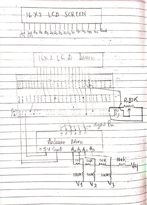

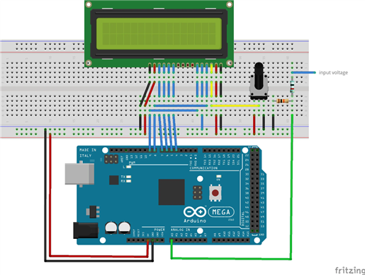

Circuit Diagram
Circuit Diagram (1.0) for measuring single Voltage
In the above circuit diagram, the microcontroller is Arduino mega the same circuitry can be applied with Arduino Uno and Nano. And this circuit is for measuring a single voltage.
The potentiometer is connected to the 5V source and GND and the middle terminal is connected to pin 3 of LCD. Rotating this pot changes the brightness of the LCD. The four data pins DB4-DB7 are connected to the Arduino pins 4-7. Enable is connected to pin 9 of the Arduino and RS is connected to pin 8 of the Arduino. RW is connected to ground. The backlight LED is connected to 5V and ground. The following table shows the pin connections:
DB4 ----->pin4
DB5 ----->pin5
DB6 ----->pin6
DB7 ----->pin7
RS   ----->pin8
EN   ----->pin9
Circuit Diagram (1.1) for measuring for 4 voltages
The above circuit diagram will be the same as that of the circuit(1.0), the only difference is about the increase in the number of resistors and analog pins to measure different voltages simultaneously.

  • michaelkellett
    michaelkellett over 5 years ago +4
    The Arduino doesn't have a very good resolution but the ADC can measure quite fast. You can improve the resolution by averaging several ADC readings per measurement. It isn't as good as having a better…
  • michaelkellett
    It isn't as good as having a better ADC but will be an improvement on the basic single sample per measurement  method.
    MK
