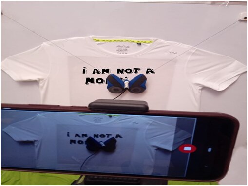

Writing/Drawing on a T-shirt:-
Hang the T-shirt tightly on a vertical surface. And tell “DrawBo” whatever needs to be drawn on T-shirt through the mobile application.

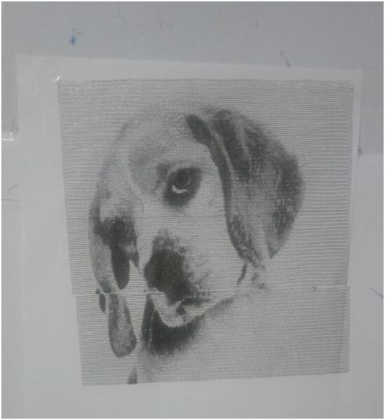

Sketching & Portrait:-
It can make a sketch or portrait of any image.
DrawBo sketching a dog

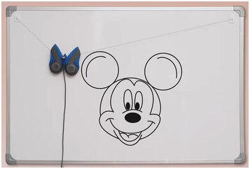

Drawing :-
In fact, the mobile application has a drawing library which has a vast collection of images. These images have been categorised into easy, medium or advanced level as per the level of complexity. Select any image from the internet or from the drawing library. And the robot will draw that.
In fact, it is intelligent enough to teach drawing. Its special drawing algorithms split the image into several simpler steps. It then takes a short pause after each step so that it is easier for learner to grasp the knack. In this way it teaches drawing.

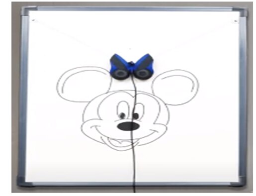

Working:-
  Hang the Drawbo on a white-board or any vertical surface with help of threads and suction-cups. Select any feature like fabric drawing, sketching or drawing on the mobile application. As soon as the feature is selected, DrawBo synchronises with mobile application via Bluetooth and performs that task.
