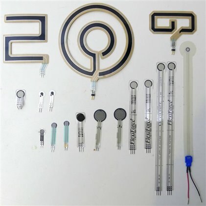

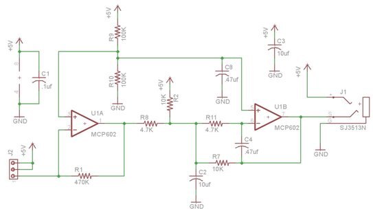

Sensors
The sensors I will be using are force sensitive resistors (FSR). I have a large collection of different types of FSR. This picture shows a few examples:
Before getting into the ADC interface, I want to first explore force sensitive resistors and their interface requirements...

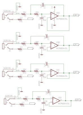

Sensor Interfacing
Here is a discussion of sensor characteristics and now they can be interfaced:
Here is a typical sensor interface schematic:
This circuit provides a nice linear output that operates from a single supply and goes from zero volts at zero force all the way to the high rail at full force.
It even provides some low pass filtering.

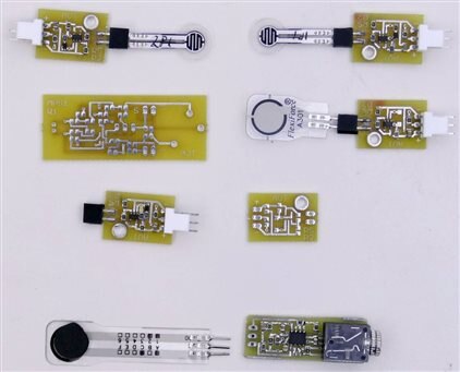

I have developed several different printed circuits to interface these sensors to analog MCU inputs - here are a few examples:
The following video shows how a typical sensor and circuit works using a DVM and oscilloscope:image

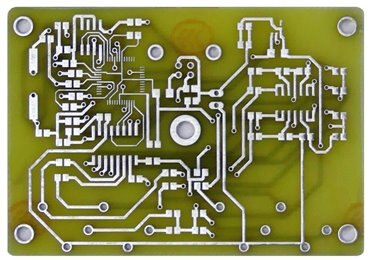

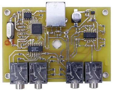

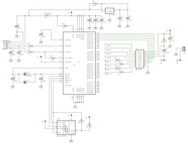

Hardware
The FT2232 translates USB to SPI, which connects to the MCP3208 A/D converter. The A/D is an 8 channel 12 bit SAR. I am running 4 sensor channels through low-pass filters to four of the A/D inputs and the same 4 sensor channels to 4 different A/D inputs, except with no filtering.
Here is the schematic:
The PCB looks like this:
The assembled CCA looks like this:
I am using 3.5mm stereo cables to connect to sensors (+5V, signal and GND).

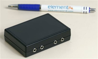

Packaging
I happened to have a Serpac C10Serpac C10 case of the correct size, (as in - it was designed to fit) so I used that to house the A/D CCA. The hole in the middle of the PCB matches up to a screw post in the middle of the case.

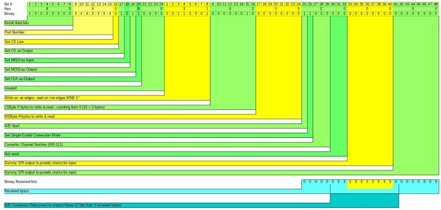

Communications Protocol
The result of an A/D conversion is obtained by sending a series of bits to the MCP3208 using SPI MOSI, which tell the chip which channel to convert and when to start. After the successive approximation conversion is complete, extra bits need to be sent to clock the result out of the chip using SPI MISO.
However, to send SPI data to the MCP3208 we are using an FT2232 (USB-to-SPI) chip. This chip needs to be configured to handle SPI properly, so the first 6 bytes sent over USB are used by the FT2232 to configure it to use SPI.
Here is the entire string of bits needed to complete an A/D transaction, only the last 3 bytes get passed on to the ADC, which passes 3 bytes back with the conversion data (in blue below):
As far as USB is concerned, we just send 9 bytes of data and receive 3 bytes back, but we need to extract the 12 bit conversion result from the 3 bytes as shown in the last line of the table. It is a bit strange that some of the 12 bits of interest come from each of the 3 bytes, but it isn't hard to extract the reading, once you know which bits to use.

    ' Clock data in. 3 bytes on -ve clock MSB first, no write
    AddToBuffer &H31                                ' write on -ve edges, read on +ve edges MSB 1st
    AddToBuffer &H2                                 ' LSB # bytes to write & read - counting from 0
    AddToBuffer &H0                                 ' MSB # bytes to write & read
    AddToBuffer &HC0                                ' MSByte bit 0 is A/D start, bit 1 is SE mode, bit 2 is Chan # MSB, bit 4 is Chan # LSB (Chan 0 = 11000000)
    AddToBuffer &H0                                 ' Middle byte is a dummy value to get enough read clocks
    AddToBuffer &H0                                 ' LSByte dummy value to get enough read clocks
    Saved_Port_Value = Saved_Port_Value Or &H8      ' set CS=high
    AddToBuffer &H80                                ' Set data bits low byte command
    AddToBuffer CLng(Saved_Port_Value)
    AddToBuffer &HB                                 ' CS=output, DI=input, DO=output, SK=output
    Saved_Port_Value = Saved_Port_Value And &HF7    ' set CS=low
    AddToBuffer &HC8                                ' Chan 1 = 11001000
    AddToBuffer &HD0                                ' Chan 2 = 11010000
    AddToBuffer &HD8                                ' Chan 3 = 11011000
    AddToBuffer &H87                                ' flush read buffer to USB
    SendBytes OutIndex
    ' wait for data to become available
    Do
        Res = Get_USB_Device_QueueStatus '
    Loop Until (FT_Q_Bytes > 5) Or (Res <> FT_OK)   ' wait for answer to be available
    If Res <> FT_OK Then
        Form1.shpOK.BackColor = Red
        StopReading = True
        Form1.lblStatus.Caption = "Get USB device queue status failed while waiting to read an ADC conversion."
        Exit Sub
    End If
    ' read the input queue
    I = Read_USB_Device_Buffer(FT_Q_Bytes)          ' read the bytes
    ' the MCP3202 sends a null bit on the 5th clock falling edge of the first byte followed by 3 data bits, then the
    ' 8 data bits in the 2nd byte and 1 bit in the 3rd byte. We must combine just the data ...
    For IB = 0 To 3
        IBC = IB * 3
        Byte0 = CByte(Asc(Mid(FT_In_Buffer, 1 + IBC, 1)))   ' convert to byte format
        Byte1 = CByte(Asc(Mid(FT_In_Buffer, 2 + IBC, 1)))   ' convert to byte format
        Byte2 = CByte(Asc(Mid(FT_In_Buffer, 3 + IBC, 1)))   ' convert to byte format
        Byte0 = Byte0 And &H7                               ' zero the 1st 5 bits of the MSByte
        Reading(IB) = (Byte0 And 7) * 512 + Byte1 * 2 + Byte2 / 128 ' combine to integer, mask = 00000111 11111111 10000000
    Next IB
