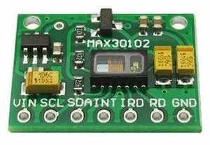

1. MAX30102
This is a MAX30102 based pulse oximetry and heart-rate monitor breakout board. It includes internal LEDs, photodetectors, optical elements, and low-noise electronics
with ambient light rejection. The MAX30102 provides a complete system solution to ease the design-in process for mobile and wearable devices.
The MAX30102 operates on a single 1.8V power supply  and a separate 3.3V power supply for the internal LEDs. Communication is through a standard I2C-compatible interface. The module can be shut down through software with zero standby current, allowing the power rails to remain powered at all times.
It is widely used in wearable devices, fitness assistant devices, smartphones and tables.

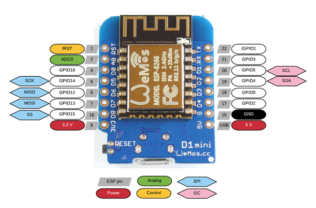

2. WEMOS D1 MINI
WeMos- D1 R2 WiFi ESP8266 Development Board is programmable via Arduino IDE. This is an ESP8266 based WiFi enabled microprocessor unit on a Arduino-UNO footprint. That means the board looks and works (in most cases) like an UNO. Several shields, sensors and output devices that are manufactured for the Arduino platform will work on the WeMos-D1R2 with the added advantage of builtin WiFi.
Features of Wemos D1 R2 Wifi -Esp8266 Development Board:
  • The D1 R2 is a mini wifi board based on ESP-8266EX
  • 11 digital input/output pins, all pins have interrupt/pwm/I2C/one-wire supported(except D0)
  • 1 analog input(3.3V max input)
  • A Micro USB connection
  • A power jack, 9-24V power input

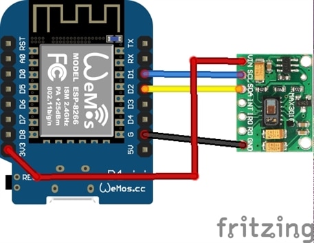

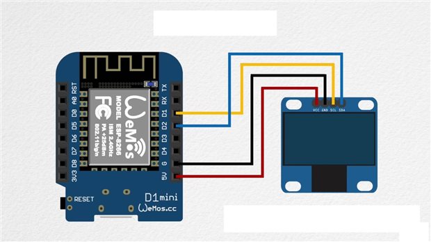

MAX30102 and OLED display connection with Wemos D1 mini
connections :
(MAX30102 WITH WEMOS D1 MINI )
1. SCL --> D1
2. SDA --> D2
3. VIN --> 3V3
4. GND --> GND
(OLED DISPLAY WITH WEMOS D1 MINI )
1. SCL --> D1
2. SDA --> D2
3. VIN --> 5V
4. GND --> GND

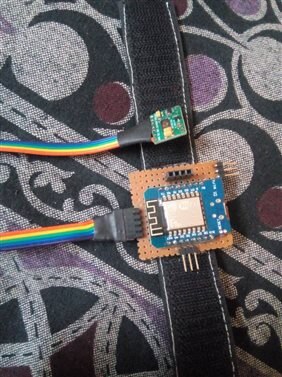

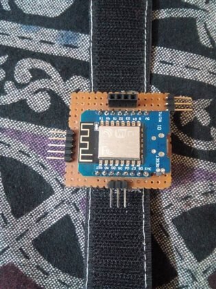

Connect the male and female headers for MAX30102 & OLED display repectively with Wemos D1 mini ESP8266 on a zero PCB, solder the Wemos D1 mini on a zero PCB use male headers for connecting MAX30102 & OLED display and stick the Velcro strap on back of the zero PCB with help of hot glue as shown
STEP2.

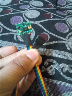

connect wires to the MAX30102 and connect a female berg on the other side of the connecting wire, as shown

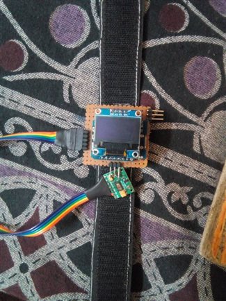

STEP3.
Connect female header of MAX30102 to the female headers of the band (made in step1)as shownimage
STEP4.
connect the OLED display to the male header of the wrist band as shown

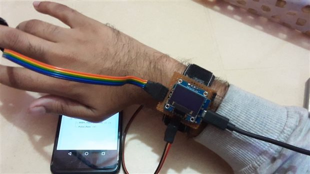

Now our project is ready, .
connect the usb cable to the Wemos D1 mini micro usb port and power it with help of a adapter,
it will take some time to became stable and then it will show the exact reading
