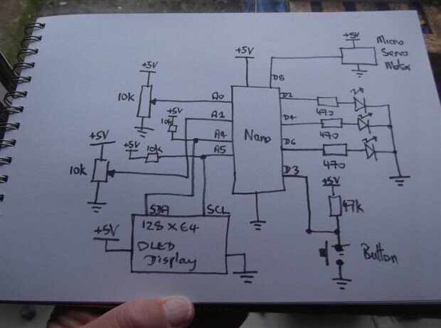

I have made some progress with my combined servo tester and pulse generator project. I am happy with the servo tester part so I have decided to add an OLED display (128 x 64) and a button to select different modes. The Servo Tester will be the first mode and the second mode I want to add will be a pulse generator. At present I have not written the code for the Pulse Generator but I now have the display working and the button to change between modes.
The revised circuit diagram is show below. I have just added a push-to-make button on D3 for mode selection and a 128x64 OLED display (SDA on A4 and SCL on A5). An updated circuit diagram is shown below.
The display is Adafruit compatible so I just used their libraries. I have not used button inputs on my projects for a very long time so it was a challenge to get that working. Identifying how the debounce would work and then how to use it to select the mode. I now have an infinite while statement inside the main loop, which will just cycle sequentially through the modes available. At present there are only have two modes: Servo Tester and Pulse Generator, but it would be easy to add further modes, perhaps such as a DVM. The main loop part of the programme is listed below.

After spending a couple of days trying to get the push button and debounce to work I was pleased when it all came together this morning, as illustrated in the following video.
All I have to do now is write the code for the pulse generator and if time permits, create some sort of 3D printed box, or possibly buy a case.
