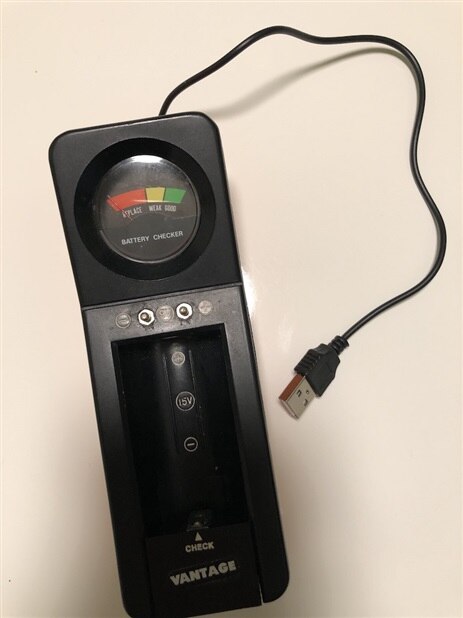

I recently found an old household battery tester while cleaning up, and it was terribly unreliable to use - the gauge doesn't always work, the contacts are sketchy at best. I was about to recycle it, but then I thought the gauge on it might be fun for a project so I tucked it away in a drawer.
When this Data Conversion challenge popped up, I immediately had an idea - maybe I could digitize the thing to make it more useful for my purpose: identify what a battery can be used for.

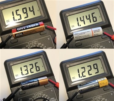

So I often use my digital multimeter to check if:
a) the battery is still new: generally 1.55v or higher
b) the battery is slightly used but still quite good: 1.4v - 1.55v
c) the battery is kinda low, but will light LED strings brightly: 1.3v - 1.4v
d) the battery is still fine enough for LED string lights: 1.0v - 1.3v -> these I keep as a last resort for the LED lights
e) the battery is too empty for anything useful, and is ready for recycling: less than 1 volt. It's also at a higher risk of leaking at this point.
My stunt batteries randomly happened to all be of different brands, which does help keep them sorted out.

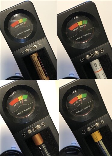

I tried the old battery tester, holding it carefully and having cleaned the contacts. The results are ok, but it really makes even the mostly-dead battery look like it's fine.
So this is where I think, with a little bit of technology, that I can do better!

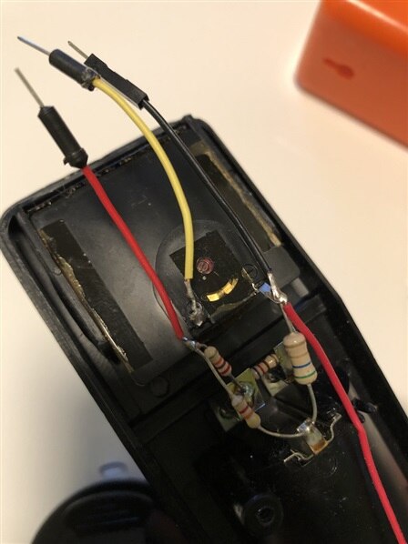

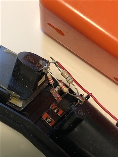

So I took the tester apart to look inside - thankfully, old technology was built in a way that allows easy access = 2 little screws!
And it looks like it has a few resistors making a voltage divider in there - note the extra resistors to also allow testing of a 9 volt battery.

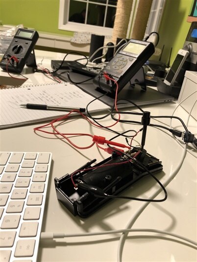

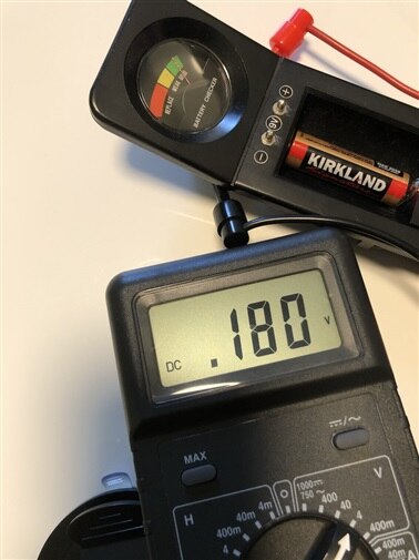

So I clipped on some probes to see the range of values I could expect to see at the gauge itself. Turns out to be very low fraction of a volt values. the 0.18v above is for a new battery.
So to keep things easy I decided to add some wires to intercept the voltage to the gauge, and use it directly as input into a Digispark clone ATTiny85 micro controller, given the low voltages.
Using the full battery voltage might've given a more accurate reading within the controller, but I'm not going back in there now!

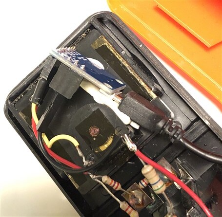

I carefully snipped the power side apart to get the new wires in between, but the ground was just an easy direct addition.
I was able to fit the little board directly behind the gauge, using a bit of tack to hold it in place. The USB power cord runs out a hole in the back.

I tried just entering some values and adjusting them to be roughly correct and then tune it, but I was so far off that nothing really worked... so much for my attempt at math-ing it out.
Turns out the Digisparks are really limited and don't have the ability to debug with the usual serial console, so it's a bit tougher to work with in this kind of scenario.
So I grabbed a trusty ole Uno and used it, along with a variable-voltage power supply I received from element14 in a previous competition a few years ago (what a great tool to have!!), to test what all the voltage input ranges end up being in the world of the controller.

And here is the finished project:
Here is a video of the final product giving me a hard time and untrustworthy results image
You might notice I'm not getting the accuracy I had hoped for. While I was testing with the variable power supply the results were far more consistent, so I don't know why it would be different using the batteries themselves - it's possible the contacts are just not making a good enough connection, but I don't know for sure.
In summary... this was fun to do, and the results are more of a "useless-box" type gadget!
The battery tester now needs external USB power to run the micro controller.
It seems that the micro controller is not really all that accurate and reliable at reading the input voltages properly all the time, but it does actually get a fairly decent result.
So... it's a lot like the old tester was!! sort of sketchy and unreliable... terrible contacts... a gauge with a loose display card that jams the needle... hard to tell if the result can be trusted. Yup! just like vintage tech image
