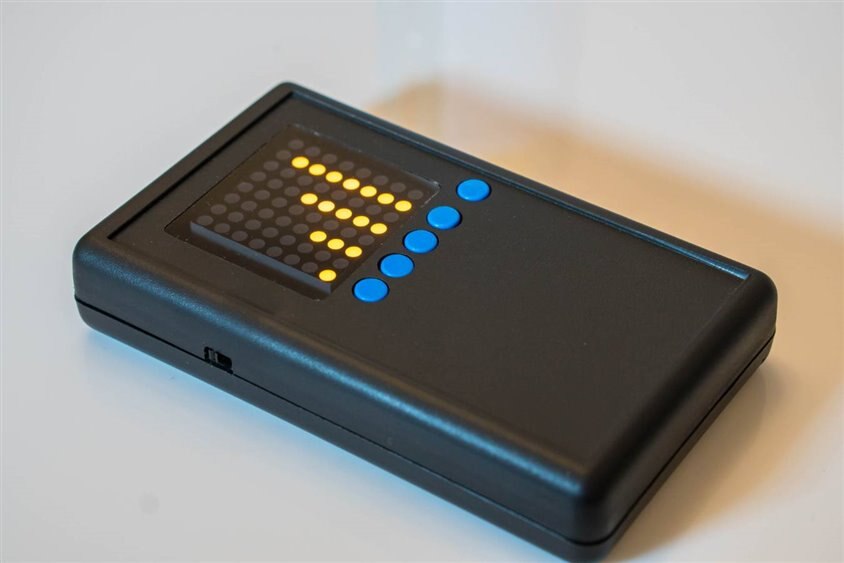

So, I set to work on building Electronic Pocket Nim. The children watched me finish off the circuit board design using EAGLE CAD software, and fitting to an enclosure visually using Fusion 360, so really they’ve seen a large chunk of the product development process, and insisted on playing with the early perfboard prototype each week they visited.
This article discusses how to build this project for $20, but it also covers some steps on how to design such games in the first place.
There’s an 8-minute video that covers the physical construction of it all:

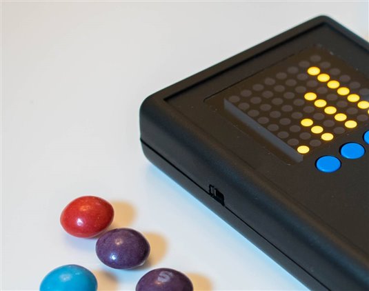

An LED matrix forms the screen! There is one button per row, for taking sticks (well, dots in this case). There is one Computer button (which is pressed after you’ve taken as many sticks as you want) for passing control to the microcontroller’s algorithm for it to make its move. The game ping-pongs between the user and the computer in this manner.
To change levels (this will abort the current game), the Computer button is held down while pressing any of the other buttons, to choose level 1-4 (4 is hardest).

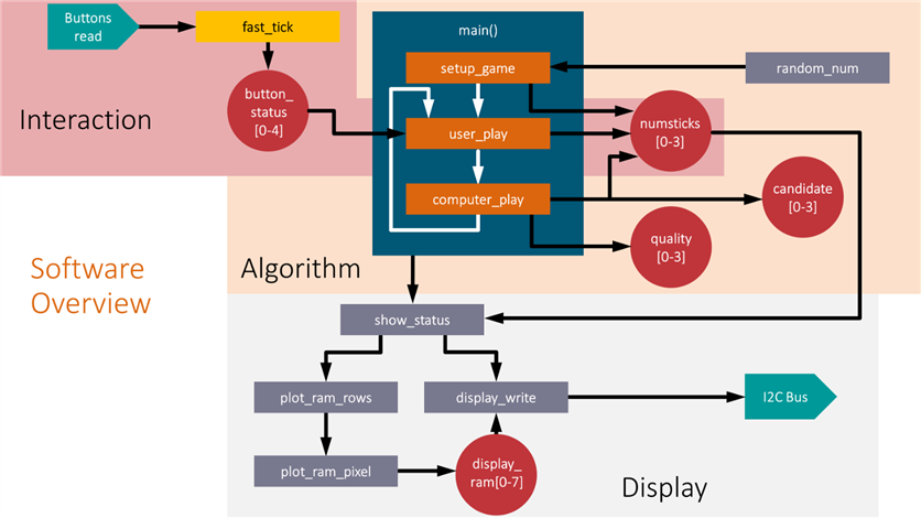

The heart of Pocket Nim is a microcontroller, running code written in C.
This project uses an Infineon ARM chip, with plenty of power and code space for improving the current game or adding new games. Getting started with the Infineon development environment is discussed in this blog post too - it is quite a fast way of creating projects.
For those interested in delving in the code, the main program just does a few things. There are only three key functions it calls.
Firstly, it calls setup_game which sets up the initial conditions for the game (i.e. how many rows will be available to play based on the difficulty level, and starting number of sticks in each row), and then it alternatively calls two functions, user_play and computer_play, until there is a winner. The core variable which is manipulated by user_play and computer_play is numsticks[], which is an array containing the number of sticks in each row. It is the single most important variable in this game.

Interrupt Function (fast_ticks)
In a puzzle game like Nim, there isn’t much timed stuff occurring. The Linux prototype of Pocket Nim (see below) didn’t have any timed functions at all. However, with the microcontroller implementation, a single timer interrupt is needed for button debounce and a few other purposes. The timer interrupt runs permanently while Pocket Nim is switched on, causing a function called fast_ticks to execute every millisecond. Several different variables are updated by fast_ticks, to handle things like the debounce as mentioned, and also for blinking a heartbeat LED on the microcontroller board, or for implementing delays to display update commands (the display chip doesn’t like being fed with data too fast) or for inserting deliberate pauses in game announcements (the computer doesn’t like losing, and it deliberately sulks for a second or so, before it indicates that the user has won).
The button debounce is important for Nim, and some thought was given to when events should occur (such as: should sticks be taken away on button-press, or on button-release?) to make the user interface feel ok for kids to play.

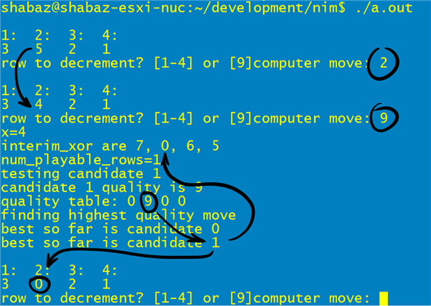

The easiest way to design a game like this is to do it as a Linux game first, before any hardware is developed. I wrote the algorithm and tested it on a Linux machine (a Raspberry Pi is very suitable for this). The command line is used instead of buttons and an LED display.
The software prototype could be done in any programming language. In my case I used C just to make it quicker to port to the microcontroller. Python could be used too. The standard C library printf and scanf statements (or if you’re doing it in Python it would be print and input) can be for displaying text and getting user input. It is a lot quicker to develop in this way, rather than keep downloading code into a microcontroller. As a result the algorithm was written and tested in under five hours work overall.
If you wish to play the game, the source code of the command line version of nim is available on github, ready to run on (say) Ubuntu or on a Raspberry Pi. Type the following in a command prompt window to download, build and run it:
mkdir nim
cd nim
wget https://raw.githubusercontent.com/shabaz123/pocket-nim/master/nim_desktop.c
gcc nim_desktop.c -o nim
./nim
Press numbers 1-4 (and press Enter) to take sticks from any column and repeat if you want to take more. Once you're done, press 9 (and then Enter) to pass control to the computer.
An example execution is shown below, where the rows initially had 3, 5, 2 and 1 sticks. I typed 2 and hit return to reduce the second row of sticks down to 4. Then I typed 9 to indicate that the computer should make its move. The algorithm debug output is shown, and eventually the computer decided to take sticks from the same row too (the row indices start from zero, so candidate 1 is really the second row), and the microcontroller decided to take all the sticks in that row.
The quality table values are 0, 9, 0 0, and this indicates that the algorithm greatly favoured taking sticks from the second row, since that has the highest quality value.
Incidentally, from the values in the screenshot above, the user has already likely lost from this position. After the computer makes a move from this point on, regardless of what decisions the user makes, the computer can win provided it is not deliberately weakened (the computer is not totally invincible; some games at the highest difficulty level can be won by the user).
Next, the code was copy-pasted into the microcontroller development environment, and the areas of code that had the printf and scanf functions were extended with the code to interact with the hardware (display and buttons). The printf statements can be left in, because when the microcontroller software is running in debug mode, the software development environment can output text into a console window. This too speeds up development. The scanf statements were replaced with code that would wait for button presses.

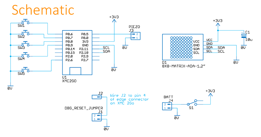

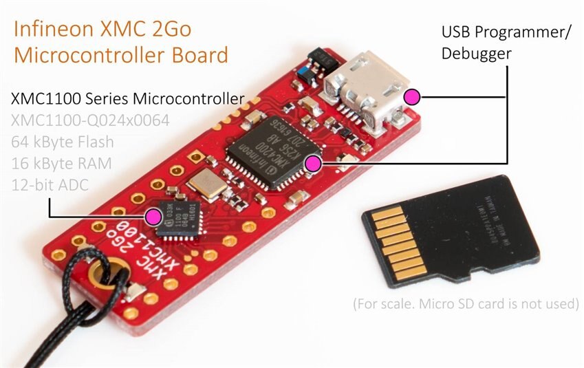

For this project, Infineon’s XMC 2Go microcontroller board was used. Like an Arduino, it has an on-board USB connector for directly programming it from a PC. The board is tiny, not much bigger than a dual-in-line IC package. The microcontroller, part of the XMC1100 family, has an ARM Cortex-M0 core, 64 kbytes Flash memory and 16 kbyte RAM in a 24-pin QFN package.
The on-chip serial I2C interface is used for connecting to the 8x8 LED display, and some general-purpose pins are used for connecting to buttons. There is a 3.3V supply output exposed on one of the pins on the board, and for the prototype, that is used for powering the 8x8 display. This is outside the specification of the display driver chip (it is specified as 4.5V supply minimum to guarantee operation across its entire temperature range) but operating it at the correct supply will then require logic level translation too. For a non-critical application like this game, I think it’s ok to cut this corner. In fact, the display board that I tried continues to function down to 1.8V (at this extreme the display is very dim though). At 3.3V, the display was brighter than expected for indoor use (it can be dimmed in software by configuring a register via I2C).
For the PCB version, I wanted it all powered from a battery, and not the USB connector. At this point the XMC 2Go board was closely examined. It turns out, if there is no USB power source then the board can be powered by attaching a supply to the 3.3V rail, and that will operate the XMC1100 microcontroller, and the on-board debugger chip too. However, the debugger chip consumes a lot of current. There is a debugger reset connection on a tiny pad on the edge of the board, and that was wired to a jumper that can be shorted to ground to stop the debugger chip from booting, and saving lots of power. It is a shame that is not brought out to a larger pad. Anyway, it is possible to solder that with a bit of care. With that done, current consumption of Pocket Nim drops a lot!
The XMC1100 chip operates down to 1.8V which is awesome. A couple of AA or AAA alkaline cells will directly operate Pocket Nim for a long time (at least a whole day powered up using AAA cells, since it consumes around 25mA at 3V) and will still result in a bright display. So, considering all this, the final design has no voltage regulator. It doesn’t need it.

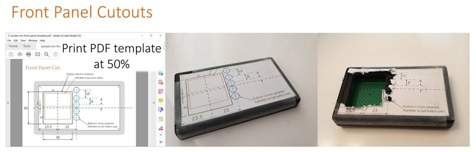

To help with cutting the front of the case, a PDF file is attached to this blog post that can be used as a template. The file is to double scale, so it needs to be printed at 50%.  A 3D printed case might be another option.

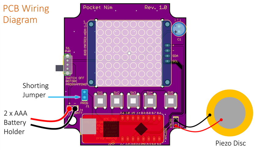

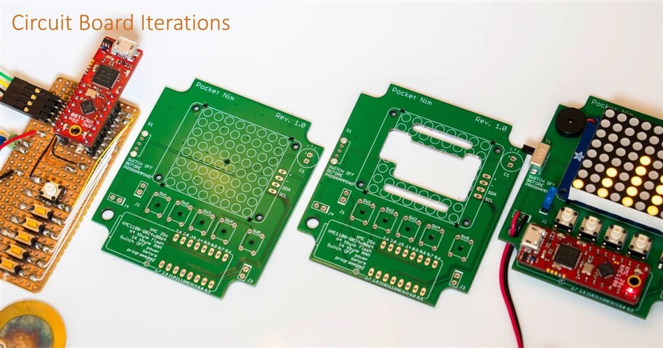

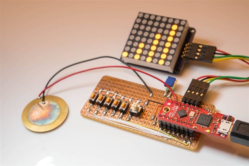

I wanted the project completed quickly, and I took a risk and ordered the PCB before I had all the parts. It turned out that the LED matrix board was a couple of millimetres too thick for the chosen enclosure! Some hobby parts like pre-built modules are not always well dimensioned in datasheets : (  So, I had to cut out the PCB to make the matrix board sit flush. My board also has a bodge wire as a result of the cutout going over a vital trace.
The attached PCB files are corrected, so boards made using them will not require any cutting.
PCB and Case Assembly

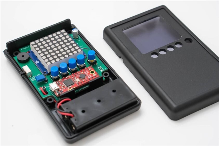

The easiest way to build Pocket Nim is to order a PCB using the files attached to this blog post. Any PCB factory like Elecrow will accept the files and for $5-10 plus postage, will provide around 10 PCBs.
The PDF file attached to this blog post was used to cut the holes.

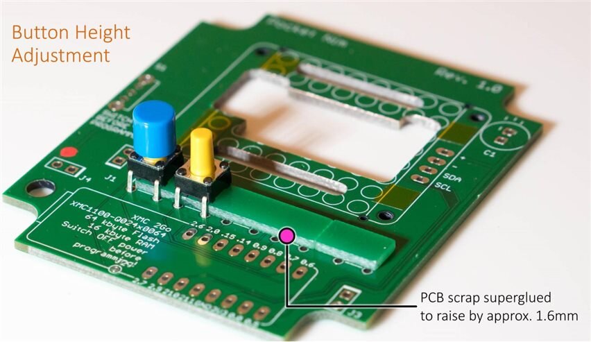

The power switch location needs some filing to make a notch. The display cut-out had a 1.5mm thick piece of translucent plastic fitted flush (anything thicker will not leave enough space for the LED matrix, because it is quite tall).
Matching caps for the push-switches were hard to find. Depending on what you use, the caps may need gluing. Also, check the height using the enclosure. If the buttons need raising, one way is shown in the photo below.

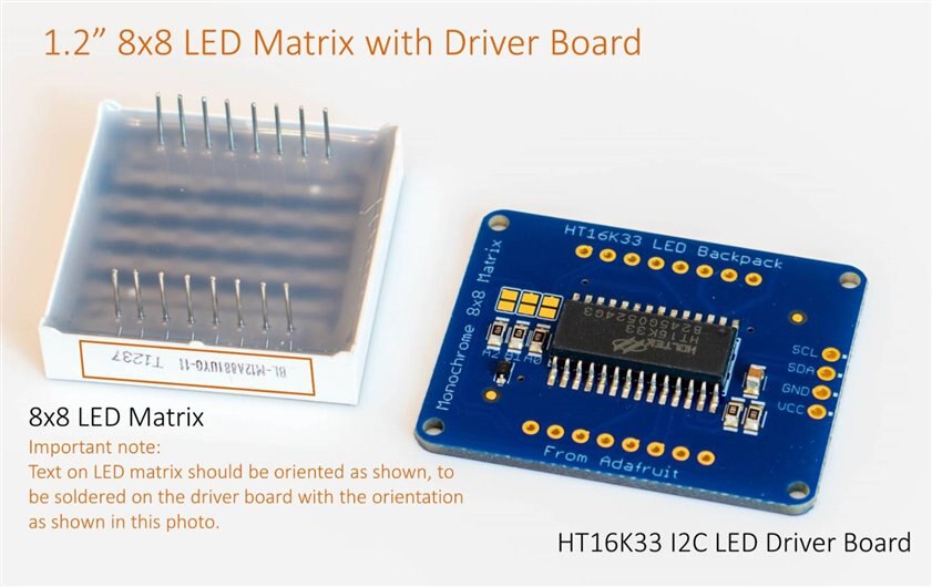

The LED matrix comes with a driver board. I used an Adafruit version initially but a drop-in replacement second source is available from Amazon and Aliexpress at $3 (if three are purchased – total of $9), the search term is keyestudio matrix module HT16K33. The Adafruit version needs the LED matrix to be soldered to the driver board in the correct orientation as shown in the photo below. The Keyestudio Aliexpress version comes entirely soldered.

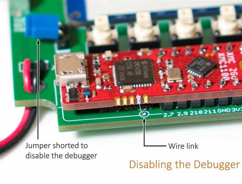

Disabling the debugger on the microcontroller board (to reduce power consumption for battery use) needs some care soldering a wire strand.
After assembly, the microcontroller can be programmed in-circuit if desired (see below); or it could be pre-programmed in advance, if children are going to be assembling it, because they may want to try it out immediately.

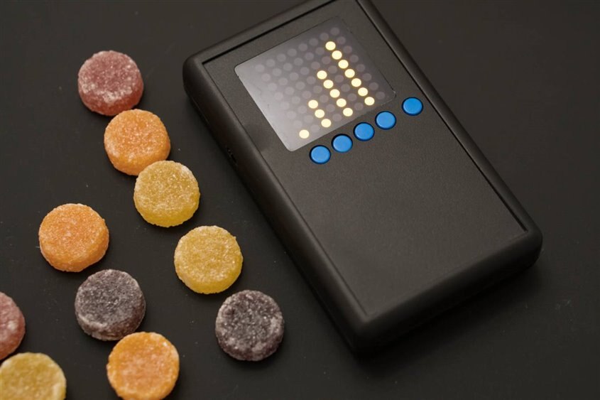

The final result, ready to play! Now that this prototype is ironed out, I will get the kids to solder their one, since they will enjoy that more.

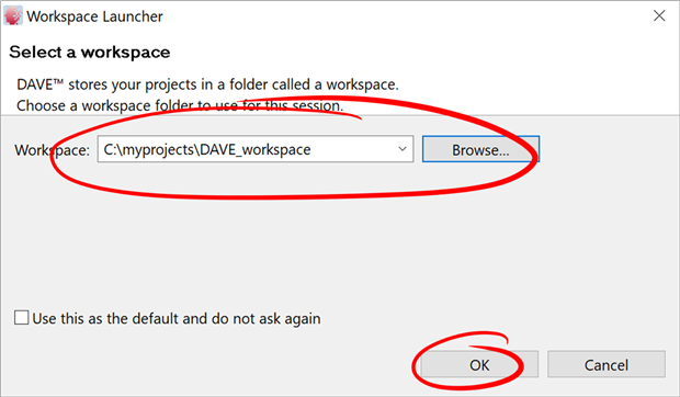

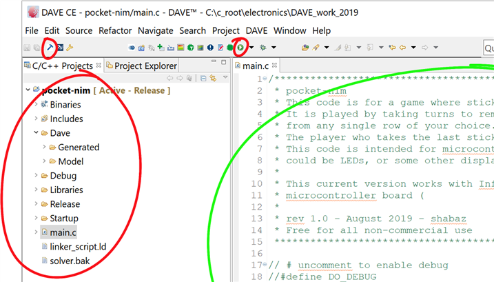

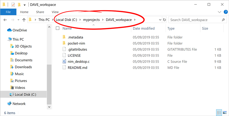

The microcontroller can be programmed in-circuit. First, download and install the development environment called Infineon DAVE.
Download the Pocket Nim code bundle from github, extract it somewhere. The extracted folder has a name like pocket-nim-master. Your entire path may be (say) C:\myprojects\pocket-nim-master. Change the name of the folder from pocket-nim-master to DAVE_workspace, so that it is more descriptive.
Run DAVE and choose that workspace folder when prompted.
You should see the project appear in the left hand pane, shown in red on the left here, and the code can be displayed on the right by expanding the project and double-clicking the main.c file. The two important icons, also shown in red, are the hammer icon for building (compiling) the code, and the run icon for programming the chip.
Ensure no battery is attached to Pocket Nim (or turn off its power switch), and that the Debug jumper is not shorted on the board, and then plug in a Micro USB cable and connect it to the PC.
After you have built the code (for the first time, go to Project->Clean to do a clean build but subsequently you can use the hammer icon), click on the run icon and within 15 seconds or so the code will transfer into the microcontroller and start running (it will be powered by USB).  The display will light up and the game will run. Note that the first time, DAVE may take longer, and it may prompt to upgrade the debugger software. Click Yes to that. In my case, I get an error (I’m running a slightly older version of DAVE software), but it seems to correct itself the next time I try to click on the run icon.
Once you’re happy with it all, unplug the USB cable and plug in the jumper so that the pins are shorted. This will disable the debugger and lower the current consumption to about 25mA. It is now ready for running from batteries.

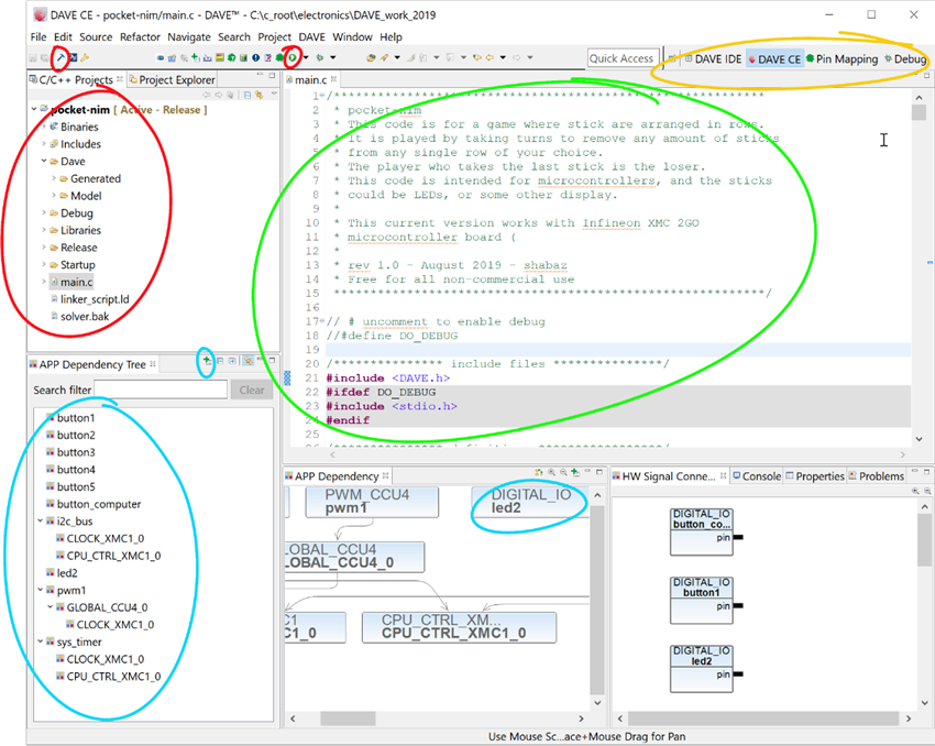

Working with the DAVE Development Environment
(Note: This section is not necessary to read to build or understand Pocket Nim. It is only useful if you’re keen to do your own software development with the Infineon board).

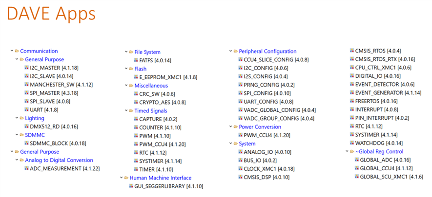

It is worth exploring Infineon’s XMC 1100 ARM-based processor and development environment called DAVE. I really like it. It comes with lots of automated code elements (known as DAVE Apps – see the list below) that can be instantiated for dozens of different purposes, such as I2C control, pulse width modulation (PWM) and timers, but also code elements for industrial purposes such as DMX or data encoding or even graphical user interface (GUI) creation. It is surprisingly easy to use.

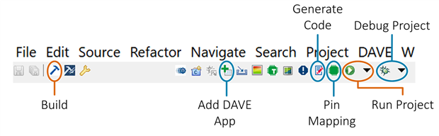

The following icons are used frequently. While coding, if you need a DAVE app, click on the Add DAVE App button as shown below, and then you can go through the palette of different apps, using the help button that also appears, to read up on each app before finally adding it to your project.
The screenshot below shows some of the key areas of the development environment. The top-right contains the perspectives, which are different ‘modes’ of using the IDE. The DAVE CE perspective is the one usually used to do your coding.
The DAVE apps that are added are listed at the bottom-right (circled in blue in the screenshot above). These are the DAVE apps that were used for Pocket Nim. Pocket Nim used Digital I/O, I2C, PWM and System Timer DAVE apps.
By right-clicking or double-clicking on these app instances in the APP Dependency pane, they can be renamed or configured. So, in the screenshot above, by right-clicking a digital I/O DAVE app was renamed to led2, and then by double-clicking it was configured as an output.

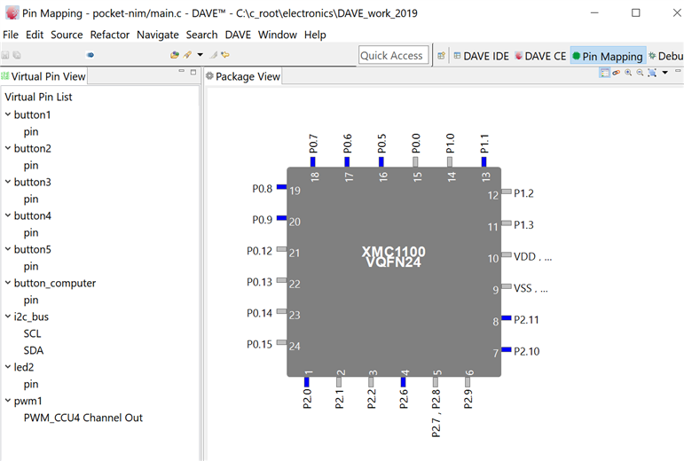

The Pin Mapping Perspective icon (shown circled in an earlier screenshot above) was used to display an image of the chip, and the app input or output is tied to a pin by right-clicking on the pin and selecting the app instance’s name for the pin.
After any DAVE app has been added, the system needs to be told to generate the source code for the app (the generated code of the DAVE app will then appear in files in the project files area, but it is unnecessary to view it to use it, because the help pages contain all the application programming interface [API] information required to use the DAVE app successfully). To generate the app source code, click on the Generate Code icon shown in an earlier screenshot above. The API can be then be used in your code. So, for the led2 example, I was able to type this into my code to turn on that output:

    shabaz over 7 years ago
    I got fed up never knowing what switch to use.. so I've collected up all the various ones I had, and finally organized them.
    They are all low-cost ones, so ideal for basic projects. Farnell part numbers are in the photo below too. The red circled one is a convenient power switch for low-power projects, the yellow circled one is good as a reset button on PCBs, I use that one all the time.
    The ones that suit typical round low-cost plastic button caps, are circled in green and blue. The button caps fit tight and slightly higher up on the green circled switches. The caps need gluing if used with the blue circled switches.
    For the green circled ones (Multicomp), the button caps are about 2mm higher than for the blue circled ones (Omron).
    For the ones with no circles, I have not found any low-cost round button caps that are easily available. (Round being more useful to me than square, since a drill can be used for the enclosure, rather than cutting out squares.
