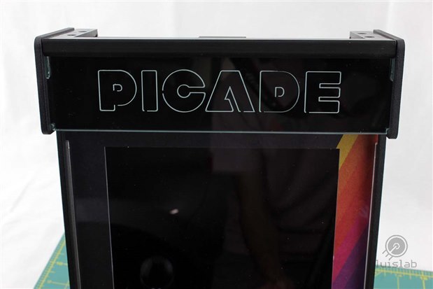

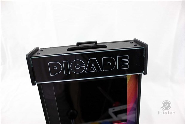

Not long ago, I got a Picade: a retro arcade machine built around a Raspberry Pi. Few seconds after appreciating the marquee, I saw an opportunity to improve the looks of it using Individually Addressable LEDs, so an LED edge lit marquee was born.

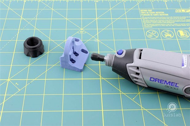

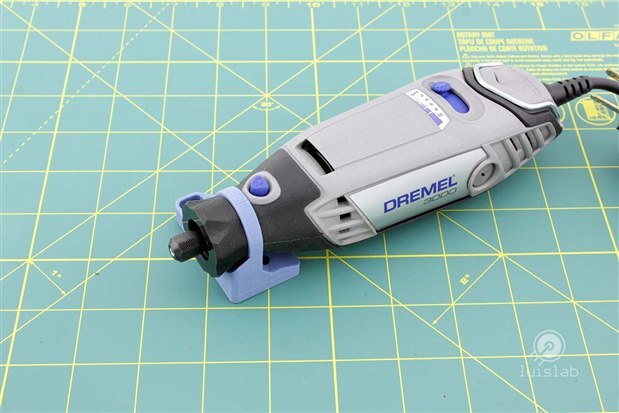

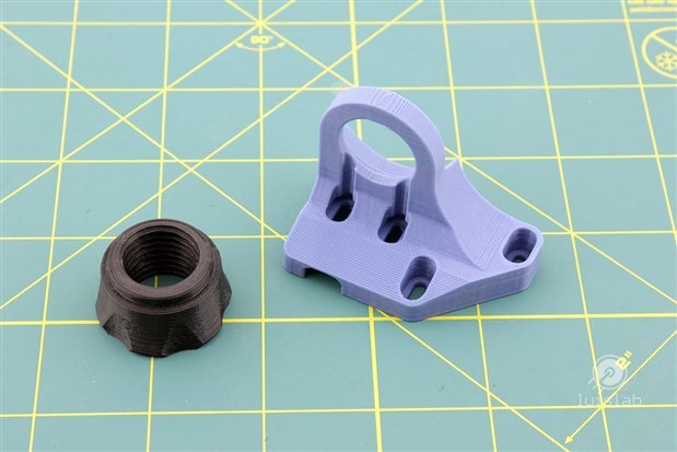

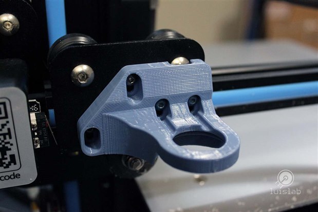

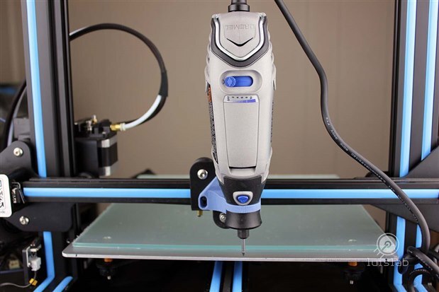

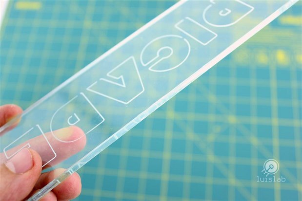

Since I don't have easy/cheap access to a laser engraver (or CNC mill/router) I ended up with an extra challenge, designing a mount for my Creality CR-10S 3D printer to fit a Dremel Rotary tool which to my surprise, worked very well!.
{gallery:width=960,height=768,autoplay=false} Dremel Mount for Creality CR-10S
Dremel Mount: Dremel Mount for Creality CR-10S

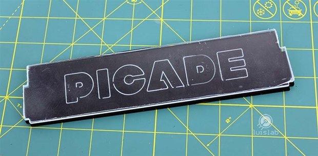

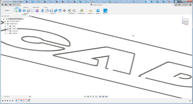

Engraving the PICADE Logo
I designed the Picade logo in Fusion 360 with just a trace of material 0.2mm tall -equivalent to the layer height of my 3-D print settings- and the same width as the nozzle diameter, this generated perfect results and thanks to this approach I didn't have to to use a different firmware and/or software on my 3D printer to use it as an engraver.
{gallery:width=960,height=768,autoplay=false} Engraving with Creality CR-10S
Picade Logo: Picade Logo in Fusion 360
Picade Marquee: Picade Marquee on 4.5mm Acrylic

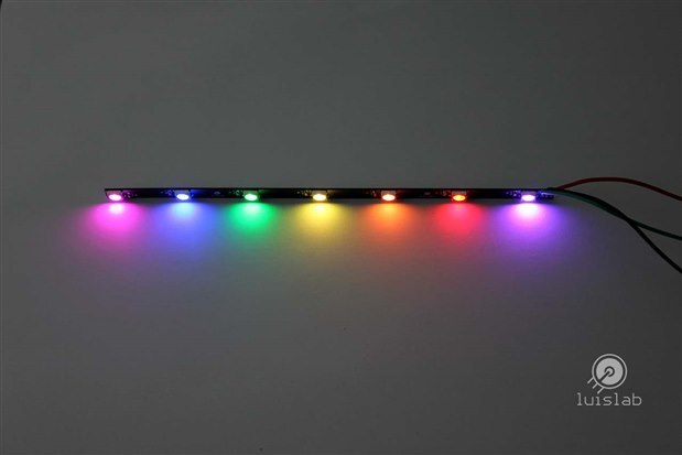

Electronics

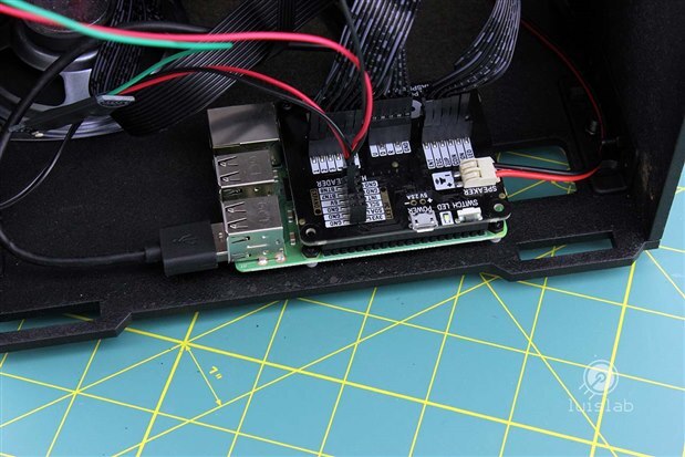

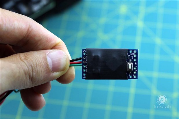

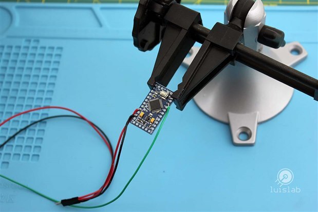

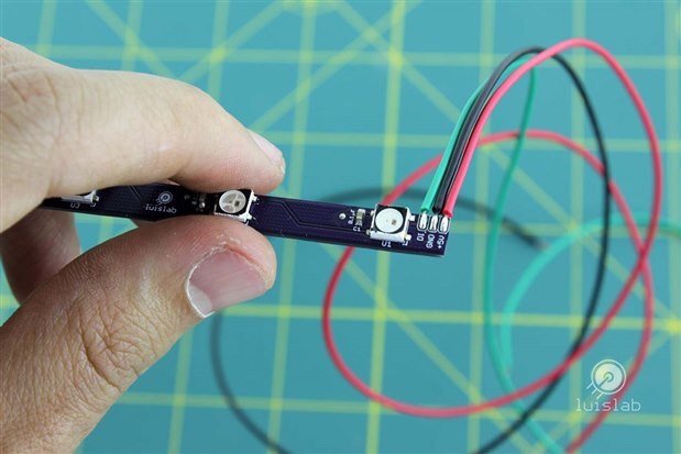

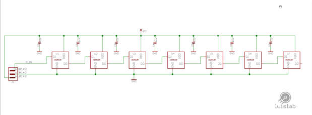

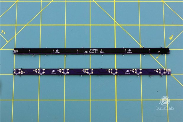

The electronics for the project are very simple. A custom made PCB with 7 individually addressable RGB LEDs (WS2812B) connected to an Arduino Pro Mini - 5V that will control all the light effects (Digital Pin 6). Everything is then connected to the 5V and GND pins of the Picade's Hack Header.
{gallery:width=960,height=768,autoplay=false} Picade Edge Lit Marque - Electronics
Picade Edge Lit Marquee: Custom made PCB
Picade Edge Lit Marquee: Electronics assembly
Picade Edge Lit Marquee: Testing the electronics
Picade Edge Lit Marquee: PCB Eaglecad
Picade Edge Lit Marquee: RGB lights schematic
Picade Edge Lit Marquee: Arduino Pro Mini - 5V
Picade Edge Lit Marquee: Arduino Pro mini - 5V
Picade Edge Lit Marquee: Connecting the lights to the Picade's Hack Header

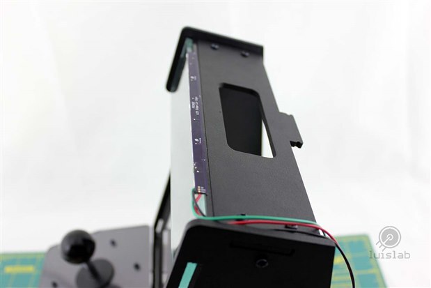

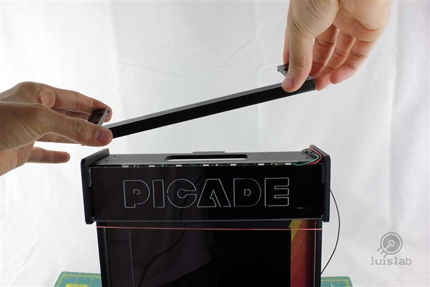

Final assembly

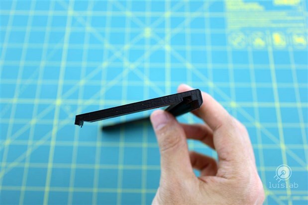

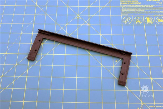

To cover the custom made PCB, I designed and 3D printed a black cover with room for routing the wires. It was designed to use the same mounting hardware used to tighten the top of the PICADE without any modifications.
{gallery:width=960,height=768,autoplay=false} Picade LED Edge Lit Marque Assembly
Picade Marquee: Engraved marquee assembly
Picade Marquee: custom made PCB assembly
Picade Marquee: Top 3D printed cover

Overall I'm very happy with the results, it looks amazing, in fact the lights are so bright that they can illuminate all the Picade without the need of external lights.
