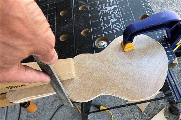

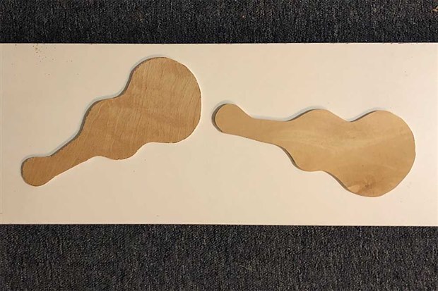

No time to do proper planning!  Just start building!  Cut out a pattern semi-freehand that fits the plywood:
This is the cheapest, crummiest plywood ever... Cut out the pieces and rasp them to shape:

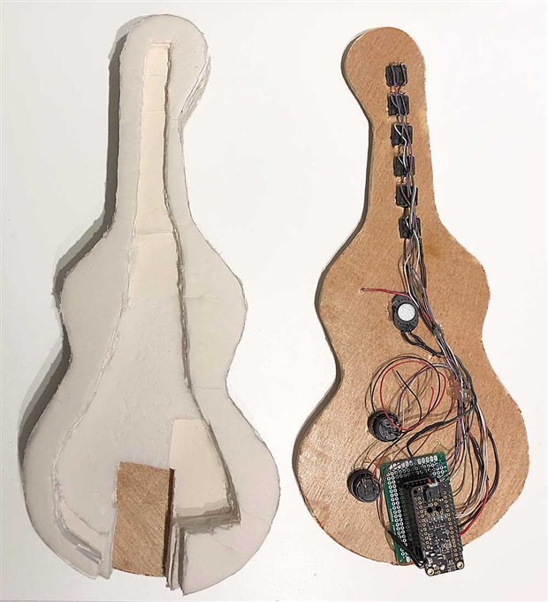

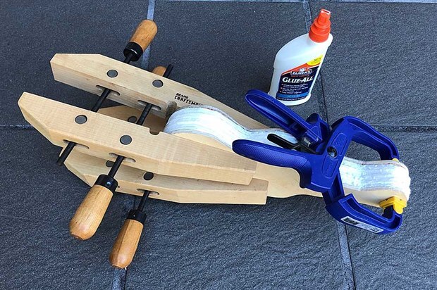

How to make the body? Could sandwich foamboard...
That is the crummiest material to cut to shape and work with ever... Glue and clamp:

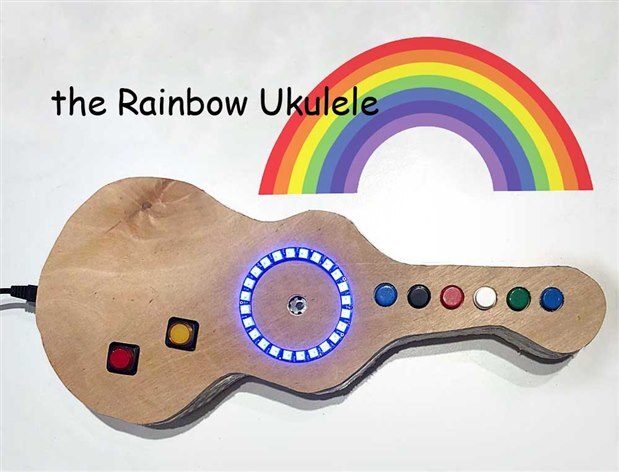

Soldered everything up and then hollowed out the interior with a box cutter and a kitchen knife.  Affixed the microcontroller, button switches, and speaker with hot glue and super glue.
The Feather M4 Express has a built in 100 mA Lipo battery charger which worked well and was easy to use.  There is room in the body for the battery and an on / off switch which is currently not used since I elected not to leave the battery in.  The demonstration unit is shown below:
Unfortunately for you the element14 rules require that a video be posted.  But I am going to spare you somewhat and not go through the whole barnyard menagerie.
Sorry for that... the 3 year old liked it :-)
