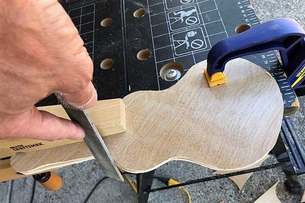

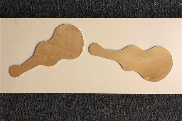

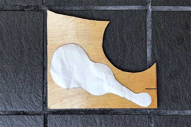

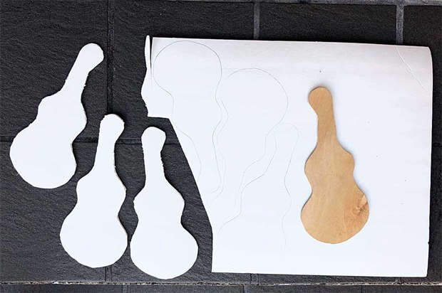

No time to do proper planning!  Just start building!  Cut out a pattern semi-freehand that fits the plywood:
This is the cheapest, crummiest plywood ever... Cut out the pieces and rasp them to shape:
That doesn't look too bad:

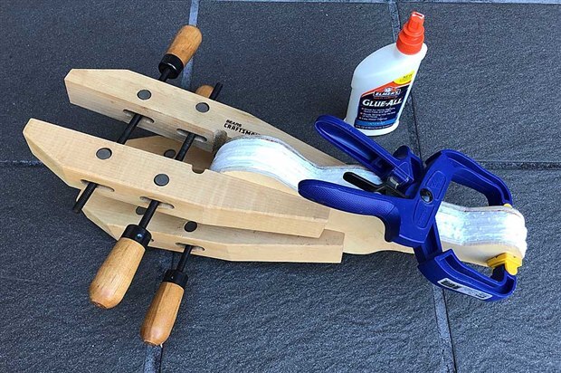

How to make the body? Could sandwich foamboard...
That is the crummiest material to cut to shape and work with ever... Glue and clamp:

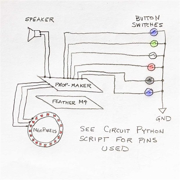

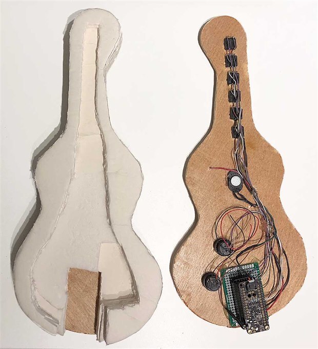

The Electronics
Very simple...
The pins used are documented in the Python script above and the board connections for Neopixels and the speaker are given in the Adafruit Prop-Maker documentation (links at end of blog).
Putting It All Together

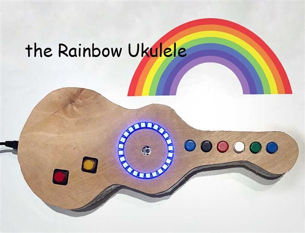

Soldered everything up and then hollowed out the interior with a box cutter and a kitchen knife.  Affixed the microcontroller, button switches, and speaker with hot glue and super glue.
The Feather M4 Express has a built in 100 mA Lipo battery charger which worked well and was easy to use.  There is room in the body for the battery and an on / off switch which is currently not used since I elected not to leave the battery in.  The demonstration unit is shown below:
Unfortunately for you the element14 rules require that a video be posted.  But I am going to spare you somewhat and not go through the whole barnyard menagerie.
Sorry for that... the 3 year old liked it :-)
Beta Testing
This was my first attempt to add music to a project and was a lot of fun.  I had a chance to show it to my granddaughter and she really enjoyed it.
One of the things she enjoys is picking out different sounds for it, adding them with my help, and then playing them back.  That is one of the things that distinguishes it from some commercial products.  Since this is more of a concept demonstration I did not leave it with her.  But since she seemed to really enjoy it I plan to revisit the project and investigate the following improvements:
