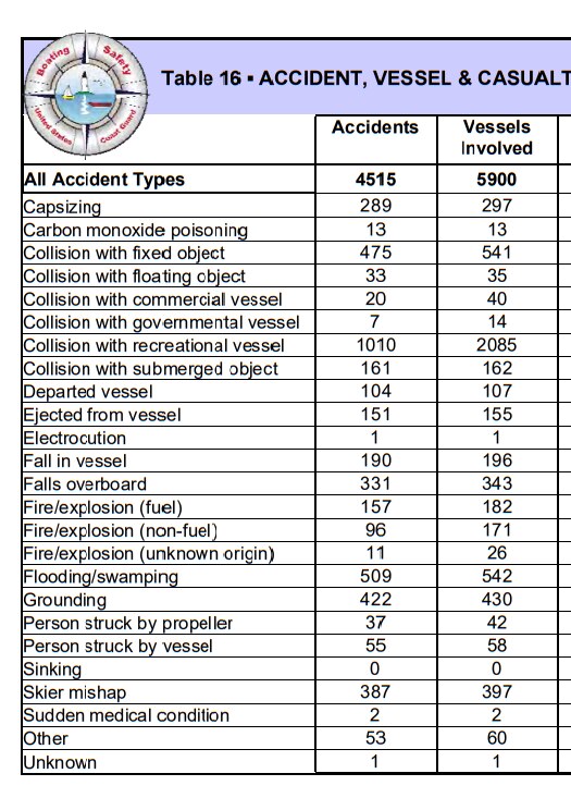

  • beacon_dave
    0 beacon_dave over 5 years ago in reply to kmikemoo
    "... If 22% are boat on boat, what are the other 88%?  Boat vs. land...?"
    Let's look it up shall we ?
    2012report.pub (uscgboating.org)
    • Reject Answer
    0 dougw over 5 years ago in reply to beacon_dave
    Skier Mishap?
  • beacon_dave
    0 beacon_dave over 5 years ago in reply to dougw
    boat wanting to go one way and water skier wanting to go another way, often doesn't end well, especially if it involves something pretty solid (or hungry) in-between...
    (bonus points I guess if it somehow involves an alpine skier...)
    • Reject Answer
  • kmikemoo
    0 kmikemoo over 5 years ago in reply to beacon_dave
    beacon_dave  This is fascinating.  Inferring from the Vessels Involved column, there are more Boat on Boat incidents than the collision category captures.  Using Flooding/swamping as an example, up to 33 of those could have been caused by another boat - a near miss (almost collision) that AI might have been able to prevent.
