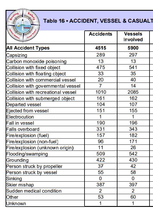

    0 kmikemoo over 5 years ago in reply to beacon_dave
    Interesting abstract.  I wonder what they classify as a "small object"?  Boat?  Buoy?  Rock?  If 22% are boat on boat, what are the other 88%?  Boat vs. land?  Great concept.
