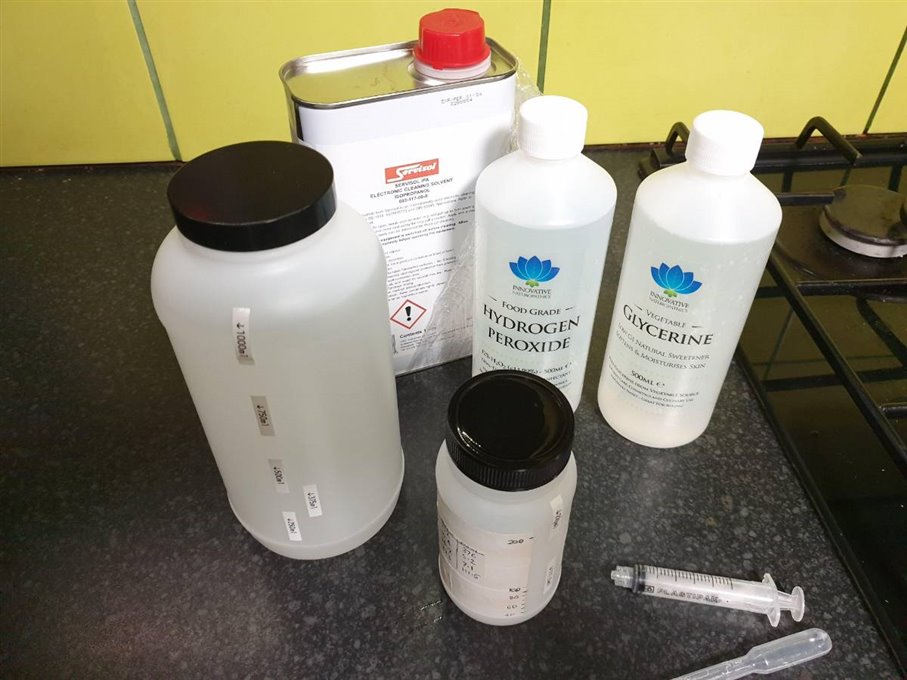

    This isn't really a project,I created it the other evening, downloadable here:
    https://bit.ly/38PpXcY
    It's a hand sanitizer calculator (based on some WHO guide). I'll put it as a JavaScript app somewhere with input error-checking, but for now it's in a Excel spreadsheet format.
    The green cells are inputs. The yellow cells should be left as they are, and the gray cells are the outputs.
    No liability of course.. but hopefully it's useful.

    First attempt.. the plastic bottle on the left contains the result. It is very watery (only faintly thicker than water) but when applied on hands, it does leave them smooth like as if there's a film of very light moisturiser.
    So it may still need hand-cream applying after the hands are dry - not sure yet.
    I didn't have a suitable measuring cylinder (and forgot I had some graduated beakers), hence all the calibration marks craziness on the bottles. Also a 10ml or 20ml syringe would be helpful. And smaller bottles to distribute the result in different rooms in the home (and kept out of reach of children).
    I made 1 liter of the hand sanitizer, but a better option would be a 5 litre can of isopropanol5 litre can of isopropanol, and that way there's enough to last a few months, even if others nearby need some because hand wash seems to be unavailable in a lot of stores. Not a lot of Hydrogen Peroxide (H2O2) and glycerine is required, so those bottles will last for many tens of litres of resultant product. The H2O2 (it is a 12% bottle, it comes in different strengths) and Glycerine were available from Amazon. Syringe from pharmacy, although I did have to explain before they'd sell it.
    Also, I'm wondering if it is possible to use the same formulation to wipe down surfaces i.e. make it multi-purpose - I'll will try to find information on that. Because anything 'antibacterial'-labeled like kitchen cleaning products are in high demand too.
    To be honest, this has been a normal procedure for me for 10 years - whenever I go to a hotel, I wipe down the TV remote and all door handles/locks, kettle, etc., with (store-bought) hand sanitizer. A bit like wiping down a room after a crime but in reverse image Maybe others do the same too I cannot be the only one! : )
