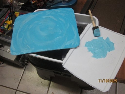

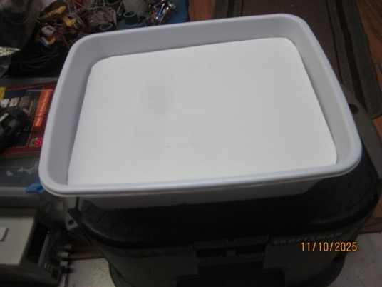

  • Wood spacers with washers glued on top allowed a foam board top to go overtop the controls, held in place with small magnets.

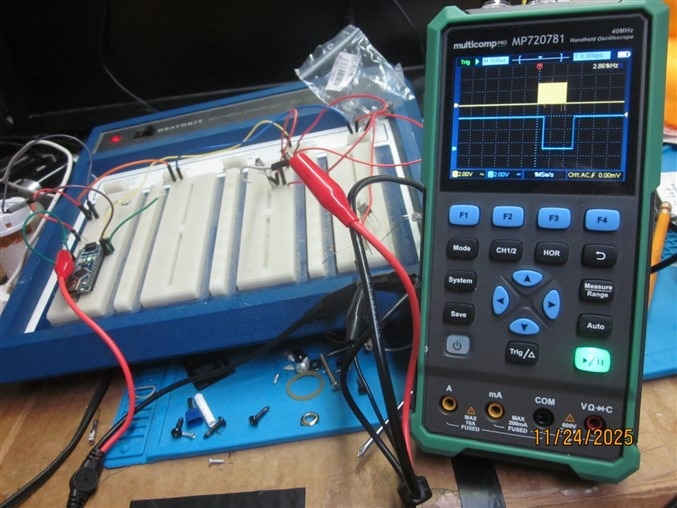

I had build an IR LED  38kHz Burst pulse stream transmitter on another Arduino Nano to test the prototype receiver circuit. I was thinking to build a "Laser Pulse Cannon" to mount on the chase PixyCam tank.
After testing and writing some Arduino code, found the POWER ON button on every TV remote in the room must use a burst pulse to wake up the TVs, and they also triggered the VS3818 Arduino code.
