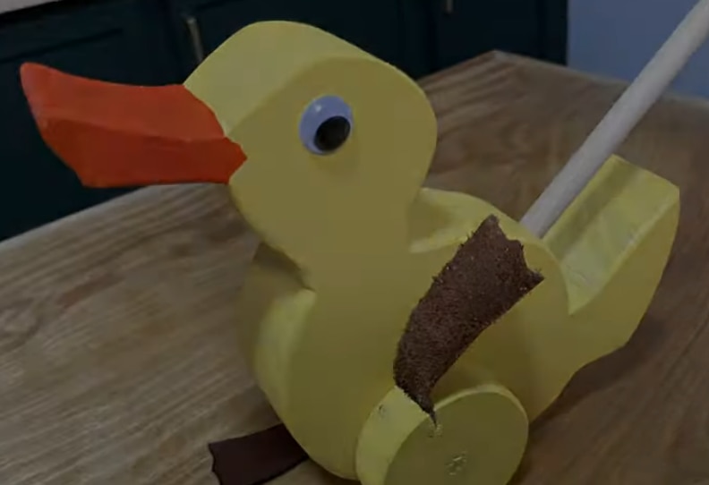

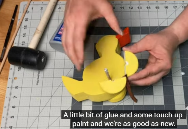

    Ok, so which part of the instructions did you not understand ?   Joy
    How To Make The Duck Push Toy
    oops ! a bit heavy with the hammer there...
