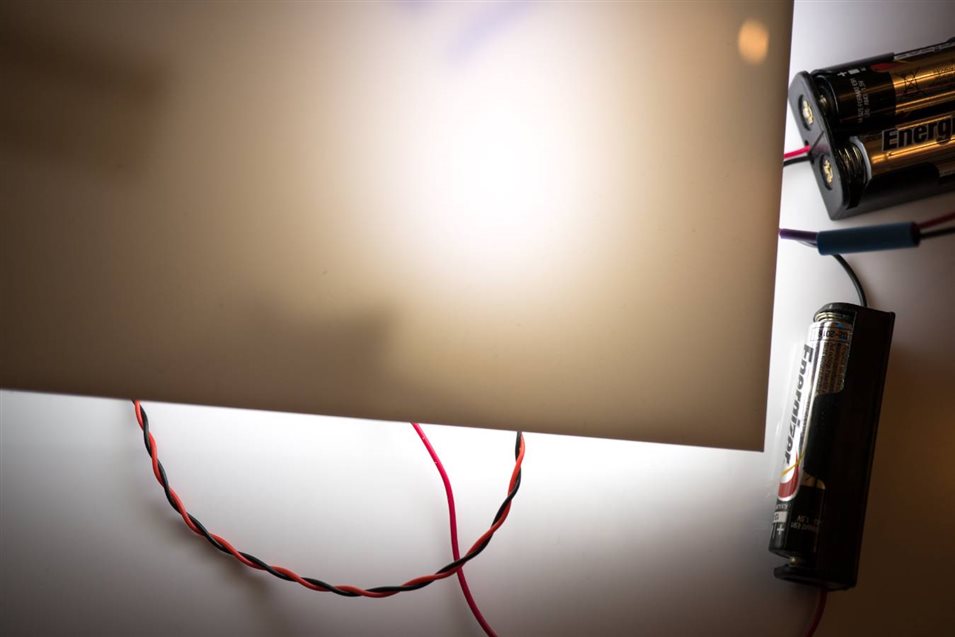

This project offers over 260 lumens of light output (approaching some typical LED lights for home use) and is powered by three AA or AAA batteries, or a single lithium ion (Li-ion) cell.
It was built from scratch in about 4 hours, using whatever I had handy.
Here it is not shown, because the light is very bright! I held a 5mm thick sheet of perspex in front of it.

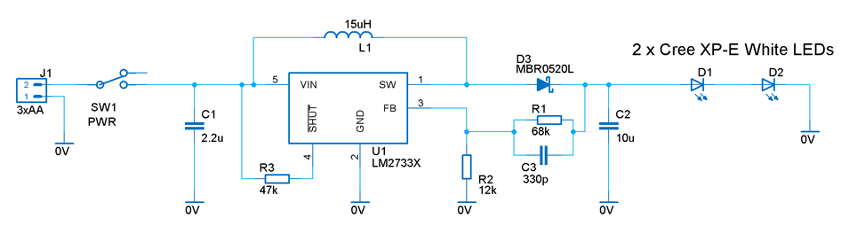

The Circuit for Flashlight 'A'
The circuit is shown here. Basically it just consists of a DC-DC converter using a Texas Instruments LM2733X chip. The LEDs are Cree XP-E, and are quite bright!
There are two LEDs, for double the power : ) For ease of reference this circuit will be called Flashlight 'A':

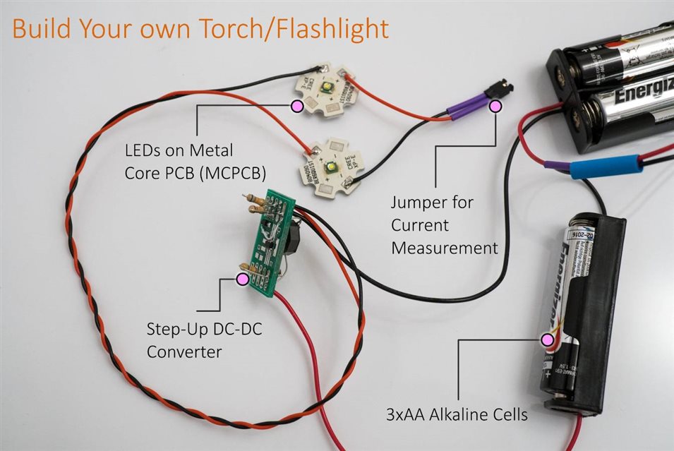

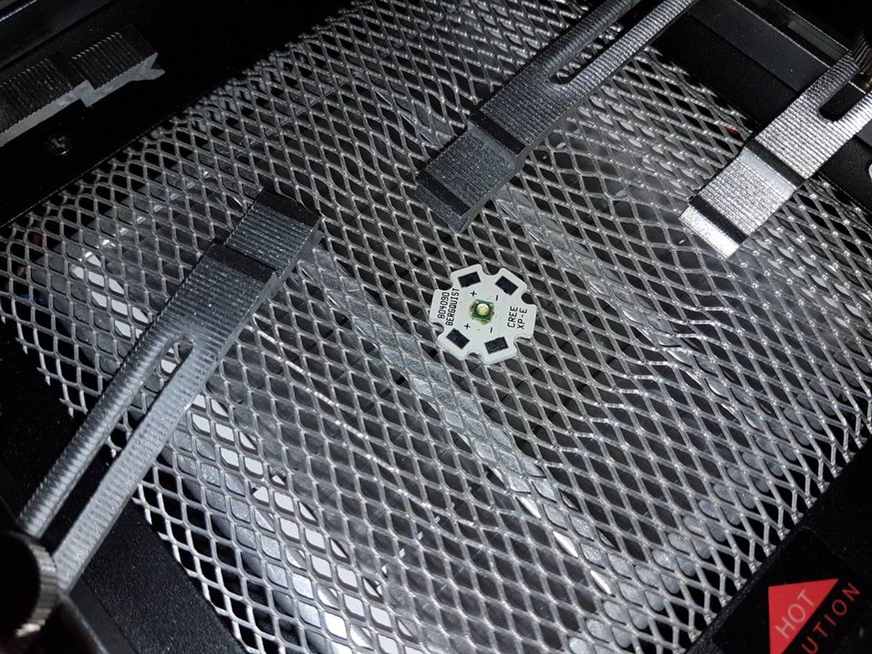

For the LEDs, I had some metal core PCBs (MCPCB) made by Bergquist. I've had them for about a year or two and done nothing with them. I put some solder paste on them and then put the LED on top, and put it on top of a heat source. The heat source that I used was a pre-heater, but people have been known to use all sorts of cooking methods (note: solder and flux is toxic, don't use stuff that you use for cooking food!).
Next, I built up the rest of the circuit using a SMD prototyping board and normal hand soldering methods. It would be nice to build this on a custom PCB eventually.
Testing It
I have not done much testing, I just checked current consumption for now. The current drain from three AA batteries is about 1.05A, so they should last a couple of hours. The current through the LEDs is approximately 450mA. The datasheet states that the output is 107 lumens minimum at 350mA, and at 450mA it is expected to be about 125% of this value according to the charts. So, this means more than 260 lumens should be output for the two LEDs, but it will also depend on the LED temperature. With the metal core PCB it should be very easy to bolt on a heat sink if needed to keep them cool. For use as a flashlight it could also be good to have some dual reflectors for focusing to a tighter beam.

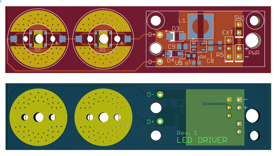

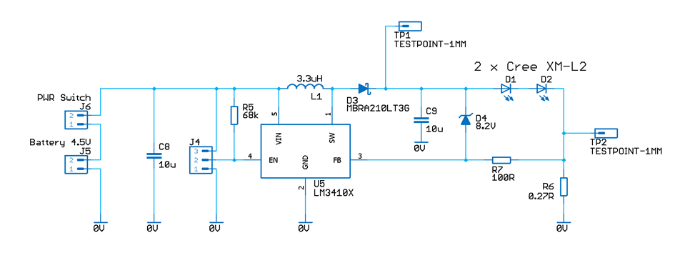

The next iteration of the design, called Flashlight B, uses a TI LM3410XLM3410X part, and dual Cree XM-L2 LEDs. It is discussed in the comments below. Here is the schematic:

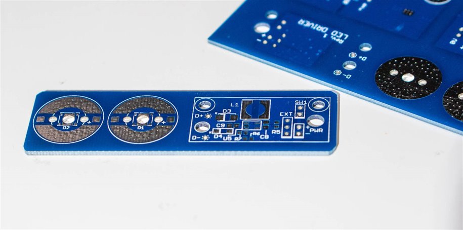

A PCB was drawn up for this (the gerber files that can be sent to any PCB manufacturer are attached to this blog post, just before the comments section. The filename is export-flashlight-b-rev1.zip) :
The PCB is composed of the driver, and two circular areas where the LEDs will go. The PCB can be used in a single piece, or alternatively the PCB could be cut if it is desired to locate the circular LED areas somewhere else in an enclosure.
The boards arrived:
They have not been assembled or tested yet.. bookmark to watch this space!

    shabaz over 9 years ago +4
    I made some progress with a dual XM-L2 design, I'm hoping this one is around 600 lumen ballpark, with just slightly more current consumption (perhaps 1.1A at 4.5V). This uses the TI LM3410X driver chip…

    I made some progress with a dual XM-L2 design, I'm hoping this one is around 600 lumen ballpark, with just slightly more current consumption (perhaps 1.1A at 4.5V). This uses the TI LM3410X driver chip. There is also an 'Ext' port on the PCB for connecting up an Arduino or whatever in future, for providing dimming.
    For the LEDs, I've made a 3mm hole for soldering a copper rod, if it works then this is a super-cheap (and easy) way of getting the heat out.
    The rear is just copper, for a bit more cooling. The two side holes are for attaching the reflector (the same part number as mentioned before), it isn't designed for this LED, but it looks like the XM-L2 dies are at identical height to XP-E, and the angle for illumination spread is near-identical too. To make the reflector fit, the hole at the rear of it will need to be drilled to 5mm.

    Whilst convertors can be efficient, this particular circuit isn't (doesn't matter at all - it's a quickly thrown together Geeky Gadget, not a carefully considered production design). From Shabaz' figures
    input power: 4.5V x 1.05A = 4.725W
    power to LEDs: 6.2V x 0.45A = 2.79W
    efficiency = 2.79/4.725 x 100% = 60%
    Some of that is possibly down to the fact that it looks like it isn't regulating directly but is operating on the internal switch current limit.
    But you're right - that's still better than the conversion from electrical power to light.
