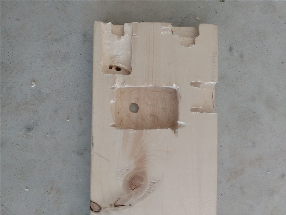

I still needed a spot for the components, so I proceeded to grind away wood with a Dremel tool I have, as well as drill holes for LEDs, till I was covered in a fine snow of wood flakes. For the LEDs I used a drill to make holes and held them in place with hot glue. Here is the result:
This reminded me I need to improve my wood working skills and made me wish I had a router. Grin I had a can of left-over wood stain, so I stained the wood a beautiful dark oak color,

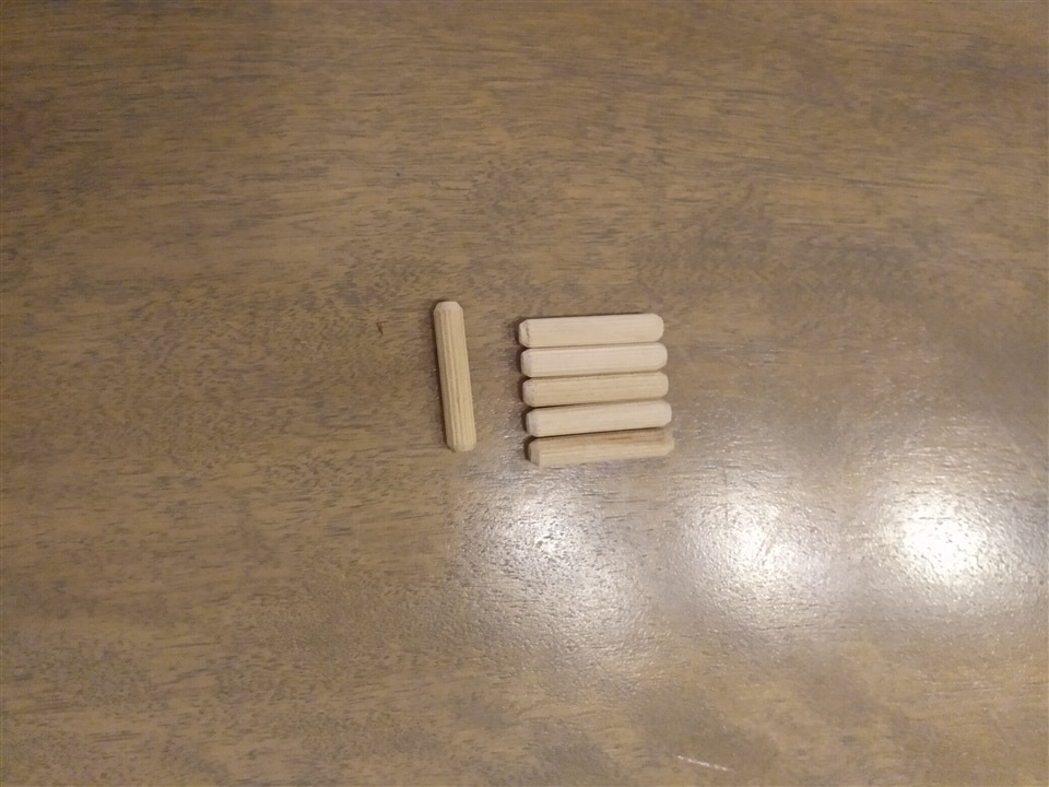

I then sealed the two halves together with small wooden pegs, to make a sturdy 2"x4" (5.08mm x 10.16) that can be taken apart again in an emergency.

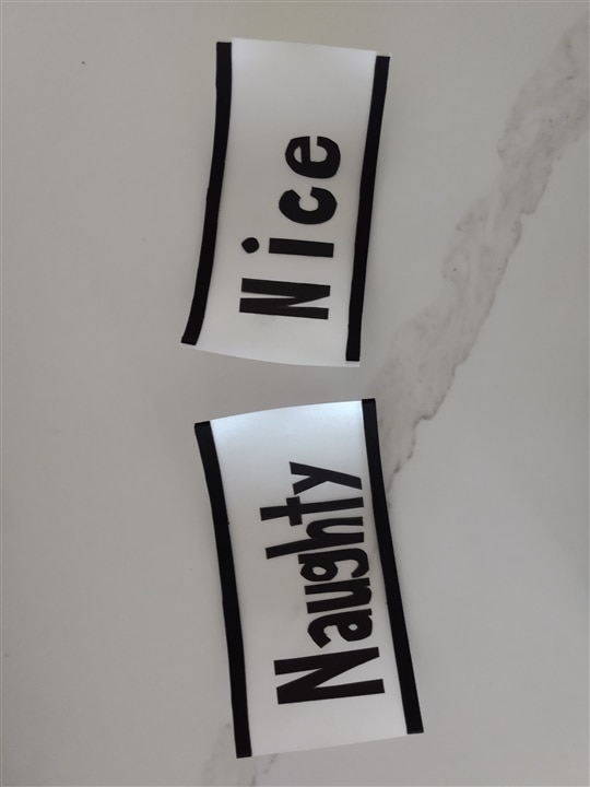

Last thing to do is way to attach the front words of the sign to the base. I made two removeable signs with black cardstock letters on the front that Leds could shine through and added support with foam strips. I considered using magnets to hold the words on the front, but ended up going with wood slots made of scrap wood to hold the cards:
