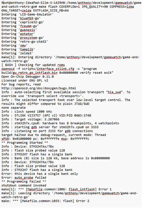

    Persichini 6 months ago
    Looking for help. I feel like i have a partial brick. just can't figure it out.
    So i followed the guide, got everything working, but there was no dual boot. So i tried to flash a different version to get it. now i'm stuck. the LCD won't turn on, and i get these errors.
    Info : STM32H7 flash has a single bank
    Error: this device has a single bank only
    Error: auto_probe failed
    ** Programming Failed **
    this seems like it should be fixable. please help
  • Persichini
    Persichini 6 months ago in reply to Persichini
    shabaz 6 months ago in reply to Persichini
    Hi,
    I don't know the answer I'm afraid, but I searched around and someone on a webpage mentioned that it may be due to the Flash chip not being soldered properly (e.g. it might have made intermittent contact the time it worked for you).
    Another person mentioned that they were using an unpatched (i.e. non- special build) version of OpenOCD to cause that error.
    I don't know what tools or what level of soldering work you did, but if you are unsure, then if you have a detailed high-res photo of the Flash chip pins from all sides, perhaps that may reveal something.
    If you're confident the soldering went well, I cannot see what the issue may be unfortunately.
