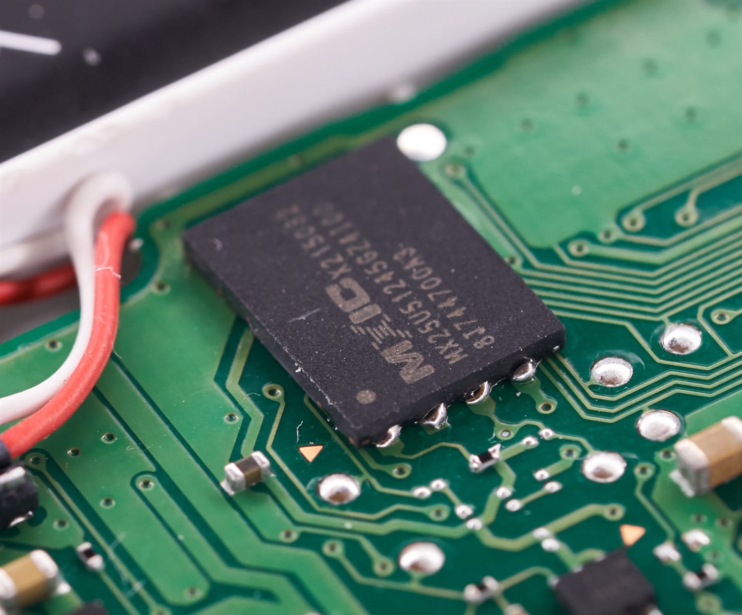

6. Swapping out the Flash Memory for Higher Capacity
The Flash memory chip ideally needs removing, because it doesn’t contain a lot of storage space for many games. The photo below shows the default memory chip installed in the green game.
To remove the chip, with the battery still disconnected, apply some low-melt solder to all the pins on the chip, and by heating up pins on both sides one row at a time with a soldering iron, it should be possible to get enough heat into the solder that it remains melted long enough that the chip can be lifted off (with no force) with tweezers. Note that there are extremely tiny passive components close to the memory chip, and you shouldn’t accidentally touch them with the soldering iron. Some of the parts are so tiny it may be almost impossible for the user to fix them if things go wrong. If you think there is a risk of touching them, then cover them up with Kapton tape! The red game for instance, has two resistors very close to the memory chip, and if one of them gets removed or damaged, then the battery level indicator will be incorrect, because the two resistors form a potential divider, supplying the battery voltage level to the analog-to-digital converter (ADC) inside the ST microcontroller:
The pads are cleaned up with desoldering braid, and then cleaned with isopropyl alcohol and a brush and/or cleaning wipe. The photo below shows what the board (in the green game) should now look like, with as much of the low-melt solder now removed as possible, and the board cleaned.
Here is a photo of the pads where the memory chip was desoldered in the red game:
Apply normal solder paste to the pads, place the new memory chip on top (use the triangle marker on the PCB to orient the memory chip correctly), and then heat each pin/pad area with a soldering iron with a bit of solder on the tip. Apply flux later if necessary and re-heat any pins if you think they need a touch-up. You could also use thin solder wire instead of the solder paste, but you will need flux too, since thin solder wire may have too little flux.
After the new chip has been soldered on, clean off the flux. Be careful not to let any liquid flux or IPA fall into the LCD area (I held the board inverted to prevent that), in case it causes a mess further into the game device that cannot easily be cleaned up.

    Regarding the memory chip, a hot air tool is quite a steep skill to learn. Personally I used a normal soldering iron, but with a tiny, very fine bit (a pointy tip, J-bend would work quite nicely). To remove the old memory chip, the "low-temperature solder" works extremely well, it will allow all the soldered joints to soften simultaneously long enough to lift the part off (with zero force; if there's even the slightest force, don't lift, becase that will tear the PCB pads). Then clean up with desoldering braid, followed by a tiny amount of isopropyl alcohol on a tissue to scrub it clean, then use normal solder to tin each pad lightly, then place the new memory chip on top, and there will be just enough gap for the pointy tip to get right into the corners to solder the connections down.
    All the photos in the blog post show the results with a normal soldering iron, with a very fine soldering bit (0.4 to 0.6 mm or so pointy tip, J-bend).
