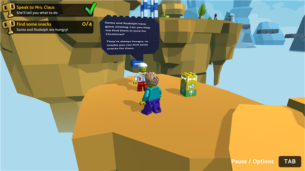

It's always good to find a project that can push you in the right direction when learning new stuff, so I thought long and hard about whether I could combine Christmas, Lego, game development and of course some electronics. Luckily, as I was busy getting to grips with the basics of Unity, I came across their Lego Microgame tutorial. I can thoroughly recommend it. The Lego brick concept wraps nicely as an abstraction over some of the Unity processes. It's a great way to simplify game development and to give you some of the building blocks to create on your own. There are a few oddities if you do know a bit of Unity. It can be tricky when some of the stuff that you know works without the Lego components no longer works as you expect. All in all though - it's a good starting point.

Whilst I could describe in detail the process of creating my own Lego game, I feel you'd be better served by following along with the excellent guide that Unity and Lego have created. Suffice it to say that you can do the following:
  • You can build with existing Lego bricks in your game.
  • You can build more complex Lego creations in Bricklink Studio and then import them.
  • You can add behaviour to your models with action bricks or scripts.

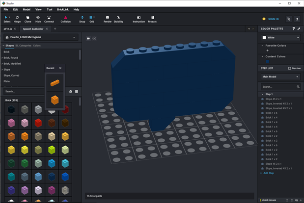

Creating models
As you can see, you' re not stuck with just using the Lego bricks provided in the base microgame example. The main two custom creations I added were the speech bubble that appears over Mrs. Claus' head when she speaks to you, and a nod to elf14 for the second level. You may notice the "move" brick attached to the bottom of the speech bubble when I used it in the first level. This is the easiest way to program interactions. When the player gets near to the proximity brick that you can see to the right of Mrs. Claus, it triggers the speech bubble to swoop in and appear over her head.

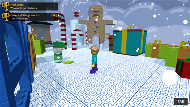

I did hit some small issues along the way. The scripts created by Lego don't attach well to smaller Lego pieces - like a minifigure sized carrot for Rudolph - as they're designed to work with studded bricks. The scripted Lego functionality can also interfere with standard Unity functionality. For instance, I tried adding trigger colliders to Lego models but the functionality provided by these in vanilla Unity was overridden by Lego scripts. Multiple steps in a level (such as "Speak to Mrs. Claus" and "Find some snacks") and are handled for you, but this means that it's hard to reveal hidden parts of the level as you go along. To be honest these little issues seem fair enough considering what you get out of the deal. I just know I can do this easily in "baremetal" Unity.

So, here's a video of my 9-year-old son playing through the game. When he first played, the appearance of Santa and Rudolph was a surprise. He was so focused on the game he didn't notice me sneaking in to place them behind him. When he got to the end of the game he wasn't expecting a video game to cross over into the real world.
However, these days all kids seem to want to be a YouTube gamer superstar, so at his request we re-recorded the video and you now get the benefit of his in-game commentary instead. image The game was created for him and his brother, so who am I to say which version was better! (It was the first one.)
If you'd like to try the game yourself it's available as a WebGL game at https://play.unity.com/mg/other/webgl-s6j Can you make it to the end? Can you spot the fairly obvious elf14 Easter egg in the second level? (Surely it's the wrong time of year for Easter eggs.) I thought about being a bit more subtle by just adding 14 elves but it got a bit crowded in there!
