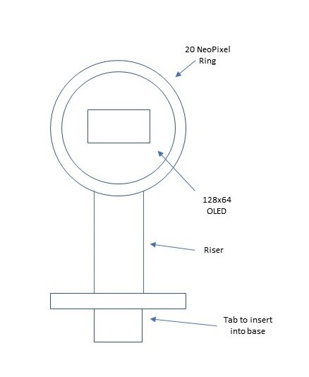

I was not going to do a Holiday project but there hasn't been a lot of joy and there has been a lot of stress this year, so I thought that it would be good to do something simple and colorful to lift our spirits.
I recently got an Adafruit QT Py and a NeoPixel LED ring that I thought I could use to make a simple lighted Christmas ornament.  I'm going to add a 128x64 OLED display and use the capacitive sensing built into the SAMD21 to select different color patterns for the NeoPixel ring.
Here's a sketch of the concept:
I'll also print a base to hold the QT Py.  I'm still in the proto stage so I'll use a breadboard initially.  I need to figure out what I'm going to use for the capacitive touch buttons.

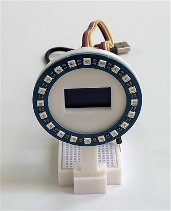

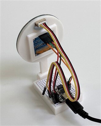

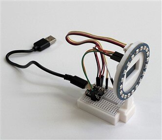

Here's my first pass.  Hopefully it will evolve over the next few weeks.  I still need to add the capacitive sense buttons and possibly a small speaker for sound.  And to clean up the wiring.
Demo Video
A short video that shows the OLED and NeoPixel ring working.

    Very nice Ralph!  The prints turned out nicely and I like the combo of protoboard holder and display ring. Well done!
