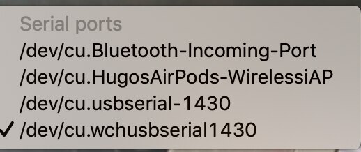

However, I am having some difficulty flashing on the bootloader(as you can see that's what I'm trying to do)
I also flipped the ICSP header upsidedown image
(The eye is connected to D13)
I'll be installing the CH340 driver later today. If that assists with flashing bootloader.
A friend informed me I'd need an oscilloscope to probe RX and TX.
Ah. I really need to buy one now LOL
(or maybe win image, but the chances of that aren't too high. I mean... WOOF)
USB WORKS
USB
WORKS
You can see my ugly fix in the image below:
It consists of a 0.1uF(100nF) cap from 3.3 to GND.

    CH340 drivers are really painful sometimes. Yeah, at least I mean SI Labs ones are more straightforward. CH340: you plug it in, sometimes it works, sometimes it doesn't. SI labs: if it's not detected,…
