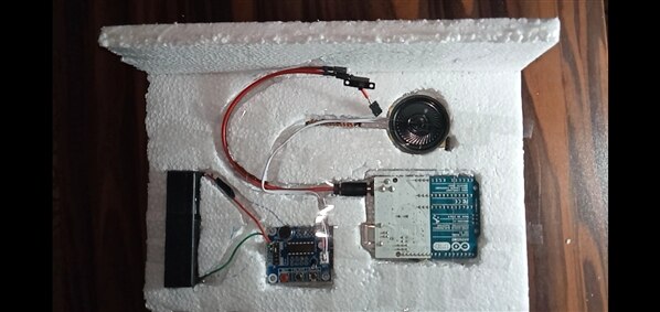

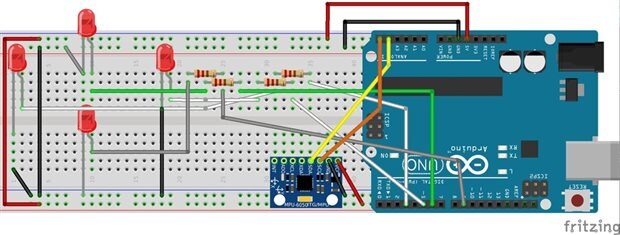

Hello Everyone, My name is Harji Nagi. I am currently a third year student studying electronics and communication engineering from Pranveer Singh Institute Of Technology, Kanpur(UP).I have a keen interest in robotics,arduino,Artificial Intelligence and Analog electronics.
Today I made a greeting card specially for Holiday Special 20 which consist of  MPU-6050MPU-6050 for controlling 3 LEDs on the card. The gyroscope is programmed to detect the tilt in the card and then turn on the respective tilted LED and ISD1820 a small Voice Recorder and Playback module that can do the multi-segment recording.application with the adjustment of the on-board resistor.
re:
1) Arduino UNO R3
2) MPU-6050MPU-6050
3) 3*LED's
4) ISD1820 Voice record and play chip
5) 3*100 ohm resistors
6) Thermocol
7) Female and male headers
8) Wires
9) On/Off Switch
10) 3.7V Battery for ISD1820 chip
11) 8V,1.5 Amp Battery for Arduino
12) Chart Papers
13) Double Sider Tape
14) Fevicol
15) Stickers
Connection Diagram for controlling Leds:
LEDs :-const int frontLed = 3;const int bottomLed = 5;const int rightLed = 6;const int leftLed = 9;
And for the MPU-6050MPU-6050. The MPU-6050MPU-6050 must be connected to ground and 5V+, after that connect SDA to A4 (analog 4), SCL to A5(analog 5).
You are done with the connections now.

Connections for ISD1820:
ISD1820 must be connected to ground and its operating voltage is 2.2V to 5V.And connect the speaker at sp+ and sp- .
Press the red button(rec) to start recording the song,voice or any greeting message.It will record not more than 20 seconds.
After recording press Playback to play the recorded message.

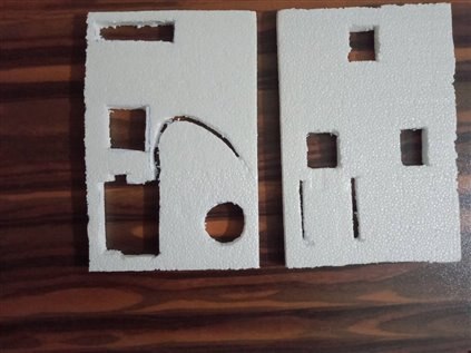

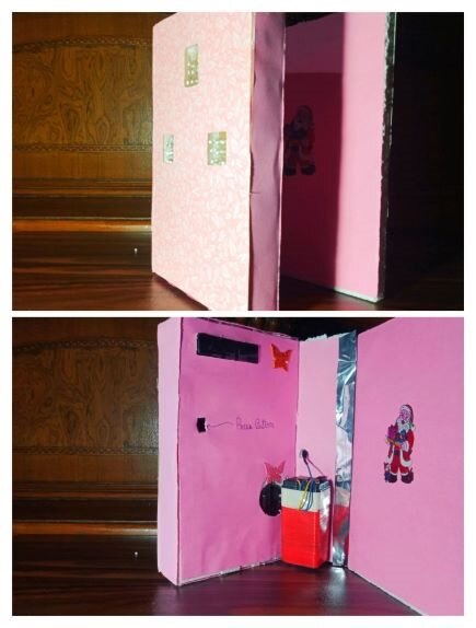

                                                        Assembling:
                                                                                Step 1:

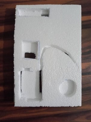

Take two thermocol Sheets and slice it according to size of the components to be placed on it.
                                                            Step 2:
After slicing thermocol it will look similar to it.
                                                            Step 3:
Now placed the thermocol on each other and stick it either with glue or with double sider tape.

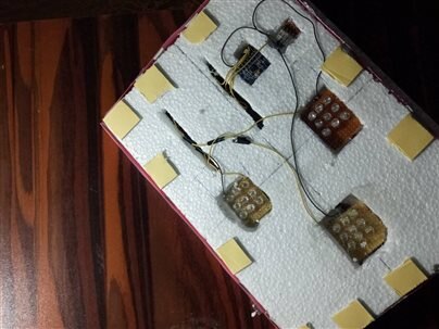

                                                            Step 4:
Now place all the electronic components and do the connection according to given schematic diagram.And apply cello tape so that the components remain fixed in their position.

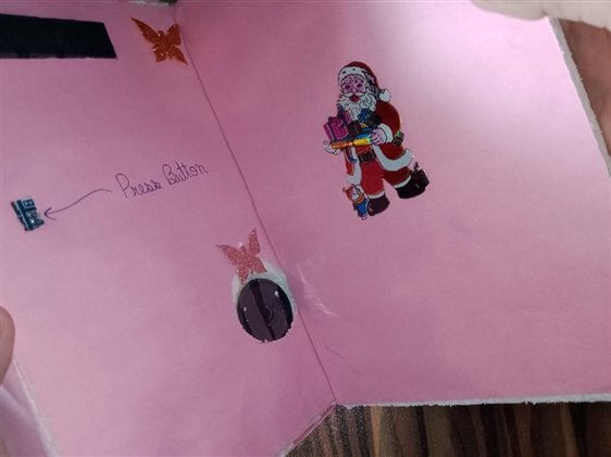

                                                              Step 5:
Now cover  these components with the help of colorful chart papers and decorate it to make it more attractive.
                                                                      Step 6:
Now the card is ready .On switching on the power button the gyroscope detects the tilt in the card and then turn on the respective tilted LED and on pressing the playback button of ISD182 ,it plays a melodious song .Please watch this vedio for more information.I hope you enjoyed this tutorial.
WISH YOU HAPPY NEW YEAR
    dubbie over 5 years ago +2
    Harji, A great project with some good ideas as well as being nicely packaged. The idea to use LED arrays to indicate orientation is interesting and I might have to think about how I might be able to use…
  • seharfatima
    seharfatima over 5 years ago +2
    Nice and innovative project with good use of gyro sensor in greeting card .I will apply this concept in my future projects. And all the best for the contest results(•‿•)
    shabaz over 5 years ago +1
    Hi Harji, Interesting and well-documented project! It was interesting to see your results with the sound recorder board - I'll have to order some of those sometime to experiment with them : ) Incidentally…
  • harjinagi
    harjinagi over 5 years ago in reply to seharfatima
    Thanks Sehar for wishes and compliment.
  • seharfatima
  • harjinagi
    harjinagi over 5 years ago in reply to shabaz
    Hi Shabaz,
    The Atmel processor chips have built-in positive and negative clamping diodes on all the I/O pins that do offer some protection from ESD type events.
    But  for safety,I provided isolation tape under and over all components including ISD1820 and Arduino.I don't have much wires, so probably taping them too will do as shielding and doesn't generate a lot of static electricity .image
    And as seen in the picture the base of the Arduino is kept opposite  from polystyrene and cover the base with isolation tape and chart paper so i hope it will not cause any damage to my Arduino   .
    And thanks for positive response.
    Hi Harji,
    Incidentally, the white board you're using, doesn't it generate a lot of static electricity? It looks like 'expanded polystyrene'. If it does, be careful when you remove the electronics, in case it damages the Arduino.
    Harji,
    A great project with some good ideas as well as being nicely packaged. The idea to use LED arrays to indicate orientation is interesting and I might have to think about how I might be able to use that concept in future projects.
    Dubbie
