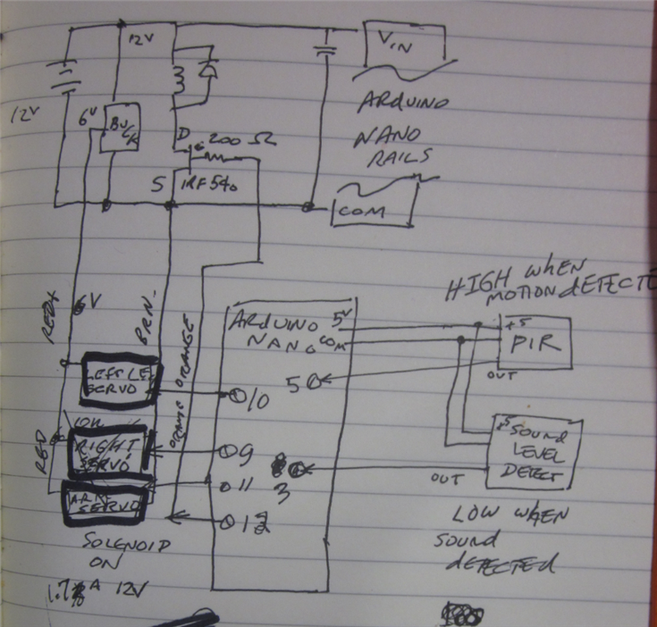

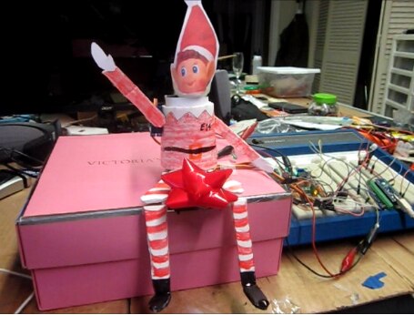

Nothing is more fun and jovial than a happy Christmas Elf sitting on a gift, waving to you...except watching him lose his head when you catch him being naughty.
The story:
The naughty Elves like to peek inside very personal Christmas gifts.
The naughty elves are also really sneaky.
Once someone gets in his viewing range, he kicks his legs, waves his hand, and acts totally innocent and nonchalant.
Actually, the Elf is sweating bullets on the inside, butterflies in his belly, behaving jittery and nervous.
If you see thru his innocent act and shout at him to behave or startle him, he loses his head...it goes flying.
It's actually pretty funny to see an elf lose composure.
This project is the animatronic Elf.
If you get in proximity of him sitting on the Victoria's Secret box, the PIR activates, he flutter kicks his legs, and he waves to you.
If you yell at him to behave or startle him, the sound sensor triggers , a solenoid activates, and his head is launched and he loses his head.
Watch the action on You Tube and details on the build.
https://youtu.be/W00JnFMU6eU
The schematic
The Arduino Code:

    shabaz over 5 years ago +3
    Hi Gary, I'm speechless, that is a cool elf. Was not expecting the head flying off!

    dubbie over 5 years ago +2
    I like the concept, especially as animatronics are almost robots right! A pity the head doesn't shoot off a bit more forcefully. Maybe I could use something like this to keep the cats from doing their…
