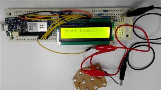

2. Hardware
2.1 MKR1000
2.2 LCD1602 panel
2.3 LED lights
2.4 Arduino Creator Cloud
2.5 thingspeak API for publishing data and SNTP time service

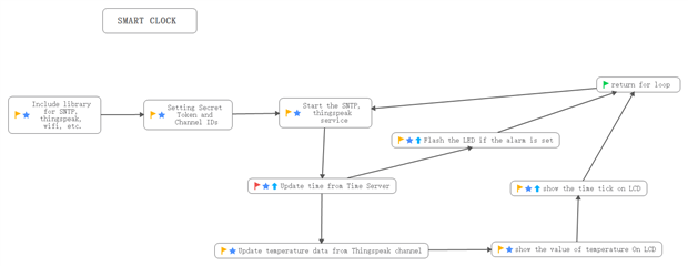

3. Program Flow Chart
Here is flow chart shows how the MKR1000 can get access to cloud services.

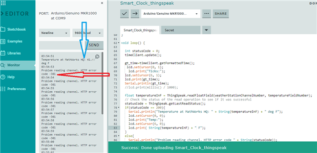

4.1 There have been many types of arduino IDEs, the arduino create Cloud is by far the best one, log into https://create.arduino.cc/editor/ , you can get your IDE panel and standard library without downloading from web anymore.

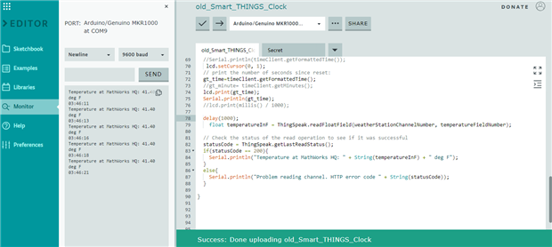

4.2 The debuge console and Serial Monitor shows the running mode of the program.
In this screenshot, it can be seen that the thingspeak channel is connected, but later the link is lost with http error code -301.
4.3 Here is the code.

    Serial.println("Problem reading channel. HTTP error code " + String(statusCode));

5.1 Here is how the smart clock wiring

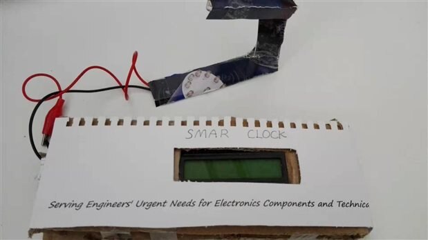

Then, Put it into one case and tag Smart Clock. The leds hide in one mini desklamp, left red/black wires out.
