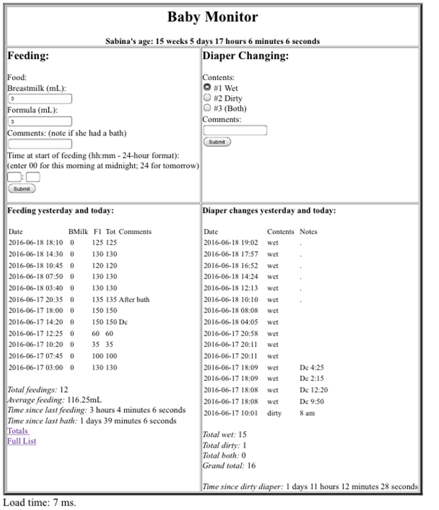

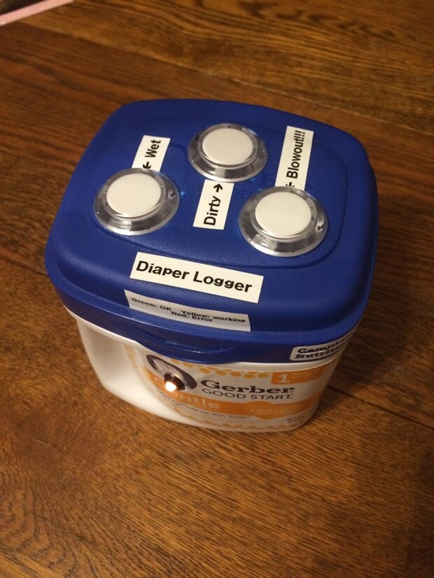

I'd like to share the diaper logger that I created when my daughter was born. This is my entry to the Home Automation monthly contest.
I was looking for a project to work on and my wife said "I just need help with the baby". So naturally, I set about creating this beauty. Anyone who has had a newborn can understand what sleep deprivation can do to a person. Having a newborn also means spending a lot of time talking about the specific contents and timing of a diaper; as they can be an indicator of the health of the baby. Having just myself and my wife we quickly found that keeping up with the baby was very difficult, and when we would take over 'shifts' for each other, we would sometimes forget to communicate when the last diaper was given. There had to be an easier way...
I think I slammed this entire project together in about two weeks. It uses and Arduino ProMini along with an ESP-01 wifi module. There is a very simple three-button interface to log what kind of diaper was found. An RGB LED gives feedback to the user. When the buttons are pressed, the Arduino wakes up, connects to the ESP-01, establishes WIFI connectivity and opens a TCP port to my server. It sends a message over containing the diaper status, the goes back into deep sleep mode. During each stage, an RGB LED will glow to show the user what it is up to. The server is my computer in the basement running a C# program which is part of my larger home automation system. It logs the diaper messages to a SQL database. I also run Apache web server for a web interface from a computer or smartphone. The web interface provides much expanded functionality like the ability to view diapers from the last two days in a list, and a another section for logging each feeding - how much food, what kind of food, and what time.
I fittingly used a baby food container as the enclosure, and added three arcade buttons from Adafruit.
This was my first battery powered project, which was a really fun learning experience. I wanted to see how low I could get to extend the life of the system. I think I succeeded here as I was able to get through one baby on one set of batteries. I think it was about 170 button presses over maybe six months.

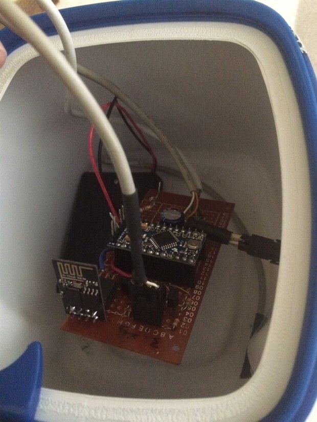

The Hardware
I chose the combination of two microcontrollers for a few reasons. I used an ESP-01 wifi module and an Arduino ProMini 3.3V 8MHz version. The ESP-01 is very cheap at about $5 and can add a WIFI interface using a simple serial port. It sadly lacks enough IO for what I wanted, and since I was already sleep deprived watching a newborn, I didn't want to mess around with learning to program a new board (although I have since learned it would have been pretty easy; and I could have used a Huzzah if it was available at the time). The Arduino ProMini was picked because it seemed well suited for a low power application. It is also inexpensive at about $10. The 8 MHz version of the ProMini uses less power than the 16 MHz version. The 3.3V board means it works easier with the ESP-01 which is also 3.3v logic level. It comes with an onboard voltage regulator which means the batteries plug right into it; but does not feature a USB to Serial like the Uno - instead an FTDI header is used to program it. Fortunately since this extra FTDI hardware is not on the board, it also consumes less power.
To run the ESP module, the Arduino uses a transistor to cut power on and off as required. When the Arduino validates the button push (SW debounce), it turns on power to the ESP-01; links up and sends the message, then cuts power back off. This way there is zero current drain from that module. I also tri-state the Arduino output to turn off the transistor; so there is no power required to hold it off.
There isn't much else for hardware other than some biasing resistors and decoupling capacitors.
Outputs: LEDs were on pins 3,5, and 6. The ESP-01 power was pin 2 of the Arduino ProMini.
Inputs: The three buttons were on pins 10, 11, and 12.
There was also the serial connection between the Arduino and the ESP which was simply TX --> RX and RX <-- TX.

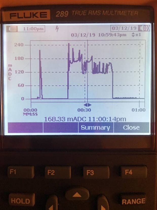

So the board went from a baseline of 4 mA consumed during a Sleep() to 0.104 mA. And the current consumption through the rest of the cycle was also reduced.
If a AAA battery is 1000 mAh, then I have 4000 mAh available. If sleeping, the system could run for a theoretical 38,461 hours or 4.39 years consuming 0.104 mA (**If my math is correct - someone please chime in if not!**). If I roughly guestimate that it takes 37 seconds (per my meter) for a complete button press cycle, and I average the current at about 100 mA for that 37 seconds; we get 1.02 mA consumed per button press; or roughly 4000 button presses. Even at 200 mA per button press that would be about 2 mA consumed so roughly 2000 button presses. My testing seems to point that my math is off by one or two orders of magnitude as I got roughly 1.5 years and 170 button presses, but there isn't a guarantee that the batteries were good to start with as I used them all through the test and development cycle.
This image shows the power readout which is demonstrated in the video at the end of the post.

Here is the website which displays the diapers on the right hand side. The "notes" column shows a period "." for all entries done via the Smart Dirty button. This is PHP script which is hitting the SQL database and doing some very basic formatting.
