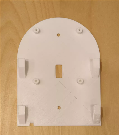

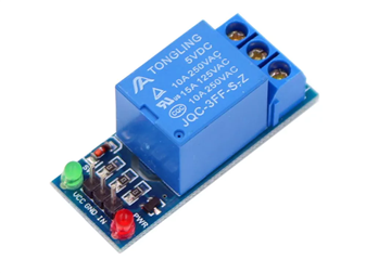

Step 3: Wiring the relay and 3D printing & assembling the case.
First, we connect 5V from our MATRIX Voice to VCC, the ground pin from our MATRIX Voice to GND, and GPIO pin 0 to IN to match the relay.js file.
Then, we open up our office light switch. Before starting this part, we flip the breaker which powers the light switch. That way there is no electricity running through the wires and we avoid any shocking accidents!
Once we have unscrewed the switch from the wall we disconnect all 3 wires from the switch. We only need the 2 live wires so we use electrical tape to cover the green ground wire.
Now that we have the 2 live wires from the wall, we wire them to the relay as shown below.

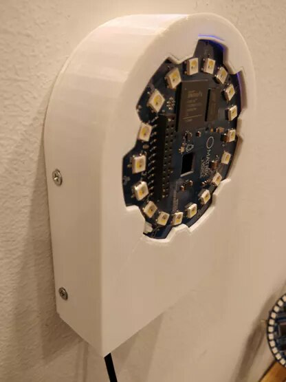

Alfred then 3D prints the same case he designed for his house.
We put it all together and voila, we are on our way to becoming a smart office! Now we just need 6 more of these babies.
