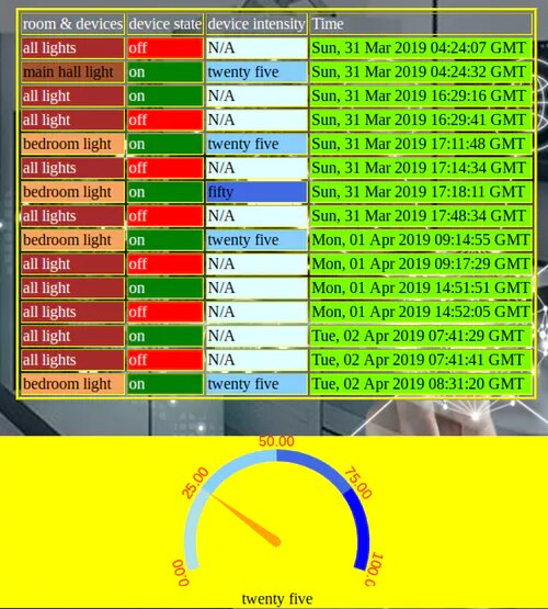

Home automation allows us to control household electrical appliances like light, door, fan, and so on. Home automation not only refers to reduce human efforts but also energy efficiency and time saving.
The aim of the project is to implement home automation using Raspberry Pi, Matrix Voice and Snips platform. In this project, Raspberry Pi is connected with Matrix Voice via GPIO pins and all the five lights (such as bedroom, kitchen lights) which we are controlling through voice command are interfaced with expansion GPIO pins of Matrix Voice. We are providing input(voice command) through Matrix voice mic and taking output (response) as light on/off from GPIO of Matrix Voice.

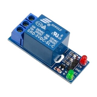

4. 5V Relay single channel ==> $4

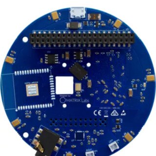

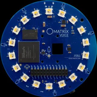

The Matrix Voice is a development board for building sound driven behaviors and interfaces. It is an user-friendly tool for simple to complex Internet of Things (IoT) voice app creation. It comes under two versions
1. Matrix Voice version
2. Matrix Voice ESP32 version
Both versions of these boards run the same on a Raspberry Pi, however, the Matrix Voice ESP32 version has the option to run standalone by programming the ESP32 module.
Here I am using Matrix Voice.

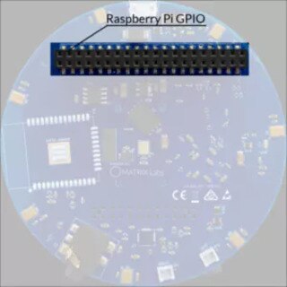

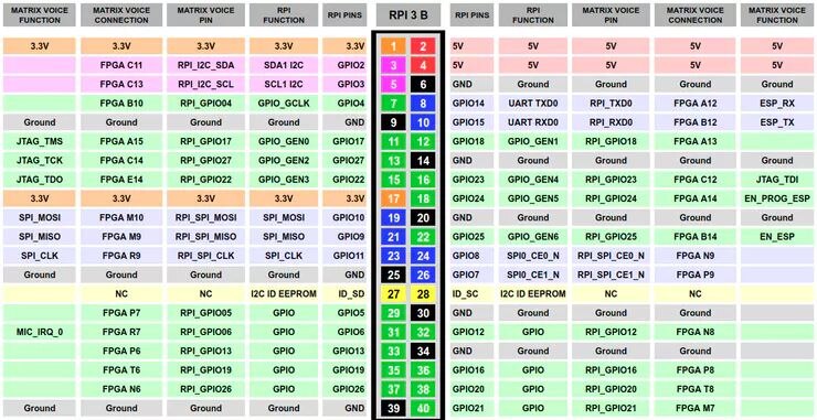

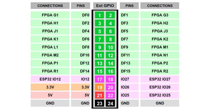

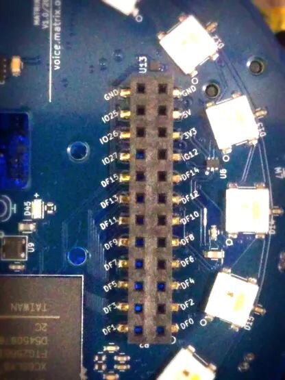

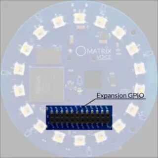

Matrix Voice expansion GPIO
DF## pins are equivalent to GPIO## pins.
Raspberry Pi GPIO
image  image
Note:- The expansion GPIOs on the Matrix Voice are not connected to the RPi GPIOs. The expansion GPIOs mostly come from the FPGA.

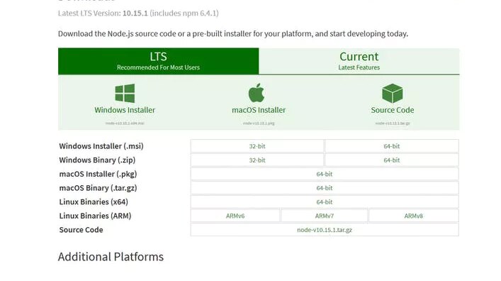

Before starting installing make sure you have installed NodeJS and npm
1. To install NodeJS, go to NodeJS and download Linux binaries(x64) of version 10.15.1
and then extract it with
tar -xvf node-v10.15.1-linux-x64.tar.xz
cd node-v10.15.1-linux-x64
sudo cp -R * /usr/local/

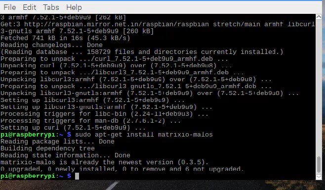

1. Add the Matrix repository and key.
curl https://apt.matrix.one/doc/apt-key.gpg | sudo apt-key add -
echo "deb https://apt.matrix.one/raspbian $(lsb_release -sc) main" | sudo tee /etc/apt/sources.list.d/matrixlabs.list
Matrix repository for Matrix HAL
Update your repository and packages.
sudo apt-get update
sudo apt-get upgrade
2. Install the the Matrix Core packages.
sudo apt-get install matrixio-malos
sudo reboot
Install the the MATRIX HAL packages.
sudo apt-get install matrixio-creator-init libmatrixio-creator-hal libmatrixio-creator-hal-dev
Reboot your device.
sudo reboot
3. To install ZeroMQ
echo "deb http://download.opensuse.org/repositories/network:/messaging:/zeromq:/release-stable/Debian_9.0/ ./" | sudo tee /etc/apt/sources.list.d/zeromq.list
wget https://download.opensuse.org/repositories/network:/messaging:/zeromq:/release-stable/Debian_9.0/Release.key -O- | sudo apt-key add
4. JavaScript setup
Create a node project folder in the home directory of RPi
cd ~/ mkdir js-matrix-core-app (whatever name you want)
cd js-matrix-core-app
npm init

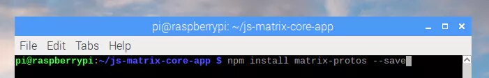

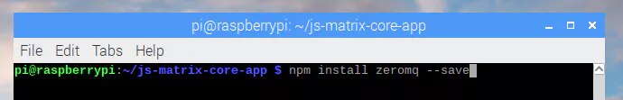

5. Installing npm Packages for ZMQ and Protocol Buffers
To install the ZMQ and MATRIX Protocol Buffers npm packages. Make sure you are in directory which you created above (name you give). Here I gave it js-matrix-core-app. This allows you to interact with Matrix Core through Node.js.
npm install zeromq --save
npm install matrix-protos --save

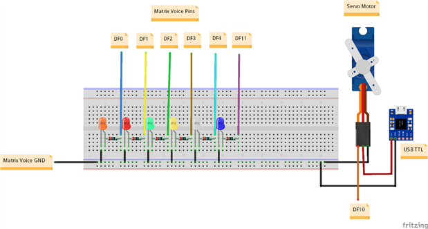

To use PWM for external LEDs and servo motor I am using Matrix lite library.
npm install @matrix-io/matrix-lite --save
Now you are done with Matrix core and Matrix HAL.

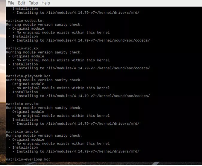

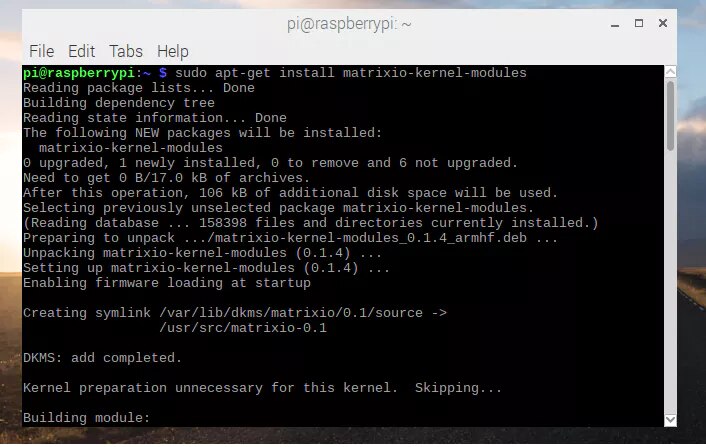

2. To Install the Matrix Kernel modules. Use the command below
sudo apt install matrixio-kernel-modules
This allows the microphones on your matrix device to register as an ALSA microphone on your Raspberry Pi.
sudo reboot

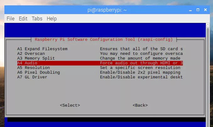

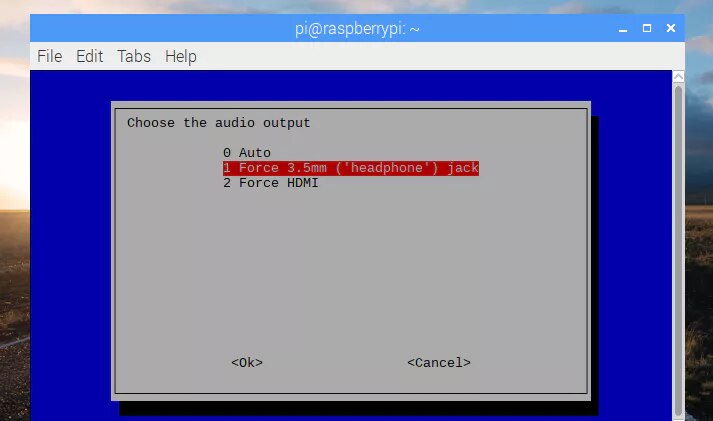

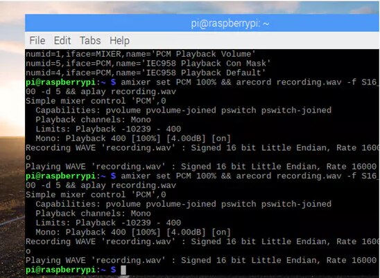

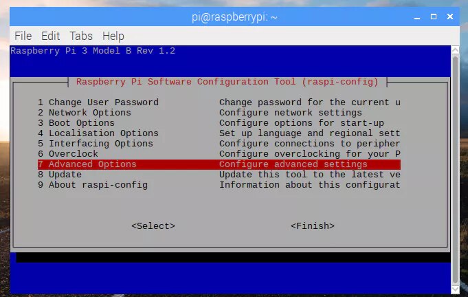

3. Next command will test your microphones by raising your output volume, creating a 5 second long audio recording, and then playing that recording.
Make sure you have select audio jack as output for that
sudo raspi-config
then blue screen appears, go to advanced option then go to audio and select analog jack.
amixer set PCM 100% && arecord recording.wav -f S16_LE -r 16000 -d 5 && aplay recording.wav
If you are able to hear the audio then you are done.

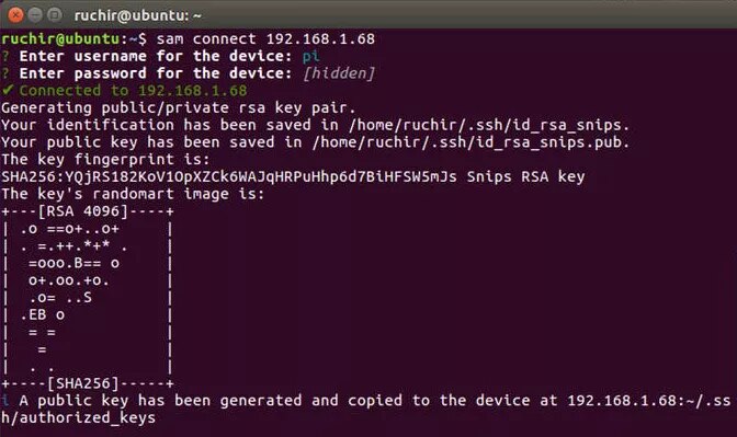

Connect to your Raspberry Pi using command
sam connect ip address of Pi
eg :- sam connect 192.168.1.68
you'll then be prompted to insert a username and password of RPi.

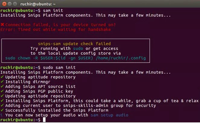

Once you connected use the sudo init command, from your personal computer, to install Snips onto your Raspberry Pi.
sudo sam init

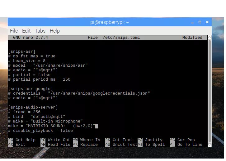

III. Configuring Snips.ai on Raspberry Pi
Now, edit the snips.toml file for configuring the mics on RPi.
Open terminal and use command to open the snips.toml file
sudo nano /etc/snips.toml
You can use any editor to do changes.
Scroll down to where you see [snips-audio-server] and replace
# mike = "Built-in Microphone"
with the following:
mike = "MATRIXIO SOUND: - (hw:2,0)"

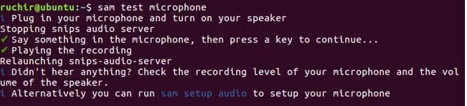

Through your personal computer's terminal, you can use SAM to test the speaker and microphone of your Raspberry Pi.
1. To Test Raspberry Pi's speaker
sam test speaker
2. To Test the microphones on your Matrix device
sam test microphone
If both commands seem to work, you've properly configured Snips.ai on your Raspberry Pi.

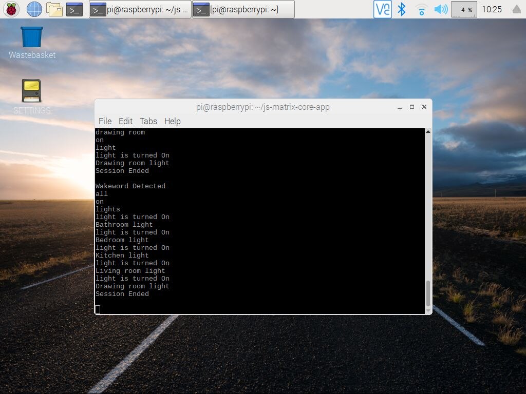

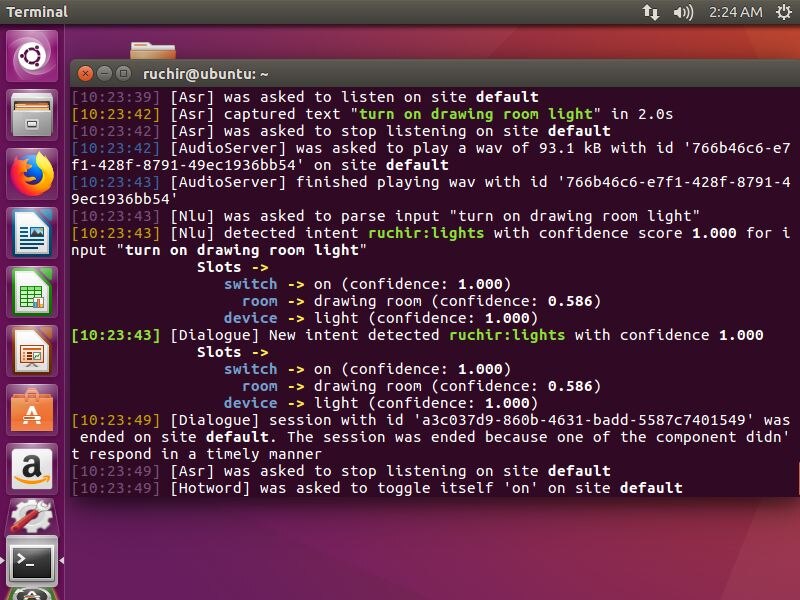

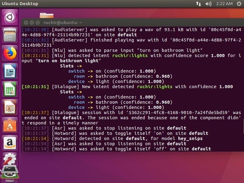

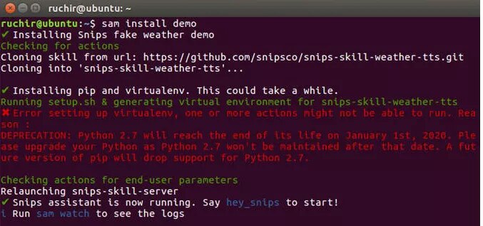

To test Snips.ai is properly working by installing a demo assistant for the weather or not.
sam install demo
After installing as you see snips assistant is running.

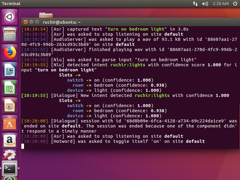

Now, test the assistant by saying
"Hey Snips!" "What will the weather be like in Madagascar in two days?"
The response from Snips should be:
"You asked for the weather in Madagascar in two days."

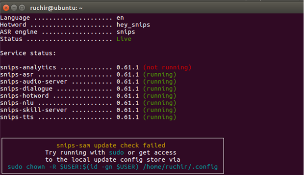

You can test whether all services are running or not using command
sam status
Congratulations we have successfully installed Snips on RPi.

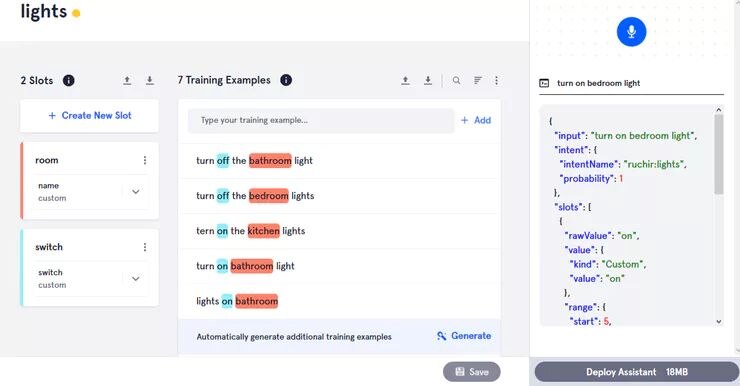

Control lights with Snips.ai

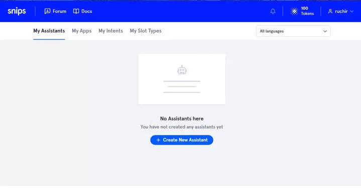

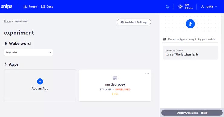

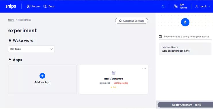

1. Creating a Snips assistant & app
Sign into your Snips.ai and create an assistant. After sign in you page will like this

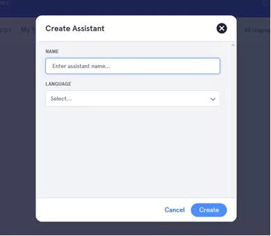

2. Create a new assistant
3. Give name to an assistant, select language and then create it.Once created you will see page like this

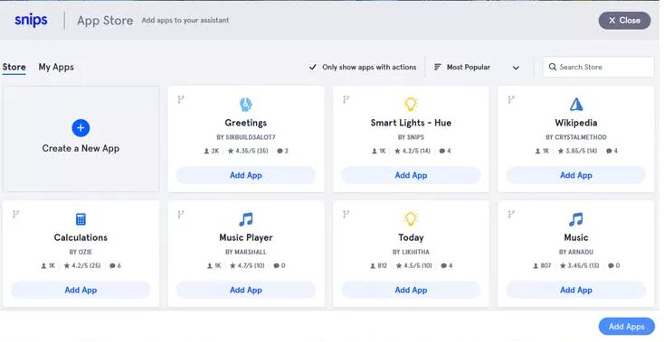

4. Then click on add an app and you will see page like this

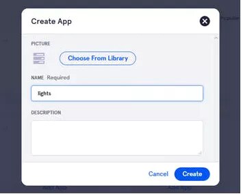

5. Select create a new app and give it a name whatever you want and create it

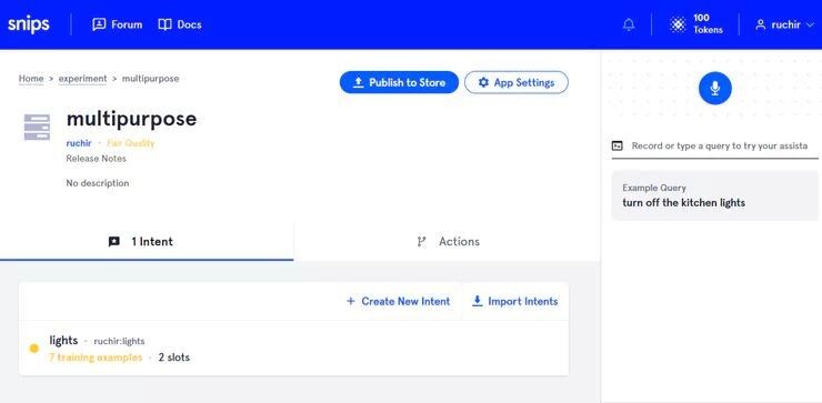

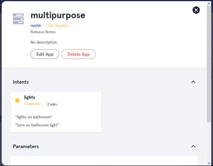

6. After that open the app, click on edit app.

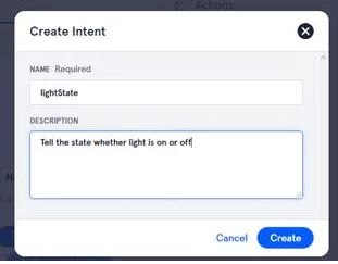

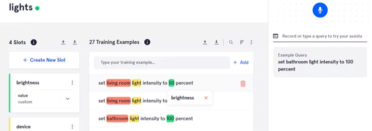

You will see page like this. As you see I already created intent (lights). You will see no intent on your page.

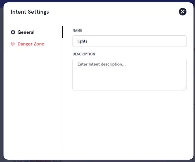

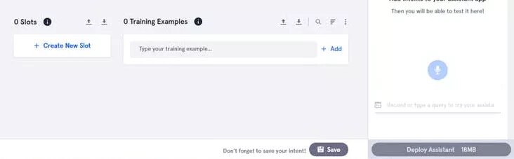

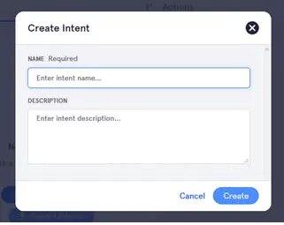

7. Create a new intent
After creating you will see page like this. My intent name is lights

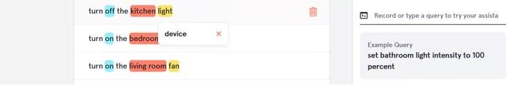

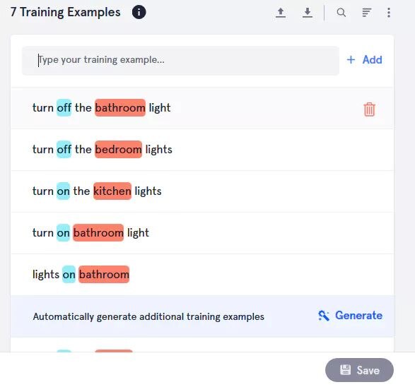

8. Give training examples (you can give training examples after creating slots also).

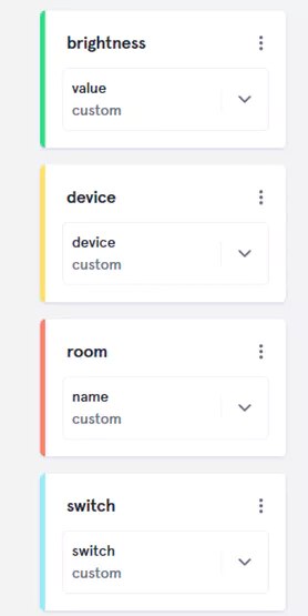

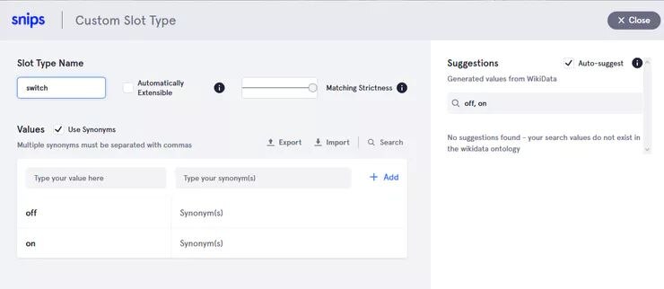

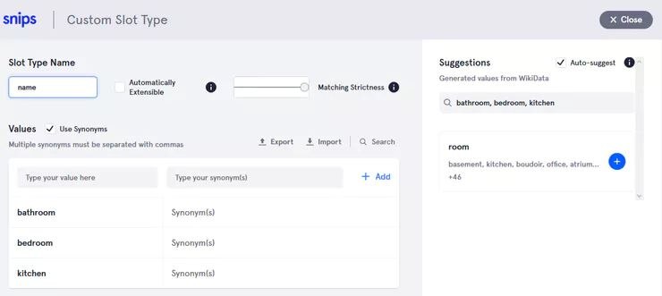

9. Then create a new slots and give it name whatever you want. Here I am using four slots
  • switch for on and off state
  • room for different rooms such as bedroom, bathroom etc
  • device for devices such as light, fan etc
  • brightness for setting brightness of light in different rooms.

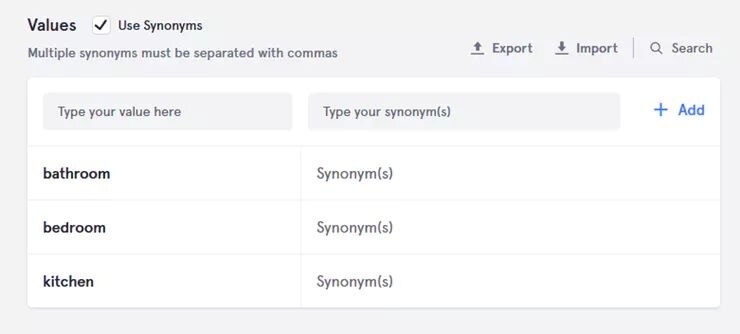

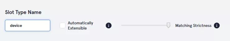

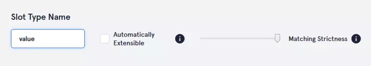

10. Then give slot type name. Here I am building custom slot type.
  • For room slot
After that add slot values "bathroom", "bedroom" and "kitchen".

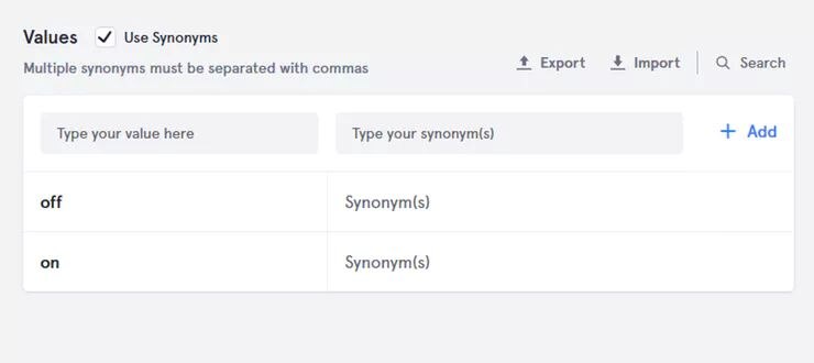

  • For switch slot
After that add slot values "on","off","open", and "close".
  • For device slot

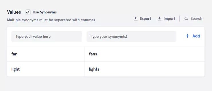

Give any name whatever you want.
After that add slot values such as "light", "fan", and "door".

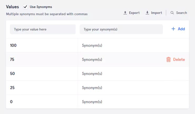

  • For brightness slot
After that add slot values 75, 50, 25, 0

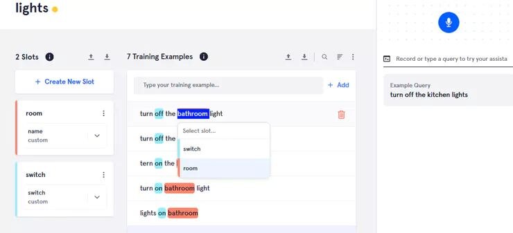

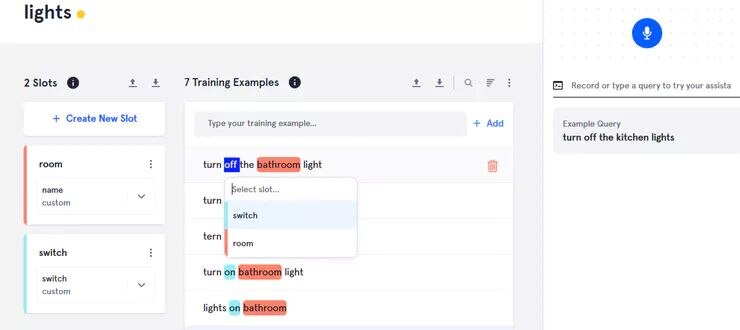

11. Close the app, in order to tell the training example which slot is used, double click on off and on and select slot name(switch).
Double click on room name and select slot name(room).
Double click on light, fan and select slot name(device).
Double click on values(0, 25, 50) and select slot name(brightness).
Then save it and you can test it in window provided right hand side of the page.

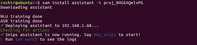

Then deploy it

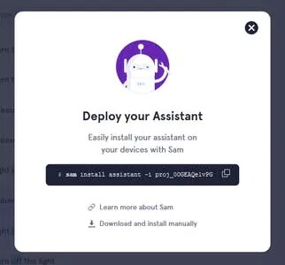

Connect SAM to Raspberry Pi on personal computer
1. From your computer's terminal, sign in through the Sam CLI Tool
sam login
Login using your snips account
2. Connect to your Raspberry Pi. When prompted for a username & password, insert the Raspberry Pi credentials.
sam connect YOUR.PI.IP.HERE

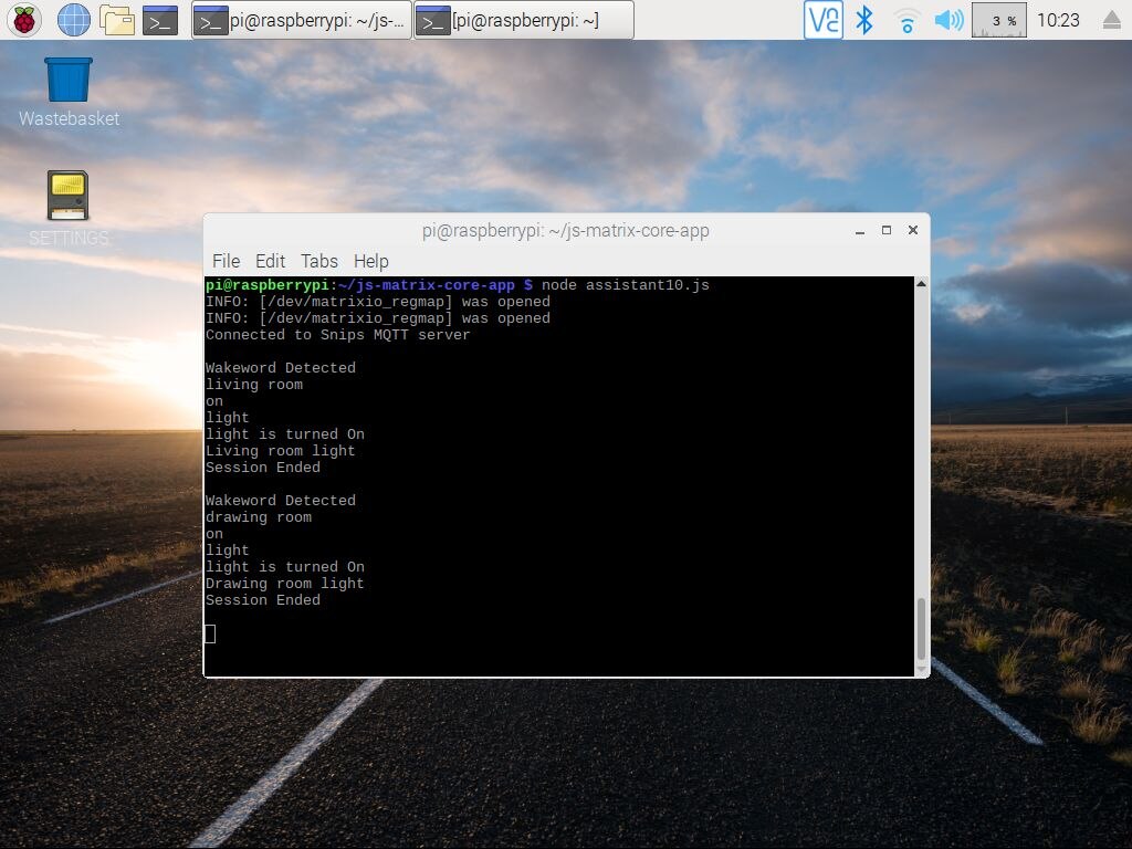

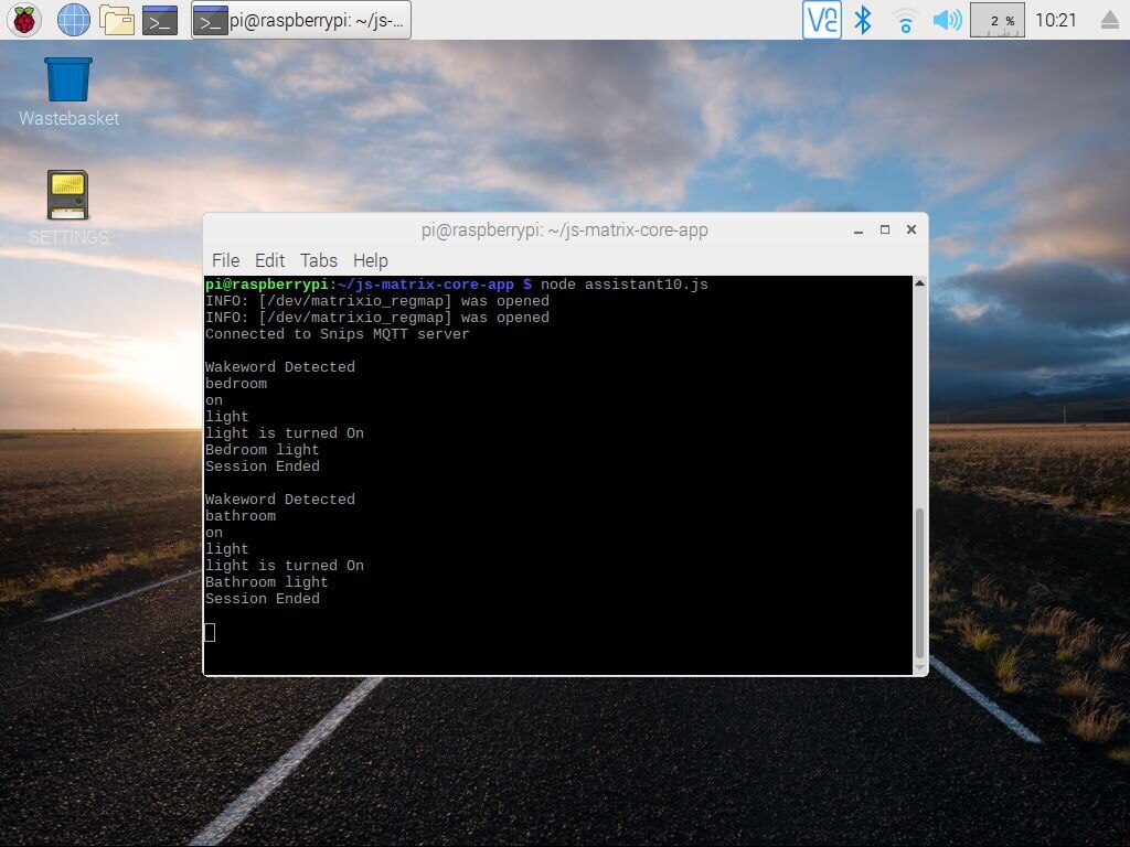

3. Copy the command and paste on your local computer.
After deploying on your Pi you will see like this
Creating Assistant on RPi
Assistant will be used to listen and respond to events from your Snips assistant
1. Go to the directory which we made during JavaScript setup in Matrix core. cd ~/js-matrix-core-app and create 4 new JavaScript files.
touch assistant.js pwm.js everloop.js func.js
2. Install MQTT to listen in on events from Snips.
npm install mqtt --save
3. Open everloop.js using any editorand paste the code given in program. Code is used to control the LEDs on the MATRIX Creator/Voice.
4. Open relay.js using any editor and paste the code given in program. It is used to turn the relay on and off.
5. Open assistant.js using any editor and paste the code given in program. It combines all the code from everloop.js & relay.js to control the everloop and relay switch through voice. It shows you how to listen to lightState intents and read slots.

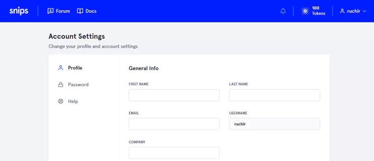

var snipsUserName = 'ruchir'; // username of snips account
var lightState = 'hermes/intent/'+snipsUserName+':lightState'; // name of intent you give while creating an intent
Once done now it is time to check.Open your personal computer(Ubuntu) terminal and run
sam watch
On the other hand, open RPi terminal and go to the directory
cd js-matrix-core-app/
node assistant.js  // run it
Training examples
turn on bathroom light
turn on the kitchen lights
turn off the bedroom lights
turn on all the light
set bathroom light intensity to 25 percent
set kitchen light intensity to 75 percent
set bedroom light intensity to 50 percent
set bedroom light intensity to 0 percent
open the main hall door
close the main hall door
Webpage
I made a page for showing the logs (room, devices, device state, intensity value and date) and gauge showing current intensity value so that I can know which command I used while talking to the snips. Follow the steps giving below for making a webpage.
Note - You can use either Node server or Apache server.
In this project I am using node server because Apache server is slow and it was not able to update data correctly.
Note - If you use code given in this project make sure your all the data is in cd /var/www/html directory or you can change location in the program.

Login page
For making login page go to the directory cd /var/www/html and make an empty file name index.html. Add program given below

Main page
For making main page go to the directory cd /var/www/html and make an empty file name HA.html(any). Add program given below
(dummy code)
<!DOCTYPE html>
<html lang="en">

For making gauge make a empty file name index.js in cd /var/www/html directory. Program is given below.
function read(){

Connections
Relay ==> Matrix Voice
  • 5V ==> 5V
  • GND ==>GND
  • Signal1 ==> GPIO0 (DF0)
  • Signal2 ==> GPIO1 (DF1)
  • Signal3 ==> GPIO2 (DF2)
  • Signal4 ==> GPIO3 (DF3)
  • Signal5 ==> GPIO5 (DF5)
  • signal6 ==> GPIO11 (DF11)
Servo Motor ==> Matrix Voice
  • 5V  ==> 5V
  • GND ==> GND
  • Signal ==> GPIO10(DF10)

Result

  • ruchir1674
    ruchir1674 over 7 years ago in reply to ipv1 +1
    Hey If snips audio server not running you can use " sudo sam init " in Linux or "sam init" in Windows and then check it. Please note that if you are deploying assistant first time then first deploy demo…

  • ipv1
    ipv1 over 7 years ago in reply to ruchir1674
    I prolly won't be going that route though. Will try some other workaround though and let you know.
  • ruchir1674
    Well, I used Ubuntu 16 for my setup. If you get time try using that and please don't use virtual environment.
  • ipv1
    For the desktop. Yes.
  • ruchir1674
    Thanks ipv1 for letting me know. Are you using Ubuntu 18.04.1 ?
