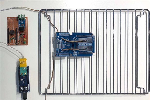

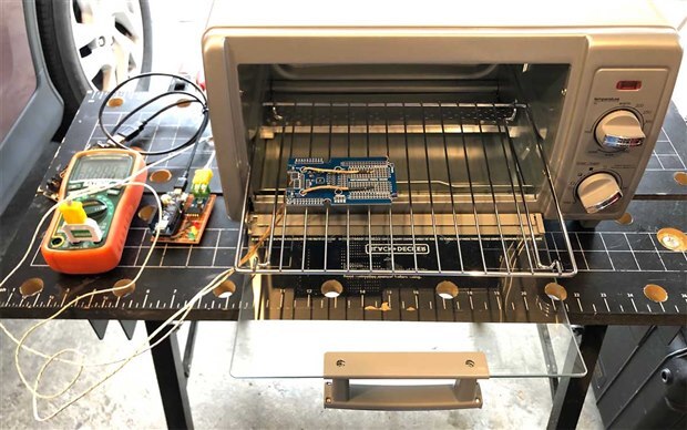

The oven is an inexpensive Black and Decker model placed in the garage as my lab space is limited.  The garage also provides good ventilation.  Two thermocouples are used in the setup - on for direct observation of temperature on the Extech multimeter at left and another attached to the MKR WiFi1010 reflow board which transmits to adafruit.io as described below.  While some drill a hole in the side or top of the oven to insert thermocouples, I just snaked them through the bottom of the door near the hinge with no modification.  The K-type tips were attached to a spare PCB for easy placement and more direct reading of PCB temperature.  Reflow  of the solder is observed through the window on the oven door.

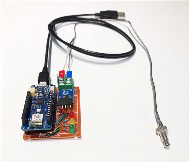

Arduino MKR WiFi 1010 and Thermocouple Amplifier Breakout
A 5x7 cm single sided board was used to make a sturdy home for the Arduino MKR WiFi1010 and the thermocouple amplifier.  Both are attached to female headers for easy removal if desired.  The thermocouple amplifier is an inexpensive MAX6675 ordered sometime back from China (the MAX31855 is an upgraded part also available as a module - or make your own once you have a reflow oven).    Three LEDs were added to make a simple user interface.  The connections to the Arduino are listed in the comments of the firmware given below.  The photo above has a stainless steel braided K-type thermocouple which I felt did not give as good of results as the Extech multimeter (read much lower) so another K-type thermocouple was fitted as shown below to a spare PCB.
This arrangement allows the thermocouple to be closer contact to the PCB which should better reflect the actual temperature of the parts being reflowed.

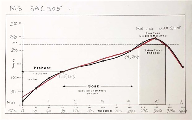

Reflow Temperature Profile
I am using MG Chemicals SAC305 solder, a lead-free paste.  The annotated reflow profile from the datasheet is shown above.  The black line is the recommended profile from MG Chemicals.  Note in the comments that a range of times is allowed as well as a minimum and maximum during reflow and soak.
The red line is a series of straight lines user produced for inclusion in the firmware and meet the requirements of the datasheet.

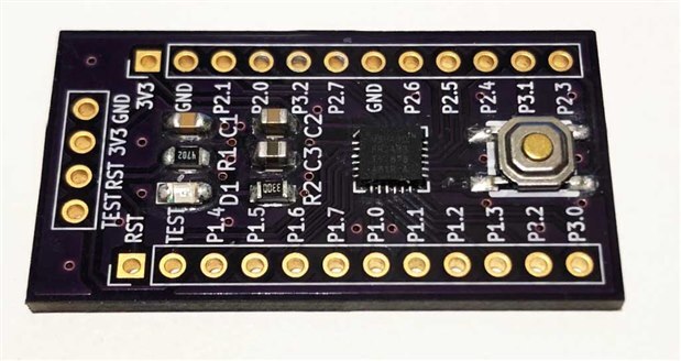

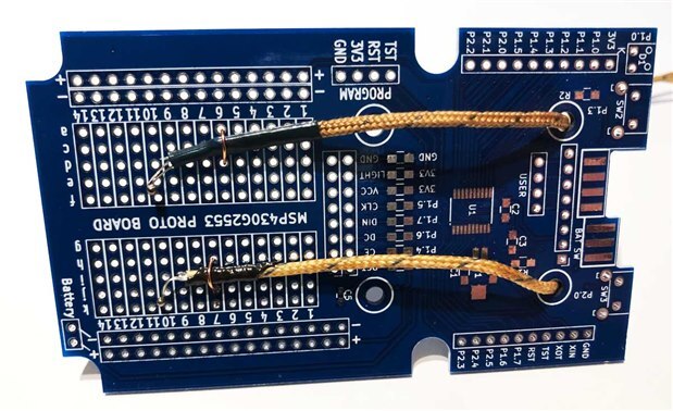

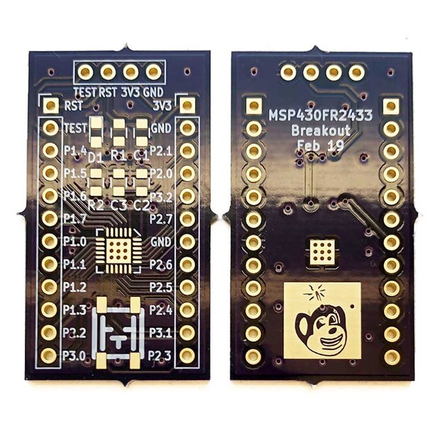

Preparing the PCB
For the first test a modified version of the KiCad designed MSP430FR2433 breakout PCB described here and shown above was used.  I originally had problems soldering the VQFN package by hand but was eventually successful with the hot air gun.  One of the flaws in the PCB design was there were no vias in the copper pad in the center of the package.  For this latest version nine vias were added to the center which connect to the ground plane on the back side.  A cartoon mouse with a thought LED going off was also added because, well just because.  KiCad does not do a designs rule check if graphics are printed on the copper layer so be careful with that....  In this case everything works fine.
The pads were cleaned with alcohol first.  Solder paste was applied with a toothpick since I did not get a stencil made.  Unfortunately there is no photo, but it was a pretty ugly job.  I was careful not to get too much paste on the ground pad of the MSP430 but it is necessary to add paste there in order to get good heat transfer and for mechanical strength.  The PCBs were made by OSH Park and there is solder resist between VQFN package pins and ground - some board houses, including the inexpensive one I typically use in China, will not meet the specification required for solder resist this tight unless additional money is paid.
Using the Reflow Oven
The procedure for using the oven and the user interface are simple.  To start the reflow, give power to the MKR WiFi1010 and turn the toaster oven to about 30 deg. F   300 deg. F (the controls on my oven are in Fahrenheit.  You will have to experiment with your particular oven - temperature control on mine was not that accurate - another approach is to turn the oven all the way on and then manually off before it hits the desired temperature).  The green LED will flicker every 5 seconds as a message is sent to adafruit.io. The primary use of the LEDs is to indicate which phase the reflow oven is in as shown in the table below:
LED status Phase Oven Control
Green flickers, Yellow on, Red off Preheat / Soak 300 deg. F
Green flickers, Yellow on, Red on Reflow Turn all the way up but don't exceed 245 deg. C - watch for reflow
Green flicker, Yellow off, Red off Cool Turn it off and open the door

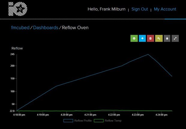

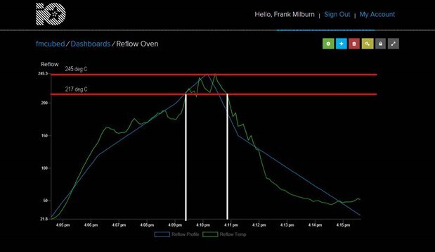

Above is the adafruit.io dashboard from the very first attempt to use the reflow oven with some added annotation.
  • Blue line is the target reflow profile
  • Green line is actual reflow
  • Red lines were added and are the temperature limits for the reflow stage
  • White lines were added and is the time it was in the reflow stage
The soak temperature is not critical and both time and temperature are acceptable.  With the exception of one 5 second interval near the beginning of the reflow where temperature dropped a tiny bit below the desired level it is OK.  The length of time is longer than the profile in the firmware (as I was not watching closely) but within the datasheet specification.  Given that it is a bit longer, the temperature anomaly mentioned is also OK.  All in all, not bad with opportunity to improve with experience.
Results
Whoops, got a bit too much solder on some of those pads but not bad for the first attempt without a stencil.  I did have to remove a short bridge on one side of the VQFN but it cleaned very easily in one pass.  But does it work?  First time!  Below is a video recap and the new board blinking hello world:
I am pleased with the way this turned out and it was relatively quick and easy.  Regarding improvements, adding a buzzer when reflow zones change would be good.   I have some experience with process control and could add PID control using a relay.  But given the small number of SMD PCBs I solder it probably would not be worth the effort.
