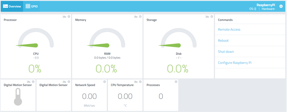

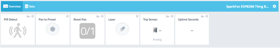

Here's an example of a dashboard that I had used for an ESP8266:
and one I used for a Raspberry Pi:

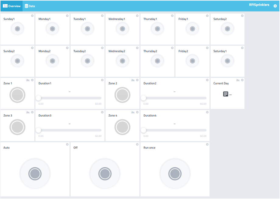

When I went to implement the dashboard for the tkinter interface I discovered a few issues:
  1. I can't shrink the widget size down enough to get all the controls to fit nicely on the dashboard (this will be especially bad in the mobile app as it uses the same layout)
  2. I can't customize the widget icons (there is a small selection of icons but you can't create your own image)
  3. There is no "Text" widget.  This is surprising since it has been on their roadmap since 2017.  Disappointing since I won't be able to report status items like current day.
I'm a bit late in the project to switch horses so I'll do the best I can with what's available.
Here's my first cut at a dashboard:
Not too pretty but it should be functional except not sure what to do about current day reporting.

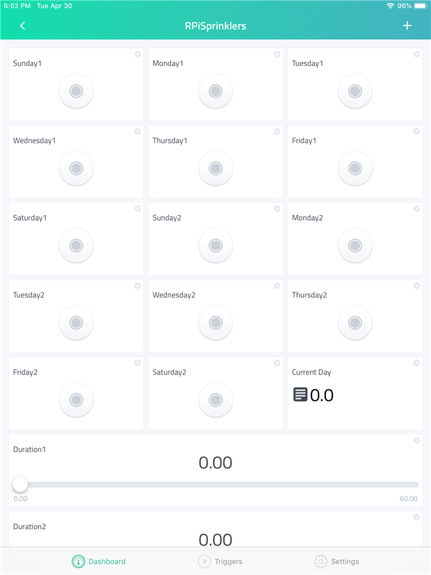

Just a quick note about the mobile app.  Because I can't manipulate the widgets the way that I want, the dashboard will not fit cleanly even on my larger iPad screen.  I've never used the app using MQTT before.  I assumed that the communication between the dashboard and the app would be unchanged.  I noticed that although the widgets are displaying correctly, the app is not updating correctly.  I've decided that I'm not going to try to fix it for now.
Here is what the screen looks like on my iPad.  I can scroll to see all the widgets.
