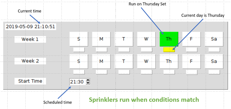

This will be my final blog in the IoT: In the Cloud project.  I have finished programming the controller logic and have modified the enclosure to mount the relay module and drilled out the wiring access hole.
Controller Logic
For this first pass I basically replicated the control logic of the mechanical timer that I am replacing and with the Cayenne dashboard I can update it remotely.  The sprinkler schedule can be set for a two week period.  The day buttons are selected for each day that the sprinklers should run.  The current day indicator shows which day is active.  The start time indicates when the sprinklers should start and each zone has an independent duration setting.
When the current day is a day with the day button set, the sprinklers will start when the current time matches the scheduled time.  The zones run in sequence starting with zone 1.

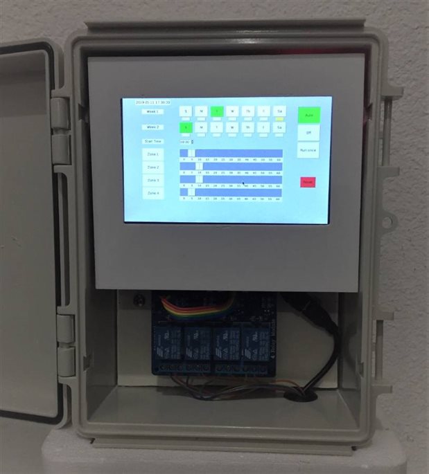

Enclosure modification
It turns out that I had some bad luck and wasn't quite able to finish.  I've been having some issues on and off with the hotend on my 3D printer and as Murphy would have it, the unit wasn't functioning when I tried to print the base for my relay module.  After a couple hours of troubleshooting I figured out that my nozzle is blocked.  I don't think there is an easy fix other than getting another nozzle.  So, I had to resort to a mock up using foam core board.
Here is a picture of the assembled enclosure:
I am not going to mount the enclosure until I fix my printer and print the relay baseplate.

    Your panel has a real professional look to it and the project is coming along nicely.
    Kind regards.
