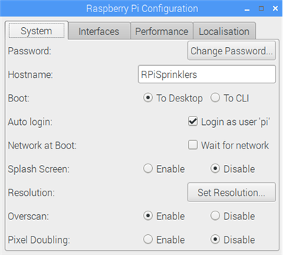

  1. Clean install of Raspbian (2018-11-13) on 16GB microSD card
  2. Set localisation parameters and timezone
  3. Change Hostname ("RPiSprinklers")
  4. Set static ipaddr for wlan0

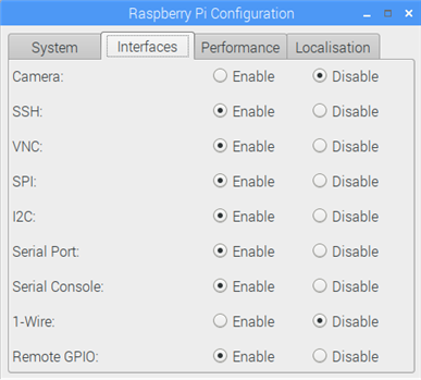

  5. Enable interfaces (SSH,VNC,SPI,I2C)
  6. Change user pi password
  7. Check for software updates
I think the process of RPi configuration is well documented so I won't rehash it here.  I enabled SSH so I could operate the system remotely (I use Putty on a Win10 PC).  I enabled VNC so that I could do the GUI development remotely.  I'll disable the Desktop in actual use.  I'll boot into the Sprinkler Control GUI.

There was one glitch in the process.  The installation script tries to verify that it is running on an RPi before it installs the touch interface files.  It does that by checking for the Hostname "raspberrypi".  Of course, I had changed it to "RPiSprinklers" so the script just changed the display resolution and rebooted without installing the touch interface.  I edited the script to look for my hostname and everything installed correctly.

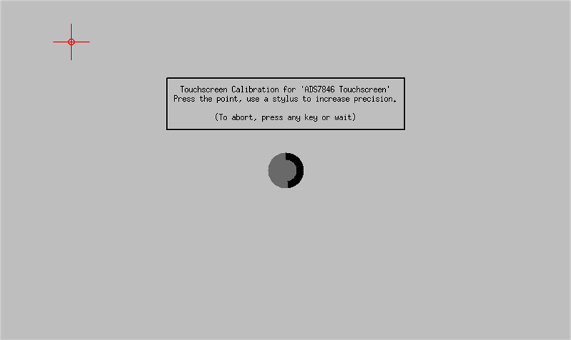

Installing the touch calibration program requires an additional step.  The install script has already been downloaded into the LCD-show directory, you just need to execute it.
sudo dpkg -i -B xinput-calibrator_0.7.5-1_armhf.deb

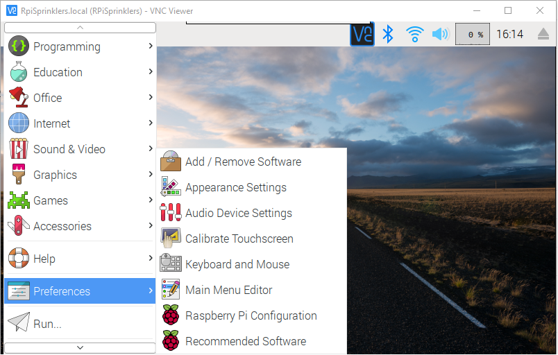

After that you can run it in the terminal window
DISPLAY=:0.0 xinput_calibrator
It will now also show up in the Preferences Menu.
The calibration just uses 4 points and requires that you use the stylus provided for best accuracy.  First point is shown.

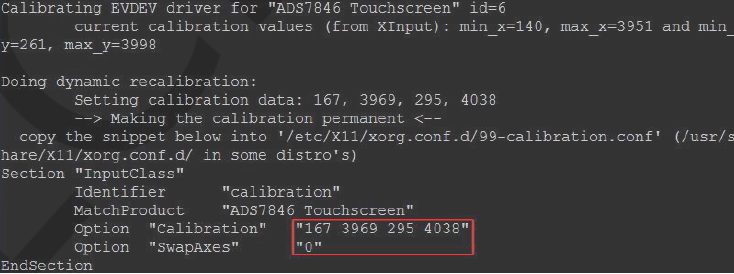

After calibration you need to manually add the calibration data into the file: "/etc/X11/xorg.conf.d/99-calibration.conf"
