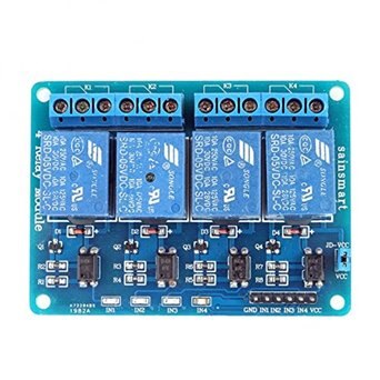

Relay Module
https://www.amazon.com/SainSmart-101-70-101-4-Channel-Relay-Module/dp/B0057OC5O8/ref=pd_sim_107_3/138-3958649-9697036?_encoding=UTF8&pd_rd_i=B0057OC5O8&pd_rd_r=3957246e-4989-11e9-bf30-a9c66916e9f7&pd_rd_w=q0Tfq&pd_rd_wg=pggGD&pf_rd_p=90485860-83e9-4fd9-b838-b28a9b7fda30&pf_rd_r=7824H4DPTDEJW9QC1QWV&psc=1&refRID=7824H4DPTDEJW9QC1QWV#
5V 4 Channel Relay Module
Contact rating 250VAC@10A
Coil nominal current 71mA
Optocoupler input current 2-3mA
