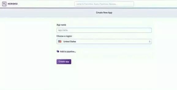

First, go to heroku site create a new account or login there. Link is given: https://www.heroku.com/
Let's start with creating a new app. I have given my app the name "iottempswitch".

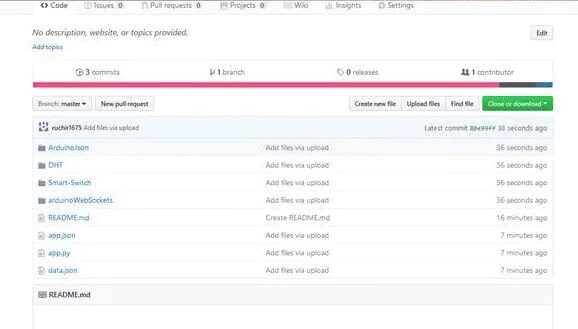

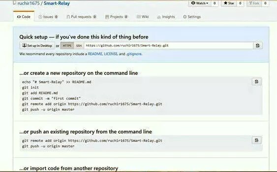

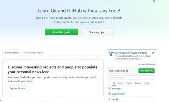

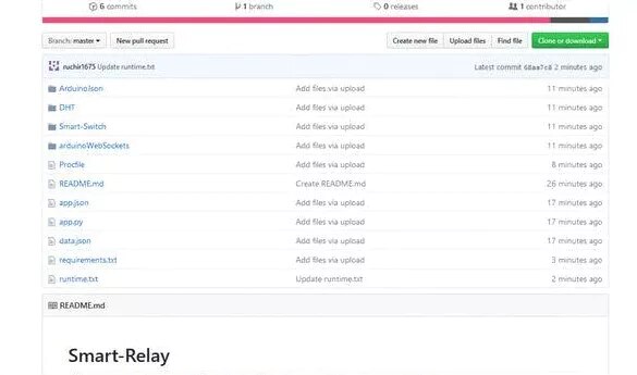

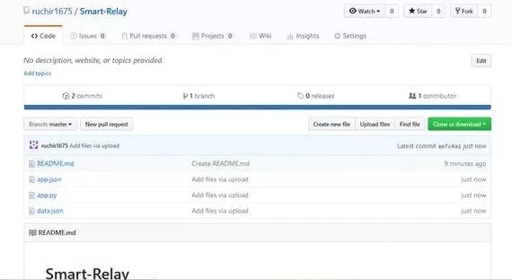

Once the app is made go to GitHub: https://github.com/

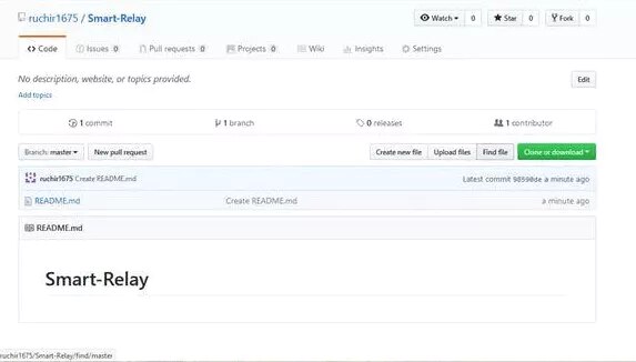

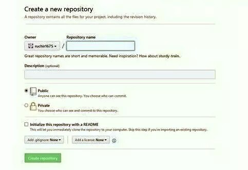

Login there or signup if you do not have an account. Once logged in, create new repository.
Give any name you want to choose and then press create repository. After that you will see page like this

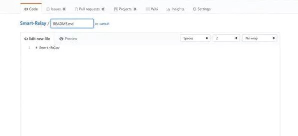

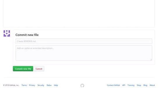

On this page, click on README and you will see page like this.
On this page, give the description you want to share with others. After that, click on commit new file.

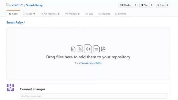

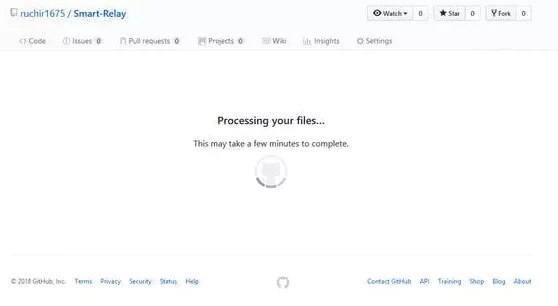

Next, click on upload button. You will see a page like this.
There are two options: either you drag-and-drop the folder or choose the file. Download the required files from below. After selecting the files, press commit changes. You will see page like this.
Once done, it will look like this.
Next we upload three libraries. Click again on the upload file, upload the required files.

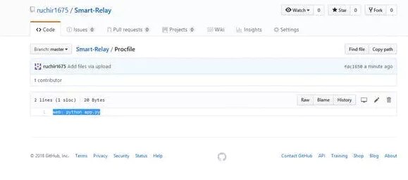

Create a new file, name it Procfile and write web: python app.py. After that commit it.

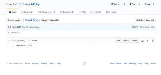

Create a new file, name it requirements.txt and write websockets==3.2.

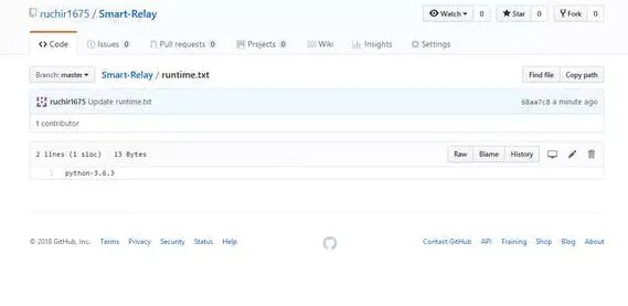

Create new file, name it runtime.txt and write python-3.6.3 or python-3.6.4

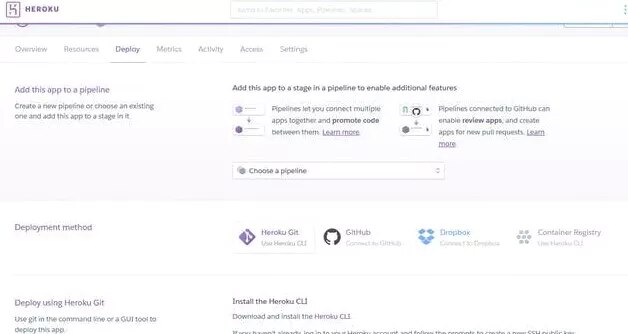

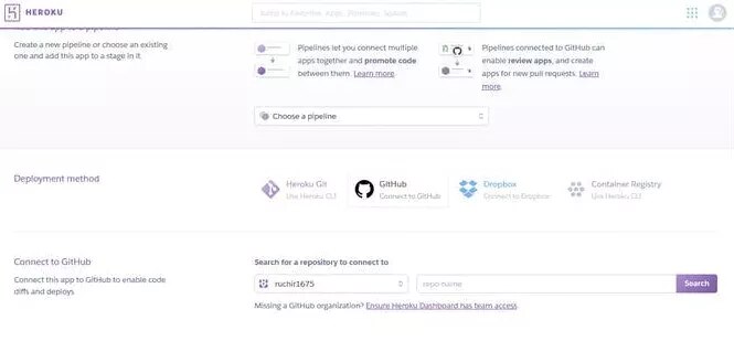

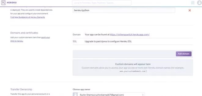

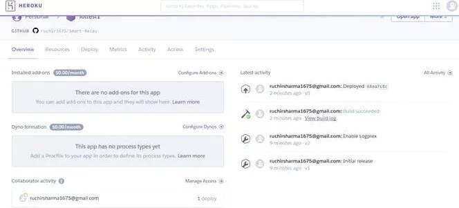

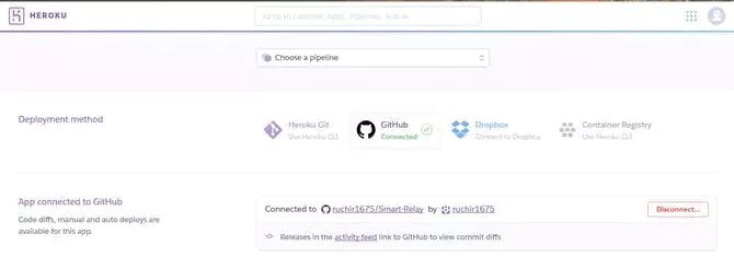

Open app which you created at Heroku then go to deploy section.
Click on GitHub you will see like this.

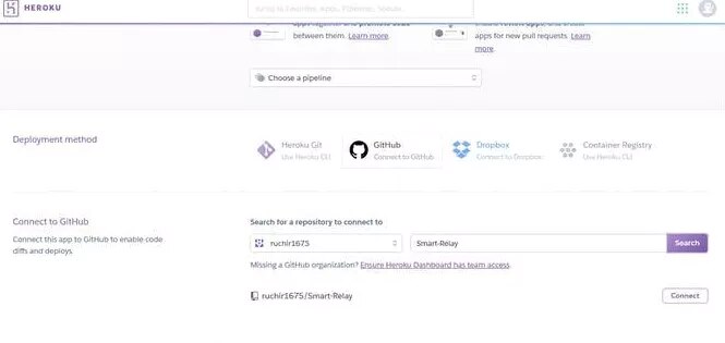

Give repository name which you created at GitHub side. In my case it is Smart-Relay. Copy that and paste it here. You will see like this.
Once your link is shown click on connect. You will see like this.

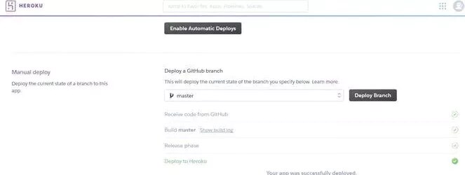

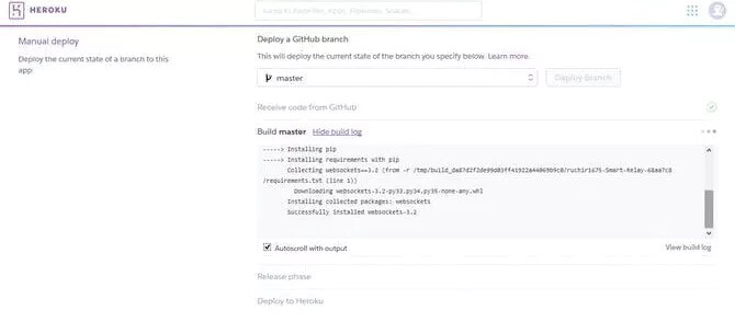

Next, click on deploy branch.
After completing deploy you will see like this.
Now, we have created our app successfully. Go to setting and use this link for Amazon and Arduino program.

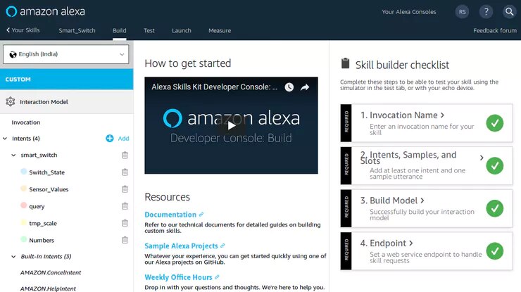

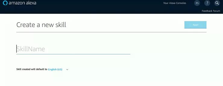

Go to Alexa then select Alexa Skill Kit and then create new skill by clicking on Add new skill. When you add new skill you will see skill information page.
1. Skill Information
We have to provide skill type, language, name.
  • It will ask for skill name and language.
  • Name ==> Select any name.
  • Language ==> Choose according to your region or country.

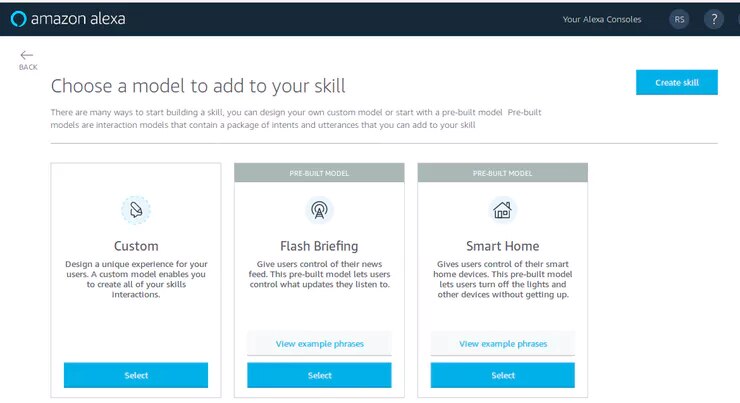

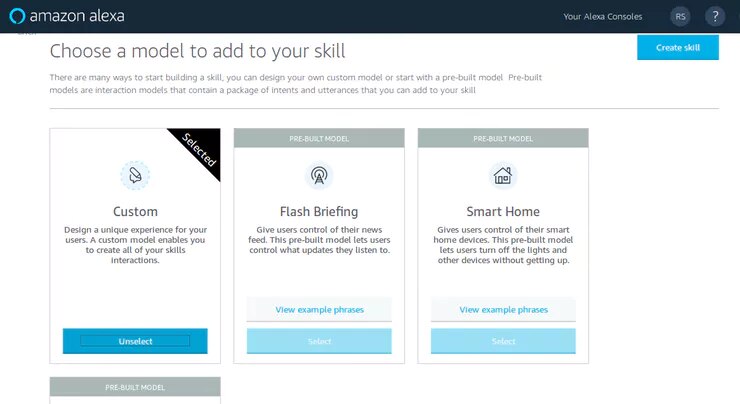

On next page it will ask for skill type, there are three skill type namely custom, flash briefing, smart home.
Skill type ==> select custom.
After that you will see a page like this.

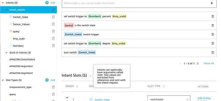

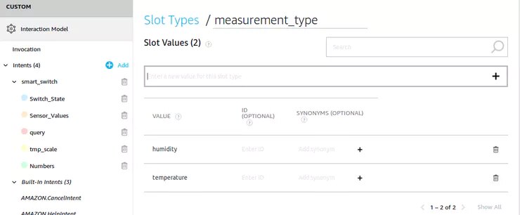

2. Interaction Model

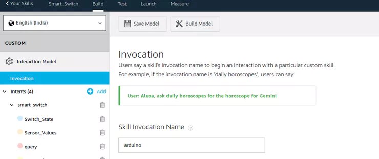

Now invocation name comes under interaction model before it comes under skill information.
  • Go to invocation section and give any you want to use.
  • Invocation name ==> which you use while communicating with Alexa.
For example: Alexa, ask sensor to turn switch trigger on or Alexa, ask light on, here invocation names are sensor and light.

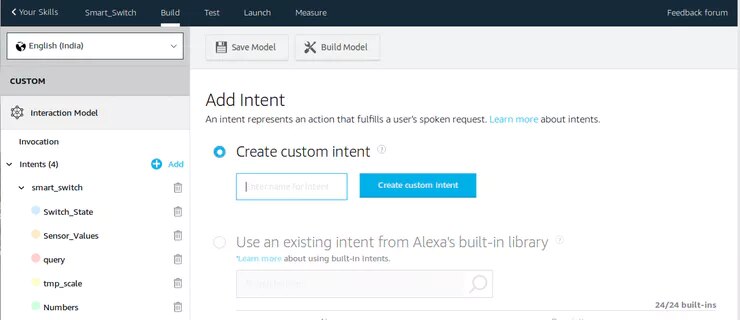

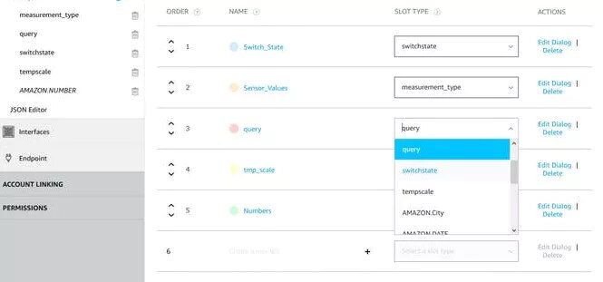

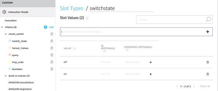

  • Firstly, we create new intents. Click on Add (on left hand side) and give any name you want I used "smartswitch". After that add slots type.
  • Give slot type name "measurement_type" and slot values "temperature" and "humidity".

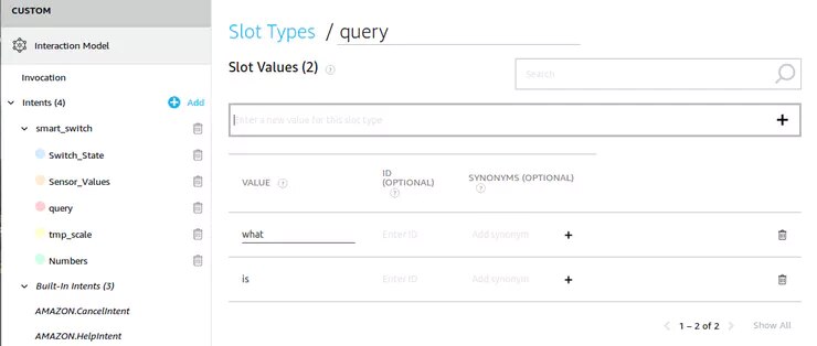

  • After that add slot type name "query" and slot values are "what" and "is". It will look like this.
  • After that add slot type "switchstate" and slot values are "on" and "off".

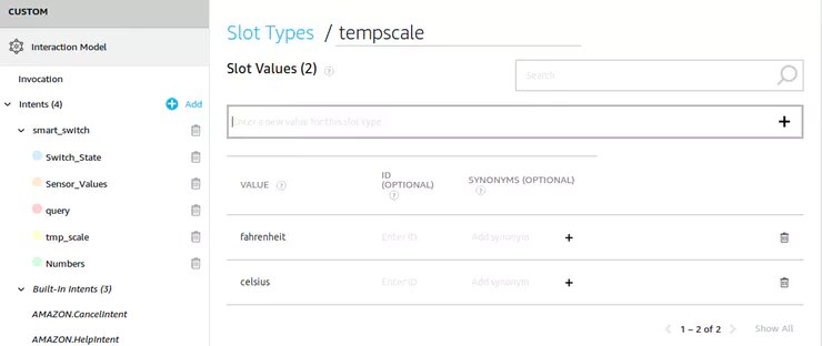

  • Add another slot type "tempscale" and slot values are "fahrenheit" and "celcuis".

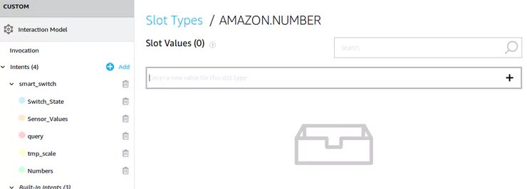

  • After that add new slot type here we use existing slot type for that we have to click on use existing slot.In existing slot search for amazon.number and select this and add it. After adding it you will see it in slot types.

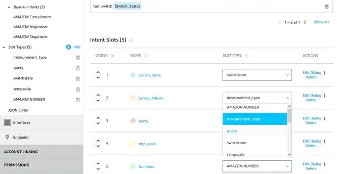

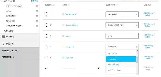

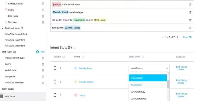

So we are done with slot types; in total, we are using 5 slot types. Now, move to the next step. Click on intent which we created, in my case it is smartswitch. At the bottom you will see intent slot.

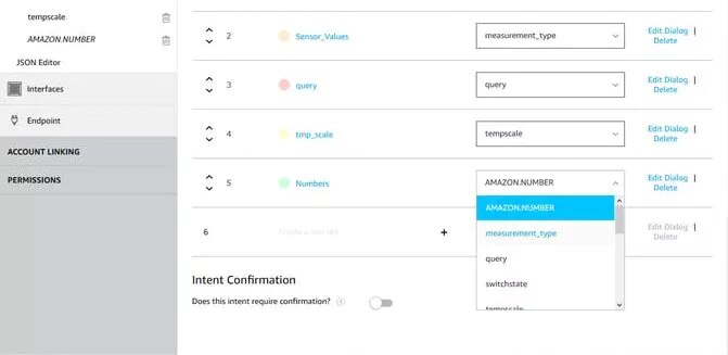

  • Create a new slot, give it name "Switch_State" and map it to "switchstate" by using drop down button.
  • Create new slot, give it name "Sensor_Values" and map it to "measurement_type".
  • Create new slot, give it name "query" and map it to "query".
  • After that create new slot "tmp_scale" and map it to "tempscale".
  • Create new slot "Numbers" and map it to "Amazon.Number".

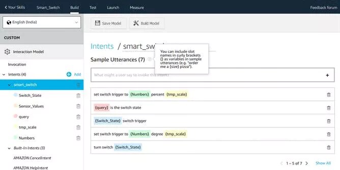

Now we are done with Intent slots. We are using 5 intent slots. After this we move to Sample Utterances.
Add this sample utterances.
set switch trigger to {Numbers} percent {tmp_scale}
{query} is the switch state
{Switch_State} switch trigger
set switch trigger to {Numbers} degree {tmp_scale}
turn switch {Switch_State}
{query} switch {Switch_State}
{query} is the current {Sensor_Values}

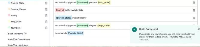

After this save model and build it.
Wait for model to be build after that click on configuration.

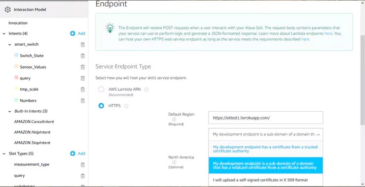

3. Endpoint
Select HTTPS and add link which was generated while creating Heroku app. In my case it is https://iottempswitch.herokuapp.com/. After adding link, for SSL certificate select second option and click on next.
We have successfully created our custom skill.

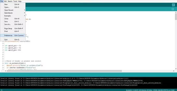

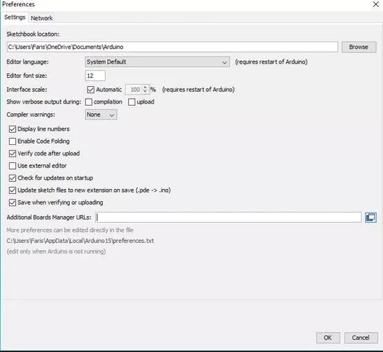

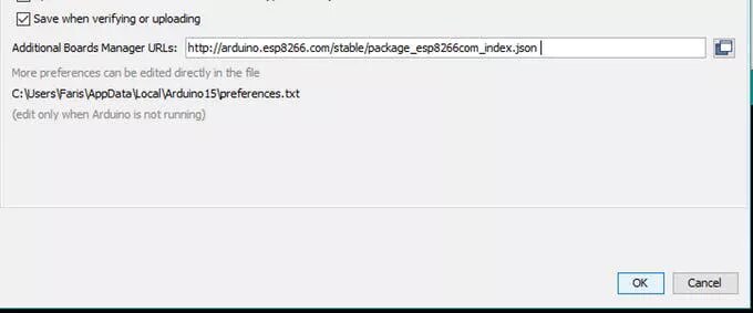

  • Open Arduino IDE.Then go to File ==> Preference.
Step 2

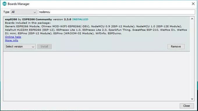

  • In Additional Boards Manager, copy and paste the URL and click ok: http://arduino.esp8266.com/stable/package_esp8266com_index.json

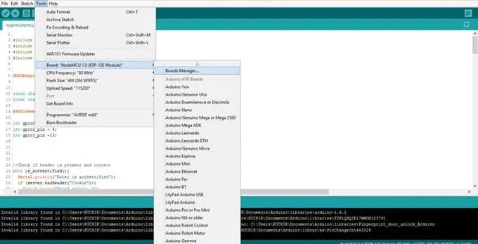

Step 3
  • Open Board Manager by going to Tools ==> Board ==> Board Manager.
Step 4
  • Open Boards Manager and search for nodemcu.
Step 5

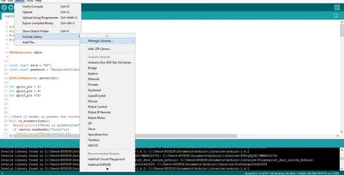

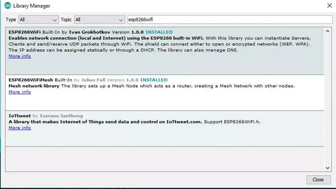

After that download ESP8266WiFi library.
  • Open library Manager : Sketch ==> Include library ==> Manage Libraries.
Step 6
  • Search for ESP8266WiFi library:
Step 7

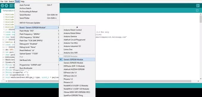

  • Select board ==> Generic ESP8266 Module.

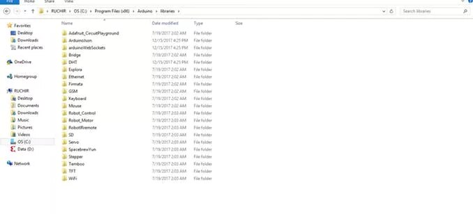

  • Before uploading the code we need three libraries: Libraries
Move these libraries to the libraries folder of Arduino.

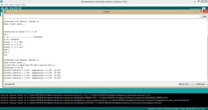

You have to change three things in code SSID, PWD and your heroku app link. After that upload the code. For ESP modules you have to press flash button while uploading the code and then press reset button one time and then release the flash button. After uploading the code, open the terminal. you will see output.

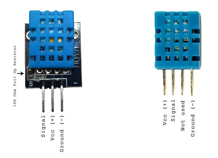

2. DHT temperature sensor
DHT11 is a Humidity and Temperature Sensor, which generates calibrated digital output. DHT11 can be interface with any micro controller like Arduino, Raspberry Pi, etc. and get instantaneous results. DHT11 is a low cost humidity and temperature sensor which provides high reliability and long term stability.

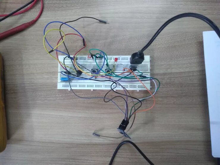

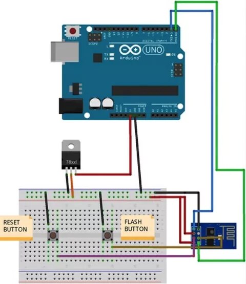

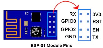

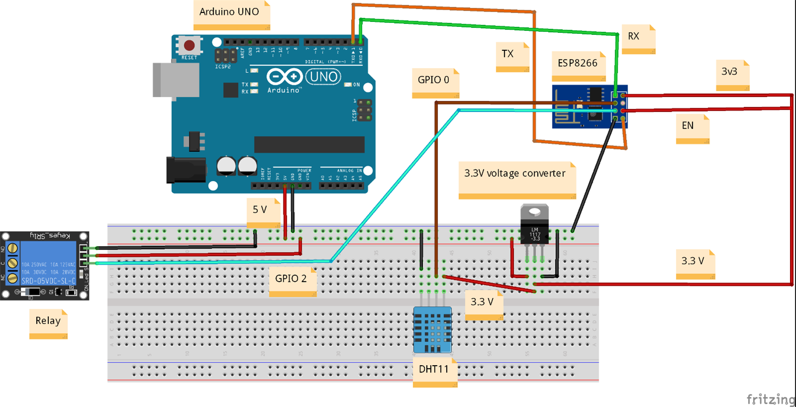

For connecting ESP Module with Arduino UNO we need Lm117 3.3 voltage regulator or any regulator because Arduino is not capable of providing 3.3 v to ESP8266.
Note: While uploading the code press flash button and then press reset button one time and then release flash button.
For connecting DHT11 sensor and relay we use two GPIO pins of ESP8266 Module. After uploading the code you can disconnect the RX, TX, GPIO0 pins.
I have used GPIO0 for DHT11 sensor and GPIO2 for relays. DHT11 sensor works fine with ESP8266 but for relays we need one extra thing, i.e, opto isolator or opto coupler.
5. Connections
ESP8266    === >  DHT11
  • GPIO0 === > Output pin
ESP8266  === >   Relay
  • GPIO2 ===> Input
ARDUINO  ===>  ESP8266
  • Gnd ===> Gnd
  • TX === > TX
  • RX === > RX
  • Reset Button === > RST
  • Flash Button === > GPIO0

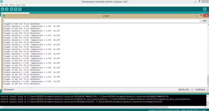

6. After setup all the thing

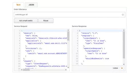

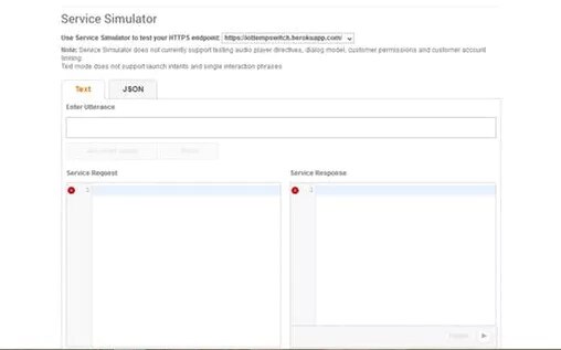

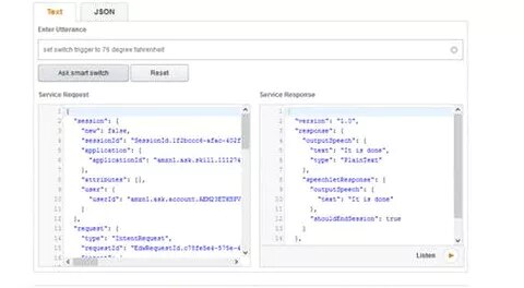

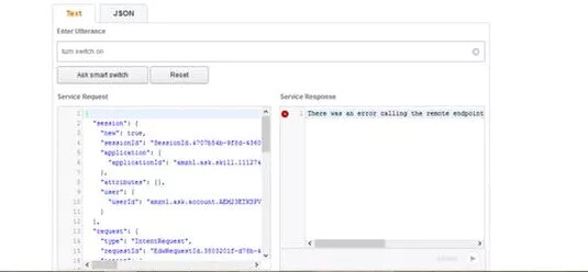

We have successfully created our app, skill and our hardware is ready. So, its time to check. For that your ESP8266 is powered on because our server is running on ESP8266. Here I have not connected any sensor to ESP8266 I am just checking whether its working or not but you can connect sensor, relay to ESP8266. Once it is connected to Heroku you will see connected. For testing go to Amazon skill which you created, then click on test page. Once it is verified its working I will connect my sensor to ESP8266. You can see results as shown below in Result section.
If you use it without connecting ESP8266 you get this error.
Utterance you can use
  • set switch trigger to {Numbers} percent {tmp_scale}
ex. set switch trigger to 50 percent humidity
  • {query} is the switch state
ex. on/off is the switch state
  • {Switch_State} switch trigger
ex. on/off switch trigger
  • set switch trigger to {Numbers} degree {tmp_scale}
ex. set switch trigger to 76 degree fahrenheitex. set switch trigger to 24 degree celcius
  • turn switch {Switch_State}
ex. turn switch on/off

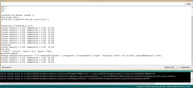

7. While talking to Alexa
  • Alexa, ask arduino to turn switch trigger on/off
  • Alexa, ask arduino to set switch trigger to 24 degree celsius.
  • Alexa, ask arduino to set switch trigger to 50 percent humidity.
  • Alexa, ask arduino to turn switch on/off
File needed for GitHub. Please download from the link given below.
File

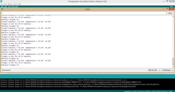

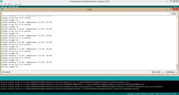

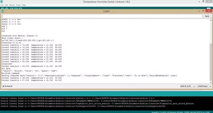

8. Results
Temperature and humidity reading.
Set trigger to 90 percent humidity.
Set trigger for 21 degree Celsius.
1. Set trigger for temperature and humidity
2. Set trigger to 20 degree celsius
3. Set trigger to 80 percent humidity

    Which device are you using ?
  • rosey12
    rosey12 over 7 years ago
    I am also facing this type of error on my device. It is showing Asus error code 55. Do you have any idea how to fix this?
