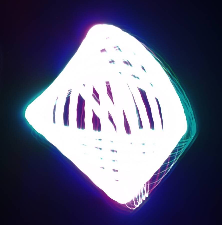

Show
A gallery of some light-painted images created with the machine
{gallery} Light-paint Drawings

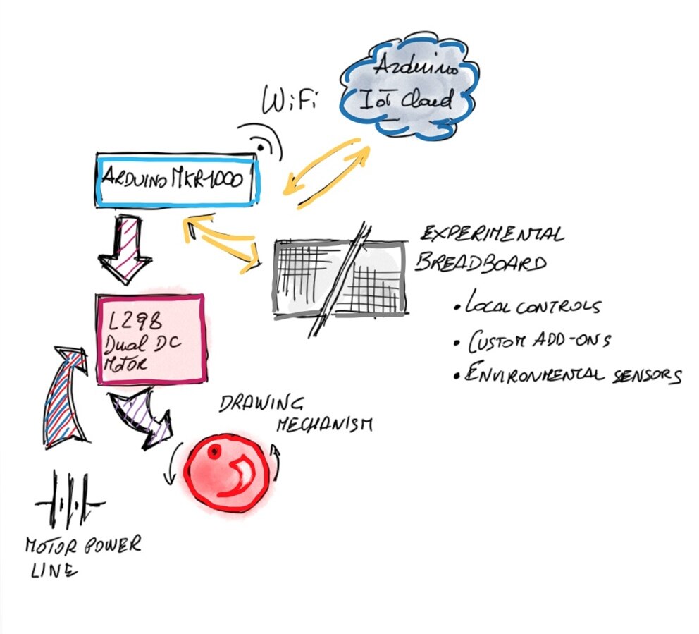

The project aims to continue experimenting with the drawing machine in a wider environment creating an IoT Experimenting Kit accordingly to a number of essential requisites:
  • Controlling the machine from the Web
  • Make the thing Arduino compatible
  • Easy to customize
  • Enabling sensors or other components to change the drawing behavior
  • Finding some original application (appreciated)
Based on these assumptions I figured the design concept like the draft below

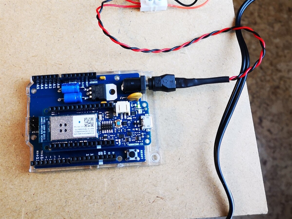

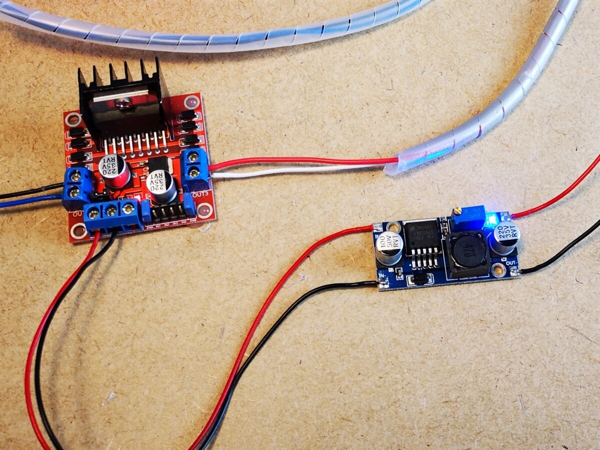

Wiring the Hardware

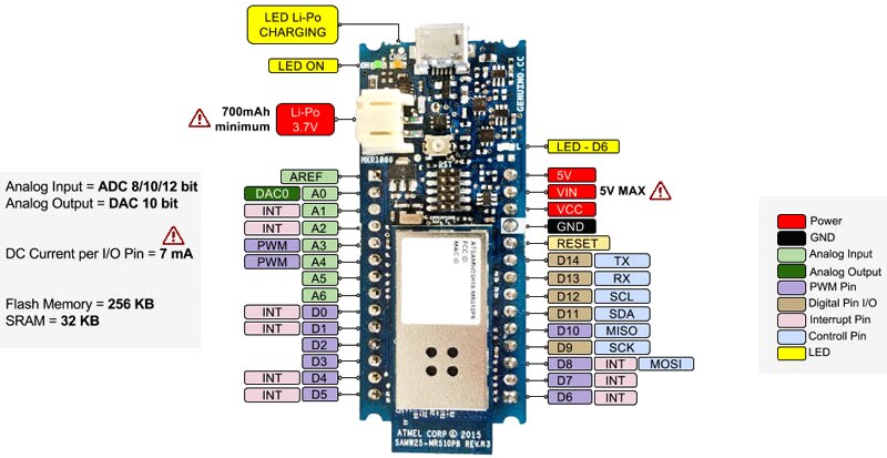

The drawing machine uses a couple of metal geared micro motors, small devices to be powered with 5 V. The main power line comes from a DC wall mount power supply set to 9V (max 2,25 A)  To power properly the two motors controlled by an L298 controller board I have used a cheap DC-DC regulator (I buy them in pack by 10 on Amazon) while the Arduino MKR 1000 is powered by the power-supply plug; in fact, I have used an MKR-Uno board adapter to make easier setting the PIN in the sketch keeping the compatibility with the popular Arduino UNO pinout.
Controlling the Motors With Only Two PWM Signals
The Arduino MKR1000 has six PWM pins on board, but to control the motors two of them are sufficient; to send the High/Low signal to every motor (to set the rotation direction) I have used four non-PWM pins while the PWM outputs are connected to the Enable signal of every motor. This allows controlling both the speed and direction without consuming too many PWM output. I take into account that any update-upgrade of the base design may need some analog and digital GPIO so I tried to optimize as much as possible the signals used by default.
Above: the L298N motor controller board (left) with the power line wired to the DC-DC Voltage Adapter (right)
Before connecting the MKR1000 software to the Arduino IoT Cloud I have tested the system locally, to be sure that everything was working as expected.

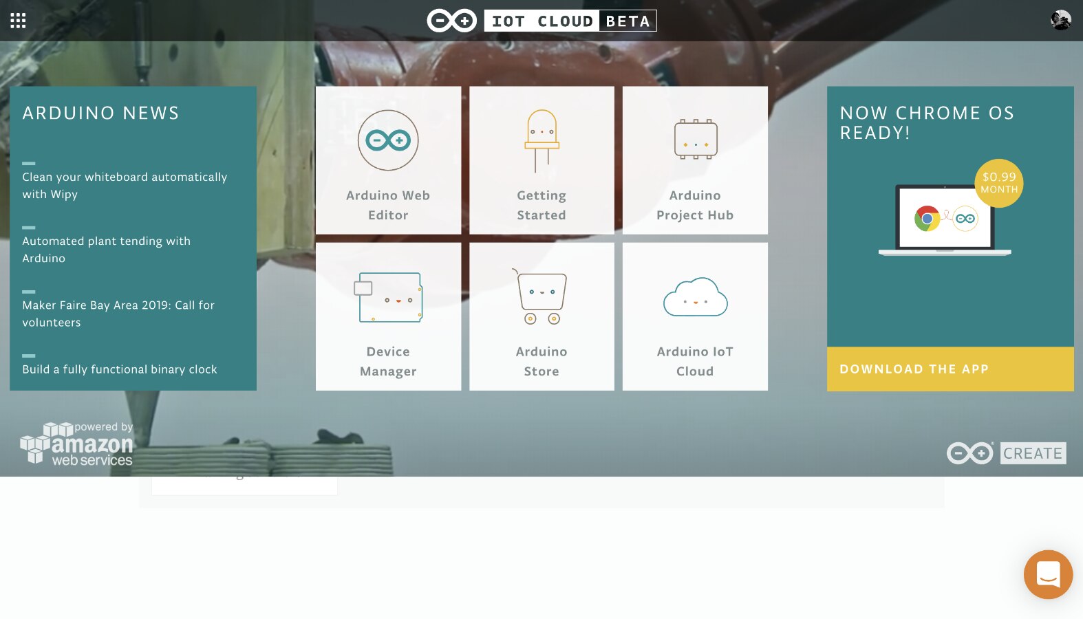

As the MKR1000 is part of the Arduino family and has been recently launched a stable beta of the Arduino IoT cloud I decided to experiment using it.
Registering and Setting Up the Cloud
I have appreciated the documentation and examples accessible from the main page: clear and exhaustive. It is not so usual that a beta version of a web platform includes complete and comprehensive documentation.

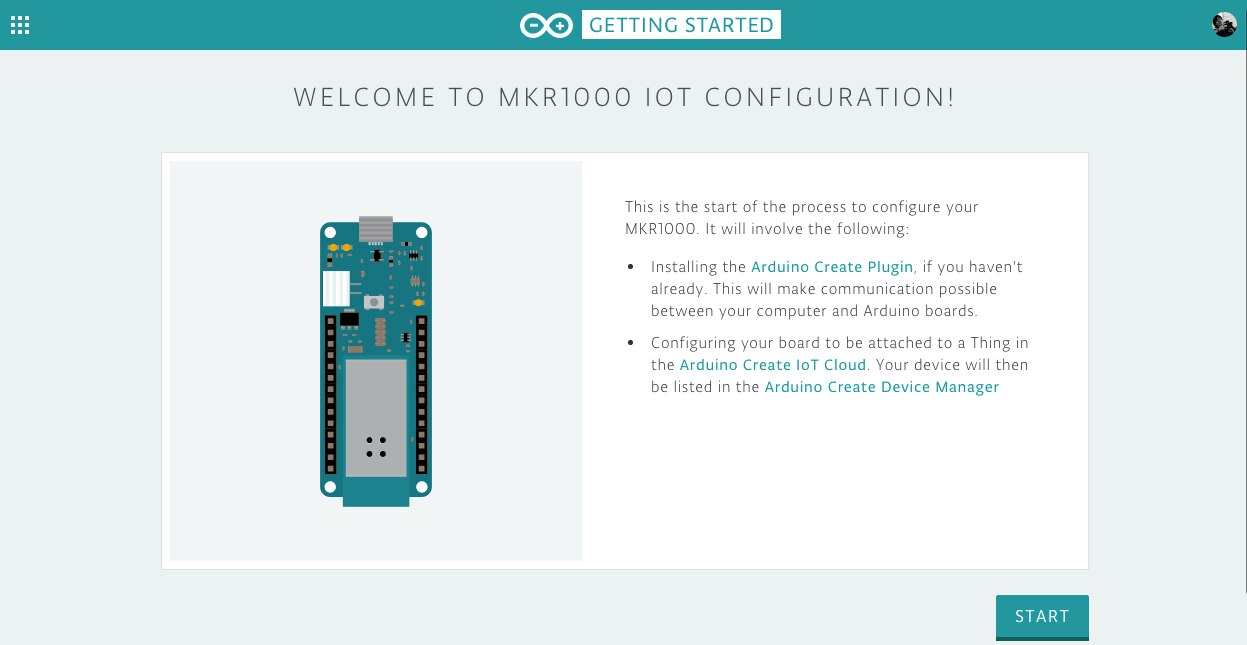

Registering to the cloud, creating the first Thing, adding properties and setting the controls are very easy procedures. A good option for the newbies is to follow the tutorial (strange, it blinks a LED !)
Above: the first step of the registration procedure, configuring the hardware

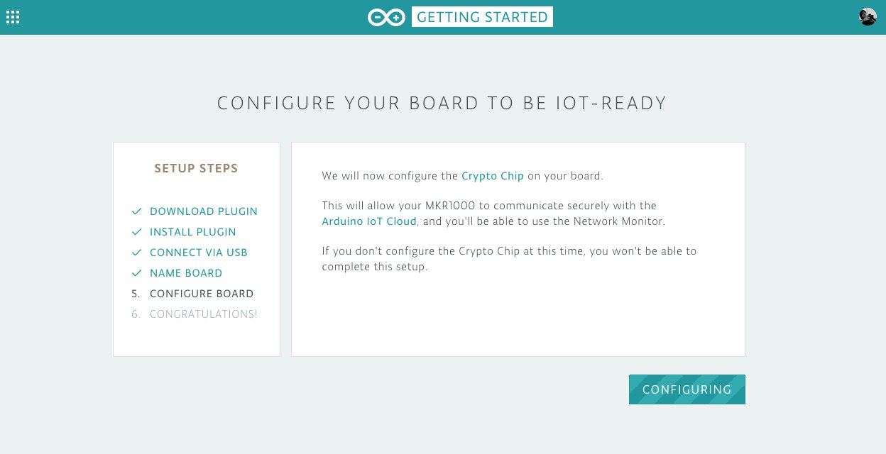

Also, the step-by-step guide to set up the secrets keys and secure access authorization certificates have been simplified as much as possible.
During the creation of the project, the MKR should be connected to the USB of the computer accessing the web platform; when the user reaches the session I am used to be the most complex, the definition of authorization access keys instead is definitely simplified: the remote procedure do all these tasks automatically programming the encryption chip onboard of the MKR device.

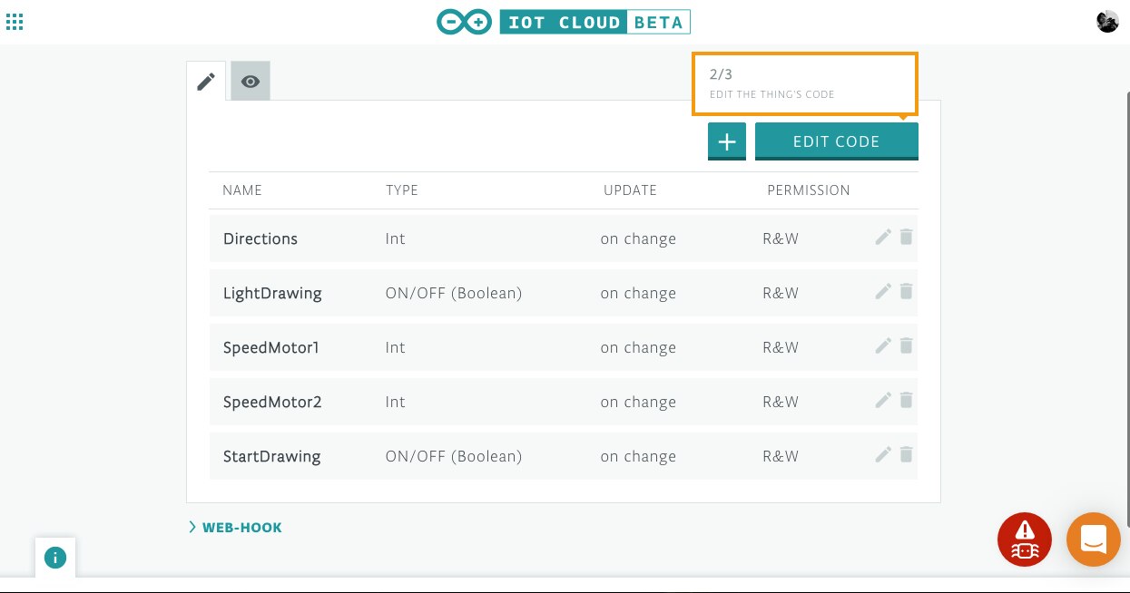

The below image shows the Drawing controls defined in the cloud interface. It is redundant to show the steps to define the controls as the self-explaining process is extremely intuitive.
When the remote system tries to program the Arduino for the first time (including the encryption chip settings), the board should be disconnected by any peripheral, sensor or external component.

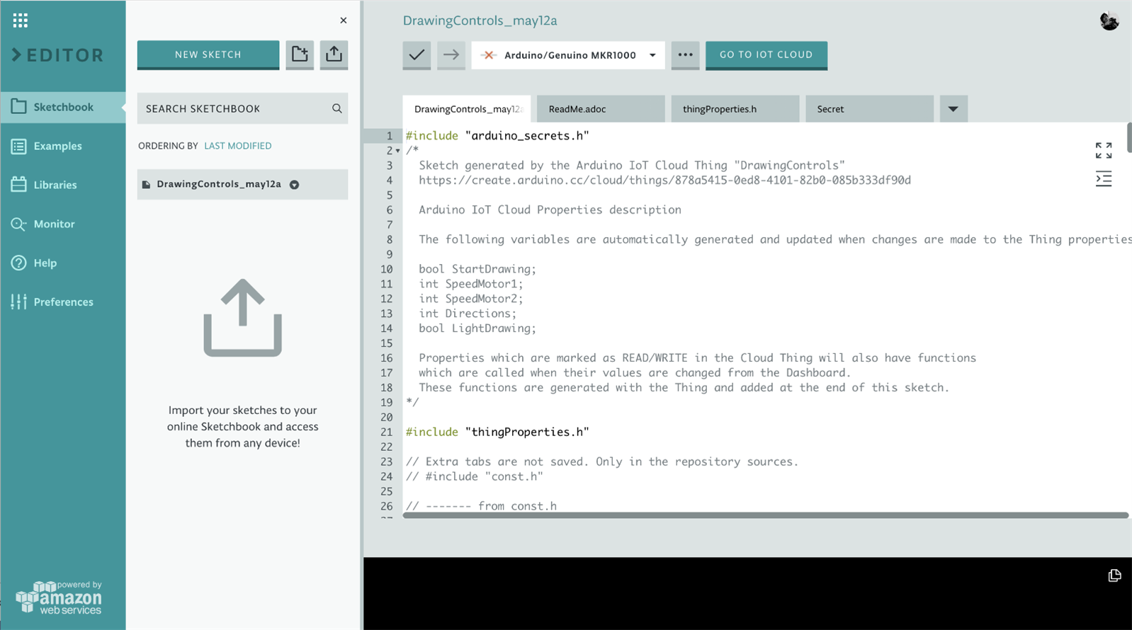

Writing the Software
After the experience of writing the sketch online as the only possible choice to manage the MKR1000 programming, I strongly suggest writing and testing locally the sketch and save if on your PC before proceeding to the next step.
Above: the online code editor of the Arduino IoT Cloud, replicating the features of the popular stand-alone Arduino IDE
With the source functions dedicated to the drawing features optimized and running stand-alone is easy copy-and-paste the sources to complete the online self-generated file provided by the online code editor. The features of the online version of the Arduino editor are very similar to the stand-alone Arduino IDE. Using the Arduino IoT Cloud online editor – at least for this Beta version of the platform – any extra file added to the project (for example a header file defining some constants of the program) is lost after the fins saving operation.

The current beta version of the Arduino IoT Cloud online editor (that must be used to create the code for the platform) does not support extra-files, lost after the sources are saved.
As a best practice, I suggest to include everything in the main sketch (the .ino file).

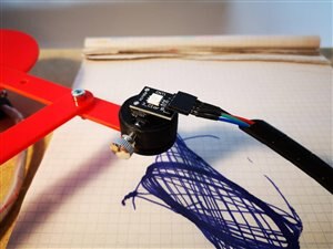

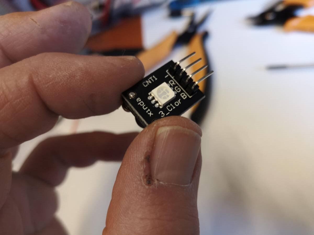

An Add-on to the Drawing Machine

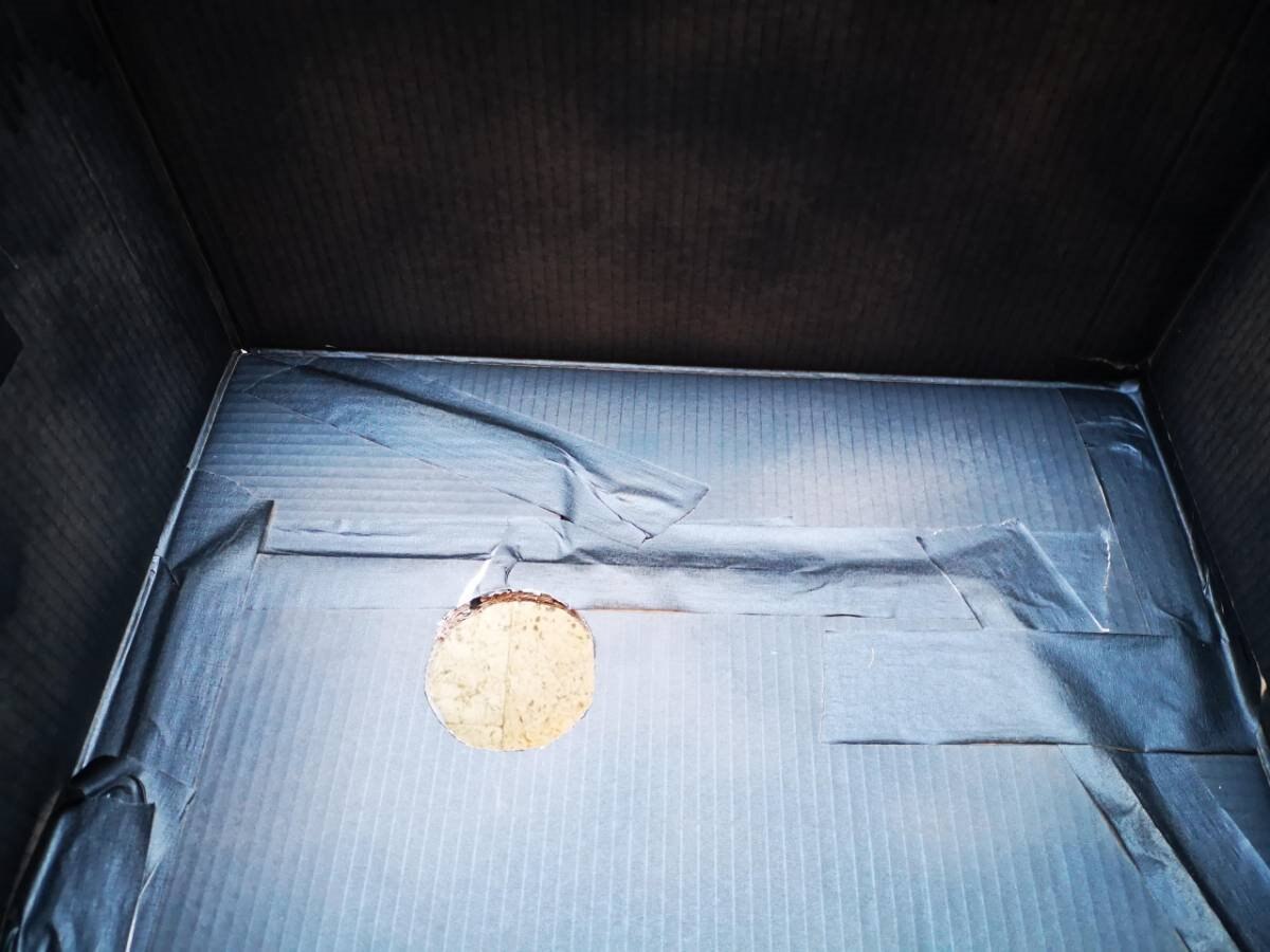

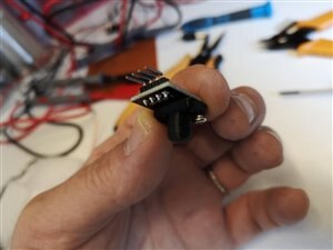

One of the components included in the Elegoo sensor kit is a small PCB with an SMD RGB LED, ready to use; I decided to create a first tool for the Drawing IoT Experimenting Platform: a light-painting device. To fit the LED PCB inside the pen holder I have 3D printed small support (printed in six minutes)  to fix it in place.
With a recyclable cardboard box, I have assembled a small dark room with a hole capable to host both the smartphone (mine has a light paint mode in the camera pp) and my Canon DSLR.
After some experiments, I found the right lighting values with very satisfying results. I should admit that controlling the behavior of the drawing machine from a browser is better and faster than design a hardware interface with buttons, potentiometer sliders, etc.
