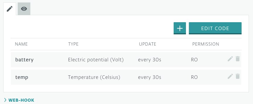

This project synchronizes two variables with the cloud: temp and battery.
The float temp stores the temperature in degrees celcius. The temperature is measured by a DS18B20 one wire sensor. The sensor is connected to digital pin 2 of the arduino. I use the OneWire and DallasTemperature libraries to read out the sensor.
The float battery is the second variable and stores the battery voltage in volts. On the arduino board the battery voltage is connected via a resistor devider to an analog_in pin of the microcontroller and you can simply read it out with the command analogRead(ADC_BATTERY).
The code reads the variables and pushes them to the cloud. Then it waits 10 seconds and starts all over again. For my setup this is not optimal and not very energy efficient but it works at the moment. I will improve this in my next blog post.
Visualization
Now the data of my sensors appears in the Arduino IoT cloud. Unfortunatelly the cloud shows only the last transferred value. For my project I want some data logging as I am very interested in how the temperature and wind speed changes during the day or over several weeks.
Lucky me, Arduino allows to install web hooks which can forward the data to other web services. I decided to use Google Sheets and generate some nice diagrams. There exists also a tutorial which describes that:
https://create.arduino.cc/projecthub/Arduino_Genuino/arduino-iot-cloud-google-sheets-integration-71b6bc?f=1
Unfortunatelly the google code didn't work right out of the box. I had to do some modifications as described in this forum post:
https://forum.arduino.cc/index.php?topic=607020.0
With this modification the script worked fine. At the moment, my variables in the Arduino IoT cloud are set that they update every 30 seconds.
