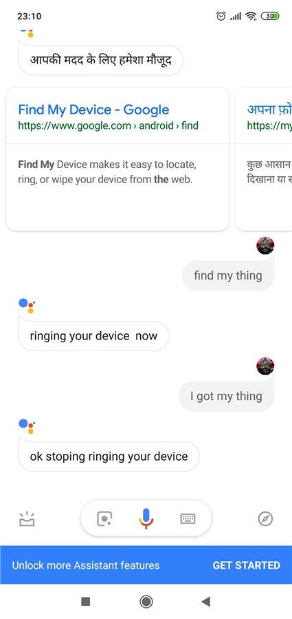

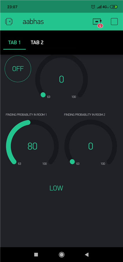

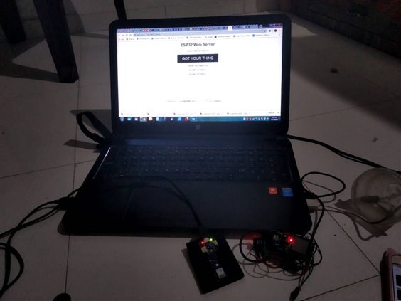

This project is aimed to build a tag for making "Finding Things Easier" and being able to locate misplaced things easily , so this device would enable to find our thing by triggering the buzzer over google assistant or local server and it even gives probability region of the thing making our task easier to find that thing. This would be very helpful for old aged people and people suffering from alzheimer to find their important things which are misplaced just by using the phone to ring the tag and find the thing just like we find our  misplaced phone by giving missed call.

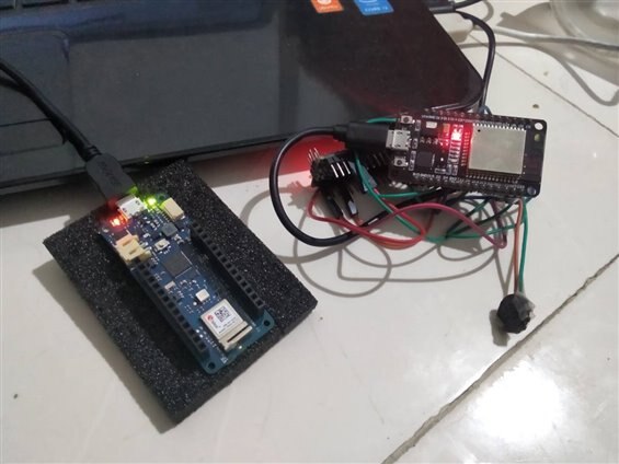

HARDWARE REQUIRED
ESP32(ESP8266 can be used)
MKR WIFI 1010
BUZZER

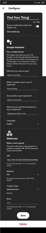

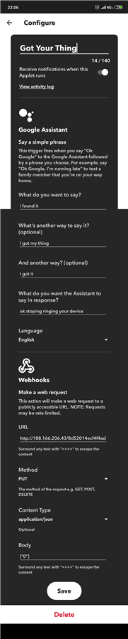

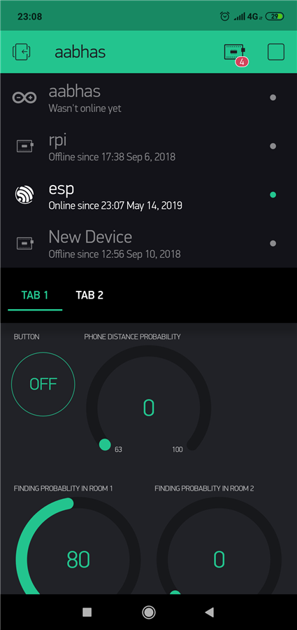

Blynk
IFTTT
SCHEMATIC
There is only two connection that of the buzzer
Buzzer leg 1 - GPIO 26
Buzzer leg 2 - GND

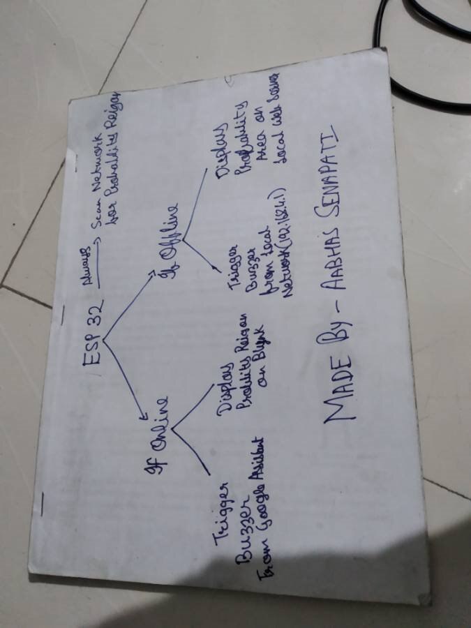

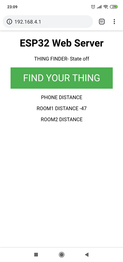

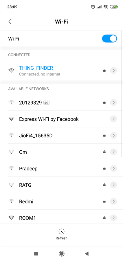

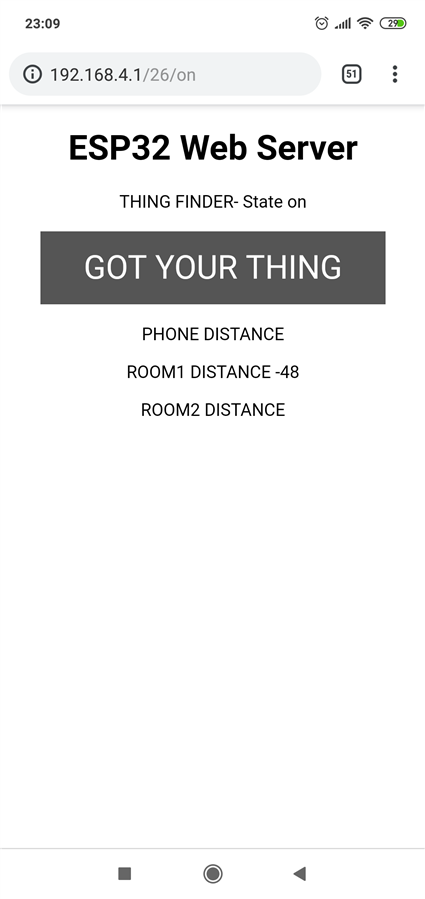

WORKING
This project is made to make finding things easier, it has the esp32 as the tag which has buzzer connected and whenever we have misplaced our thing and we have to find it we can easily find it out by triggering it via google assistant(any voice assistant) or local network , ringing the buzzer would help us to locate the thing by hearing the sound and to make it easier i added feature of probability region which would tell us about the  probability of finding the thing in that region(ie room) and even our phone would give the probability region so we can easily navigate to region near the lost thing . This has the esp32 which connects to the internet if available and can be triggered over google assistant via IFTTT on Blynk cloud and if the internet is not available esp32 creates an access point to which we need to connect and then we can easily trigger it from local ip address( which is 192.168.4.1), the probability region of the device is measured by measuring the signal strength of the nodes and thus giving a probability region for finding our things and this is displayed on Blynk when internet is available and on local server when internet is not available .

    Ya I think I didn't properly elaborate actually I had done everything at very late so i didn't have time to do all this things at the last moment .
    The motto of the project is to create a tag that can be used to find our thing with or without internet by triggering the buzzer via Google Assistant or Local Network along with finding probability of the thing based on its distance using WiFi  signal strength so that we can find out that it might be lying in which room  and it's distance from our phone showing probability ie when distance of tag from our phone or rooms WiFi hotspot  increases then signal strength decreases so does the finding probability decreases .
    Hope that now you are clear with the concept and application of the project.
